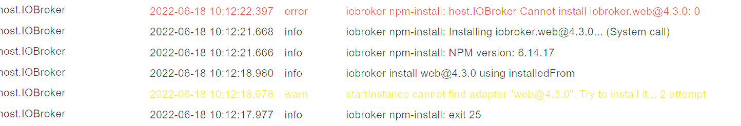

                                Aber es tauchen weiterhin Fehler in der GUI auf, wie z.B.:
                                host.IOBroker
                                2022-06-20 21:59:24.788 info iobroker npm-install: exit 25
                                host.IOBroker
                                2022-06-20 21:59:23.747 error iobroker npm-install: host.IOBroker Cannot install iobroker.flot@1.10.7: 0
                                host.IOBroker
                                2022-06-20 21:59:22.995 info iobroker npm-install: Installing iobroker.flot@1.10.7... (System call)
                                host.IOBroker
                                2022-06-20 21:59:22.994 info iobroker npm-install: NPM version: 6.14.17
                                host.IOBroker
                                2022-06-20 21:59:20.190 info iobroker install flot using installedVersion
                                Eine Idee woran das liegen könnte?

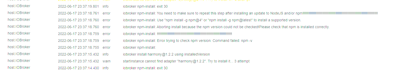

                                      npm8 löst folgendes aus in der GUI
                                      iobroker npm-install: Use "npm install -g npm@4" or "npm install -g npm@latest" to install a supported version.You need to make sure to repeat this step after installing an update to NodeJS and/or npm!!!!!!!!!!!!!!!!!!!!!!!!!!!!!!!!!!!!!!!!!!!!!!!!!!!!!!!!!!!!!!!!!!!!!!!!!
                                      Thomas Braun Homoran 2 Replies Last reply Reply Quote 0
                                        Noch mehr wat?
                                        Was treibst du da bitte?
                                        Bitte die Ausgaben im Terminal zu
                                        uname -m && which nodejs node npm && nodejs -v && node -v && npm -v && whoami && pwd && sudo apt update &> /dev/null && sudo apt update && apt policy nodejs
                                        J 1 Reply Last reply Reply Quote 0
