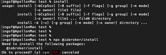

  • AsgothianA Asgothian
    @apollon77
    ae@Grayskin ioBroker % curl -sLf https://iobroker.net/install.sh | bash -
    library: loaded
    Library version=2022-02-10
        Welcome to the ioBroker installer!
        Installer version: 2022-02-13
        You might need to enter your password a couple of times.
        Installing prerequisites (1/4)
    Password:
    sudo: brew: command not found
    Changing npm registry to https://registry.npmjs.org
    Since brew is not installed, frequently-used dependencies could not be installed.
    Before installing some adapters, you might have to install some packages yourself.
    Please check the adapter manuals before installing them.
        Creating ioBroker user and directory (2/4)
    Directory /usr/local/iobroker created
        Installing ioBroker (3/4)
        Finalizing installation (4/4)
    Enabling autostart...
    bash: line 1271: /Users/ae/Library/LaunchAgents/org.ioBroker.LaunchAtLogin.plist: No such file or directory
    Load failed: 5: Input/output error
    Try running `launchctl bootstrap` as root for richer errors.
    Autostart enabled!
    mkdir: /root: Read-only file system
    touch: /root/.bashrc: No such file or directory
        ioBroker was installed successfully
        Open http://192.168.101.101:8081 in a browser and start configuring!
    You need to re-login before doing anything else on the console!
    Anscheinend fehlt ein Verzeichnis bei einem neu installierten macOS 12.5
    A.
    apollon77A Offline
    apollon77A Offline
    apollon77
    wrote on last edited by
    #21
    @asgothian Ok, dann bitte GitHub issue und dann müssen wir neu rausfinden was angepasst werden muss :-( menno ... warum kann es nicht einfach mal tun wenn es tut und die Apple Leute nicht immer Dinge ändern :-)
