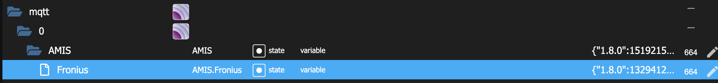

    möchte euch bitten mir da zu helfen.
    Es soll die Verbindung zum Gerät überwacht werden.
    Smart Zähler per Mqtt Verunden, am Stromzähler der PV Anlage.
    {"1.8.0":1329412,"2.8.0":112191923,"3.8.1":1171754,"4.8.1":5825866,"1.7.0":0,"2.7.0":779,"3.7.0":0,"4.7.0":210,"1.128.0":0}

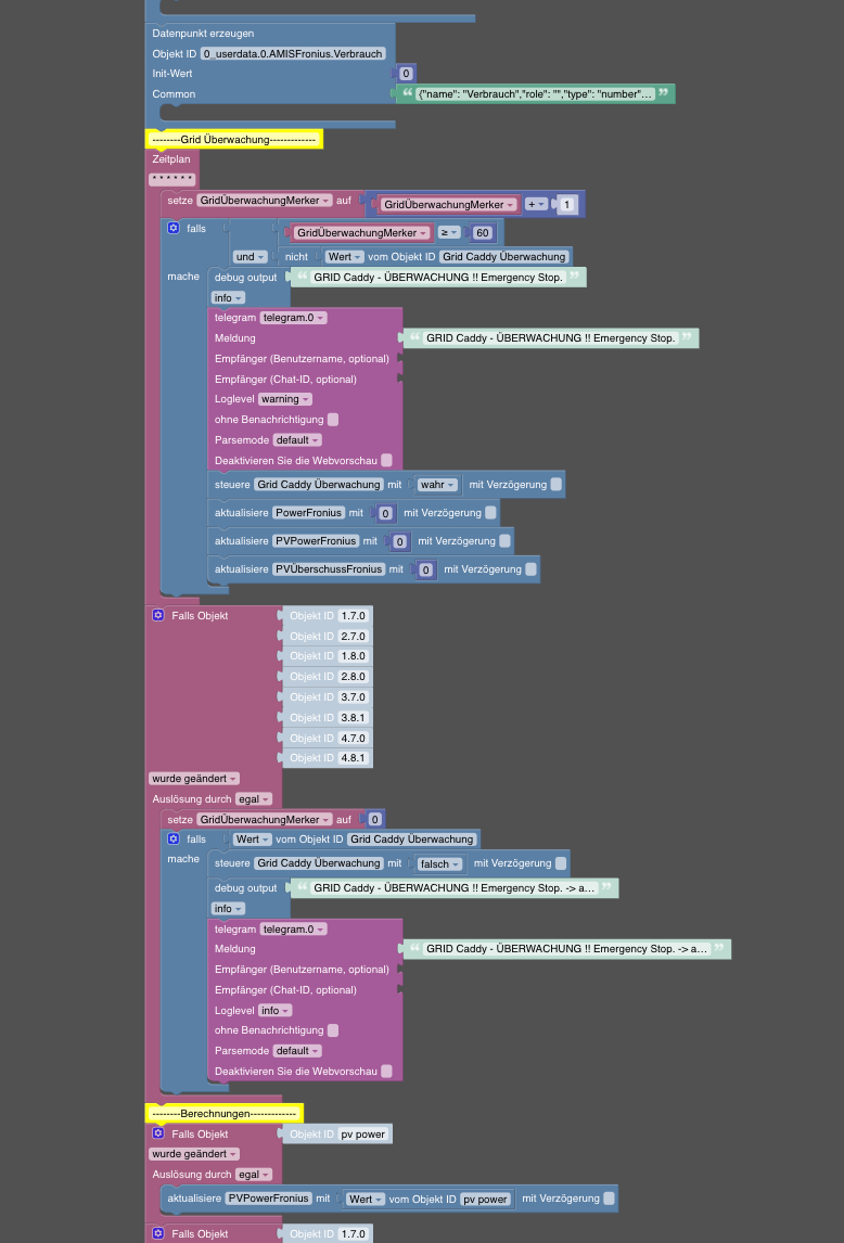

    Überwachungsskript:
    <variables>
    <variable id="BrQx4jB;k={w8|Lu7H">GridÜberwachungMerker</variable> </variables> <block type="comment" id="!O5*y@h_4{oH#[v35s7F" x="12" y="-212"> <field name="COMMENT">-------------Datenpunkte erzeugen-----------</field> <next> <block type="create" id="!HuCpXS@Er4zJUfKk7Z."> <field name="NAME">0_userdata.0.AMISFronius.11280</field> <value name="VALUE"> <block type="math_number" id="vpvqFMA%3YW}T},5Gwi/"> <field name="NUM">0</field> </block> </value> <value name="COMMON"> <block type="text" id="S6twCn_r$MJpR,{(p[?J"> <field name="TEXT">{"name": "11.280","role": "","type": "number","desc": "Blockly erzeugt","unit": "","min": 0,"max": 99999,"def": 0,"read": true,"write": true}</field> </block> </value> <next> <block type="create" id="8j{IBw*;7JMTwD9SR49p"> <field name="NAME">0_userdata.0.AMISFronius.170</field> <value name="VALUE"> <block type="math_number" id="H3KR@Fi=O%.Tk?FL:s+F"> <field name="NUM">0</field> </block> </value> <value name="COMMON"> <block type="text" id="G-Qm2eEOi$t6ZOk5Y.%T"> <field name="TEXT">{"name": "1.7.0","role": "","type": "number","desc": "Blockly erzeugt","unit": "W","min": 0,"max": 99999,"def": 0,"read": true,"write": true}</field> </block> </value> <next> <block type="create" id="GZD9U)C#QTPA-8.l@LBz"> <field name="NAME">0_userdata.0.AMISFronius.180</field> <value name="VALUE"> <block type="math_number" id="5m;z2}GW-5#PwUDe_lN("> <field name="NUM">0</field> </block> </value> <value name="COMMON"> <block type="text" id="zH(Q}J2UQ+k/cm1y{}cL"> <field name="TEXT">{"name": "1.8.0","role": "","type": "number","desc": "Blockly erzeugt","unit": "Wh","min": 0,"max": 99999,"def": 0,"read": true,"write": true}</field> </block> </value> <next> <block type="create" id="J;IaDKF*{j]J,vTY}(o">

    Es funktioniert zu 99%, aber das 1% mit Fehlauslösungen nervt.
    Denke wenn keine Änderung vom Power kommt, löst mir das aus, aber das kann auch das Maximum vom PV-WR sein.
    Ich möchte eine einfache Lösung, die ich auch zu 100% kapiere. Kein Java!
    Danke!
    BG
      Danke!

      Step by Step, die Überwachung:
      jede Sekunde wird ein Zähler aufgezogen, nach einer bestimmten Zeit 60s (mehr als genug), wird der Fehler erzeugt
      der Zähler wird sobald sich ein Wert geändert hat wieder auf 0 gesetzt und der Überwachungsmerker ggf. gelöscht.
      Alternativ fällt mir gerade ein, der Timestamp von der Mqtt Übertragung.
