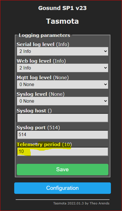

    Ich hätte versucht die Telemetry period von 10 auf 5 Sek. zu setzen, er setzt aber den Wert nach speichern wieder auf 10 zurück.
    Was habt ihr eingestellt ?
    haselchenH Offline
    haselchenH Offline
    haselchen
    #39
    @goetschhofer
    10 ist auch minimum
    TelePeriod See current value and force publish STATE and SENSOR message
    0 = disable telemetry messages
    1 = reset telemetry period to firmware default (TELE_PERIOD)
    10..3600 = set telemetry period in seconds (default = 300)
    Man kann das auch mit Workarounds umgehen, aber der Traffic hat auch Auswirkungen auf Dein System und Netzwerk.

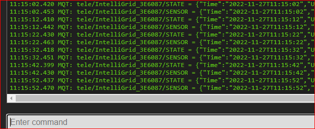

          11:21:09.457 CMD: PowerDelta101
          11:21:09.464 MQT: stat/IntelliGrid_3E6087/RESULT = {"Command":"Error"}
          11:21:12.424 MQT: tele/IntelliGrid_3E6087/STATE = {"Time":"2022-11-27T11:21:12","Uptime":"0T02:08:29","UptimeSec":7709,"Heap":25,"SleepMode":"Dynamic","Sleep":50,"LoadAvg":19,"MqttCount":1,"POWER":"ON","Wifi":{"AP":1,"SSId":"FRITZ!Box 7590 US-2,4 GHz","BSSId":"DC:39:6F:DB:30:7F","Channel":6,"Mode":"11n","RSSI":46,"Signal":-77,"LinkCount":1,"Downtime":"0T00:00:05"}}
          11:21:12.456 MQT: tele/IntelliGrid_3E6087/SENSOR = {"Time":"2022-11-27T11:21:12","ENERGY":{"TotalStartTime":"2022-11-26T18:09:02","Total":3.333,"Yesterday":0.021,"Today":0.028,"Period": 0,"Power": 0,"ApparentPower": 0,"ReactivePower": 0,"Factor":0.00,"Voltage":220,"Current":0.000}}
          11:21:22.419 MQT: tele/IntelliGrid_3E6087/STATE = {"Time":"2022-11-27T11:21:22","Uptime":"0T02:08:39","UptimeSec":7719,"Heap":25,"SleepMode":"Dynamic","Sleep":50,"LoadAvg":19,"MqttCount":1,"POWER":"ON","Wifi":{"AP":1,"SSId":"FRITZ!Box 7590 US-2,4 GHz","BSSId":"DC:39:6F:DB:30:7F","Channel":6,"Mode":"11n","RSSI":44,"Signal":-78,"LinkCount":1,"Downtime":"0T00:00:05"}}
          11:21:22.451 MQT: tele/IntelliGrid_3E6087/SENSOR = {"Time":"2022-11-27T11:21:22","ENERGY":{"TotalStartTime":"2022-11-26T18:09:02","Total":3.333,"Yesterday":0.021,"Today":0.028,"Period": 0,"Power": 0,"ApparentPower": 0,"ReactivePower": 0,"Factor":0.00,"Voltage":220,"Current":0.000}}
          11:21:32.419 MQT: tele/IntelliGrid_3E6087/STATE = {"Time":"2022-11-27T11:21:32","Uptime":"0T02:08:49","UptimeSec":7729,"Heap":25,"SleepMode":"Dynamic","Sleep":50,"LoadAvg":19,"MqttCount":1,"POWER":"ON","Wifi":{"AP":1,"SSId":"FRITZ!Box 7590 US-2,4 GHz","BSSId":"DC:39:6F:DB:30:7F","Channel":6,"Mode":"11n","RSSI":40,"Signal":-80,"LinkCount":1,"Downtime":"0T00:00:05"}}
          11:21:32.452 MQT: tele/IntelliGrid_3E6087/SENSOR = {"Time":"2022-11-27T11:21:32","ENERGY":{"TotalStartTime":"2022-11-26T18:09:02","Total":3.333,"Yesterday":0.021,"Today":0.028,"Period": 0,"Power": 0,"ApparentPower": 0,"ReactivePower": 0,"Factor":0.00,"Voltage":219,"Current":0.000}}
          11:21:42.406 MQT: tele/IntelliGrid_3E6087/STATE = {"Time":"2022-11-27T11:21:42","Uptime"
          Bei PowerDelta1 nicht.
          11:23:00.501 CMD: PowerDelta1
          11:23:00.508 MQT: stat/IntelliGrid_3E6087/RESULT = {"PowerDelta1":0}
          11:23:02.406 MQT: tele/IntelliGrid_3E6087/STATE = {"Time":"2022-11-27T11:23:02","Uptime":"0T02:10:19","UptimeSec":7819,"Heap":25,"SleepMode":"Dynamic","Sleep":50,"LoadAvg":19,"MqttCount":1,"POWER":"ON","Wifi":{"AP":1,"SSId":"FRITZ!Box 7590 US-2,4 GHz","BSSId":"DC:39:6F:DB:30:7F","Channel":6,"Mode":"11n","RSSI":44,"Signal":-78,"LinkCount":1,"Downtime":"0T00:00:05"}}
          11:23:02.439 MQT: tele/IntelliGrid_3E6087/SENSOR = {"Time":"2022-11-27T11:23:02","ENERGY":{"TotalStartTime":"2022-11-26T18:09:02","Total":3.333,"Yesterday":0.021,"Today":0.028,"Period": 0,"Power": 0,"ApparentPower": 0,"ReactivePower": 0,"Factor":0.00,"Voltage":218,"Current":0.000}}
          11:23:12.449 MQT: tele/IntelliGrid_3E6087/STATE = {"Time":"2022-11-27T11:23:12","Uptime":"0T02:10:29","UptimeSec":7829,"Heap":25,"SleepMode":"Dynamic","Sleep":50,"LoadAvg":19,"MqttCount":1,"POWER":"ON","Wifi":{"AP":1,"SSId":"FRITZ!Box 7590 US-2,4 GHz","BSSId":"DC:39:6F:DB:30:7F","Channel":6,"Mode":"11n","RSSI":40,"Signal":-80,"LinkCount":1,"Downtime":"0T00:00:05"}}
          11:23:12.481 MQT: tele/IntelliGrid_3E6087/SENSOR = {"Time":"2022-11-27T11:23:12","ENERGY":{"TotalStartTime":"2022-11-26T18:09:02","Total":3.333,"Yesterday":0.021,"Today":0.028,"Period": 0,"Power": 0,"ApparentPower": 0,"ReactivePower": 0,"Factor":0.00,"Voltage":218,"Current":0.000}}
          11:23:22.432 MQT: tele/IntelliGrid_3E6087/STATE = {"Time":"2022-11-27T11:23:22","Uptime":"0T02:1

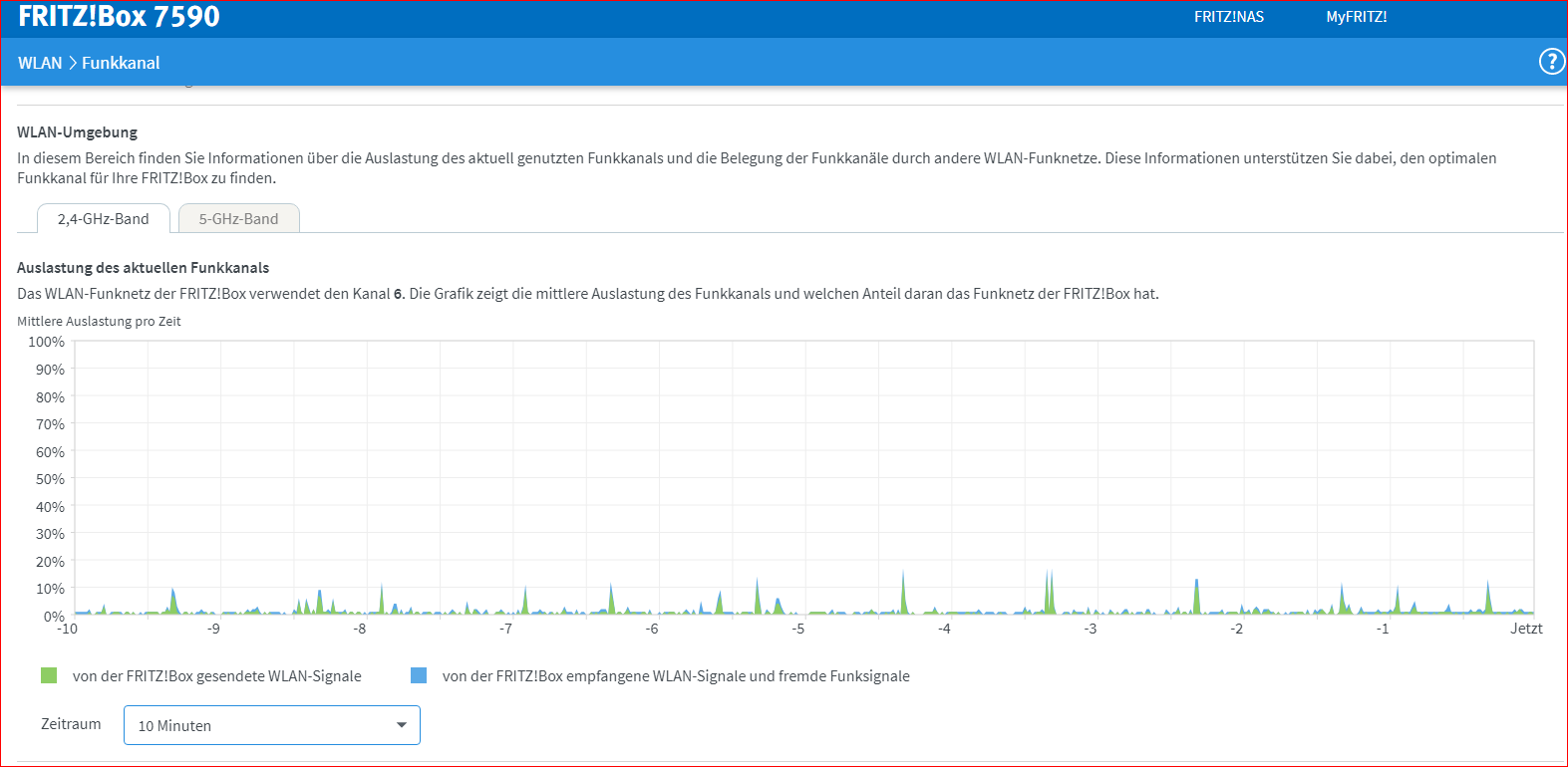

                @goetschhofer Aber dir muss klar sein das du jetzt jede Menge Traffic in deinem WLan hast.

                    @goetschhofer Das kommt darauf an wie ausgelastet dein Netzwerk ist.
                    Wenn du nur ein paar Geräte hast sehe ich da wenig Probleme. Bei mir sind knapp 80 Geräte aktiv. Da ist es schon blöd wenn ein Gerät so das Netz zuballert.

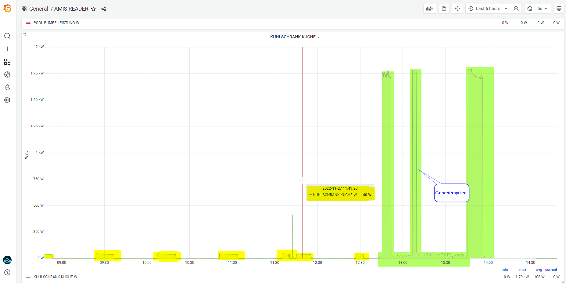

                          @chaot said in SONOFF Adapter in Kollision mit MQTT Adapter:
                          @goetschhofer
                          Poerdelta bedeutet das ein Datenpaket gesendet wird sobald sich der Wert um den eingestellten Faktor ändert.
                          Bei 101 heißt das bei Änderung um 1 Watt.
                          Für was wird der Stecker denn benutzt? Oder anders ausgedrückt: Wie genau brauchst du das denn überhaupt?
                          Der interne Wert des Verbrauchs wird permanent aufgezeichnet. Dazu benötigt man keine Telemetrieperiode. Mir reicht es in der VIS wenn ich alle 5 Minuten den Verbrauch übertragen bekomme. Ich benötige nicht sekundengenau den aktuellen Verbrauchswert.
                          Das ganze dient ja anfangs nur zu Test- und Informationszwecken, darum meine Genauigkeit.
                          Mich interessiert eben, aus Lastprofil-Sicht, wie tickt ein Kühlschrank, Geschirrspüler oder Waschmaschine.
                          Ich teste so meine Verbraucher durch.
                          Langfristig hat es keinen Sinn Datenmüll, vor allem auch auf der InfluxDB, zu erzeugen.

                            @goetschhofer Bei solchen Geräten kannst du aber auch höhere Deltawerte verwenden. Ob der Motor mal 1-2 Watt hin und her schwankt ist ja dann unerheblich.
                            Also reicht dir im Grunde die 105, also 5 Watt Änderung locker aus.
                            Bei einem Kühlschrank macht es auch Sinn den Verbrauch auf 7 Tage zu sehen und dann durch die Stunden zu teilen. Dann hast du einen realistischen Wert. Da wird am Sonntag mal öfter die Tür aufgemacht und dafür am Dienstag beispielsweise kaum usw. Also Zählerwert von Montag 8:00 Uhr bis Montag 7:59 Uhr geteilt durch 168 Stunden ist der Stundenverbrauch des Kühlschranks. Der Wert mal 52 ist der Jahresverbrauch usw....
                            Waschmaschine und Geschirrspüler habe ich bei mir einzeln getestet mit den entsprechendem Programmablauf. Also meine Arbeitsklamotten auf 60°C mit dem Programm X brauchen xxx Watt pro Waschgang. Das ist eine Zahl die ich einfacher meiner Frau verkaufen kann: "Waschen mit Programm X kostet X,xx €"

                                @chaot
                                Ja, ich werde dies auf jeden Fall auf 105 hochstellen.
                                So wie du dies gemacht hast, stelle ich mir dies auch vor bezüglich hochskalieren.
                                Am Ende zählt der Verbrauch in Wh pro Zeitperiode.
