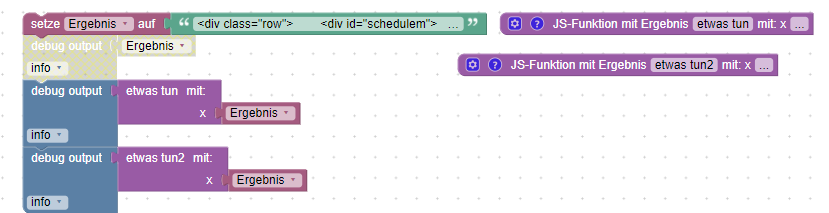

    Ich habe nun folgendes aus Deinen JS Skripten gebastelt:
    var x, Schedule, result, Ergebnis, Tag, Uhrzeit;
    // Beschreibe diese Funktion …
    async function Tag2(x) {
        let z=x.replace(/\n/,"")
         y=z.match(/yMonth"> (.*?)<\/div>/gm)
        return y[0].replace('yMonth">',"").replace('<\/div>',"");
    async function Uhrzeit2(x) {
        let y=x.match(/"Time":"([\d,-: ]+)/gm)
        return y[0].replace('"Time":"',"");
    schedule("*/20 * * * * *", async function () {
      try {
        require("request")('https://loadshedding.eskom.co.za/LoadShedding/GetStatus', async function (error, response, result) {
          Schedule = parseFloat(parseFloat(result)) - 1;
        if (Schedule > 0) {
          console.log((['Loadshedding Stage ',Schedule,' !'].join('')));
          try {
            require("request")(([' https://loadshedding.eskom.co.za/LoadShedding/GetScheduleM/1060136/',Schedule,'/9/1'].join('')), async function (error, response, result) {
              Ergebnis = result;
            Tag = await Tag2(Ergebnis);
            Uhrzeit = await Uhrzeit2(Ergebnis);
            console.log((String(Tag) + String(Uhrzeit)));
            }).on("error", function (e) {console.error(e);});
          } catch (e) { console.error(e); }
    //JTNDeG1sJTIweG1sbnMlM0QlMjJodHRwcyUzQSUyRiUyRmRldmVsb3BlcnMuZ29vZ2xlLmNvbSUyRmJsb2NrbHklMkZ4bWwlMjIlM0UlM0N2YXJpYWJsZXMlM0UlM0N2YXJpYWJsZSUyMGlkJTNEJTIyTzkzcCUzQXIxJTdDXyUyNGNBNyl+WmJtTmklMjIlM0V4JTNDJTJGdmFyaWFibGUlM0UlM0N2YXJpYWJsZSUyMGlkJTNEJTIyUilzJTdDJTNBRnFBaSU3QyUzRCUyQihUUCUyNCUyNSpUayUyMiUzRVNjaGVkdWxlJTNDJTJGdmFyaWFibGUlM0UlM0N2YXJpYWJsZSUyMGlkJTNEJTIySCU3RCU2MFM2Z0kuVCk2JTI0JTNEeVFmOVdrJTNGJTIyJTNFcmVzdWx0JTNDJTJGdmFyaWFibGUlM0UlM0N2YXJpYWJsZSUyMGlkJTNEJTIyUiUzRn4lNDAxbyUzRjRuZTRzRlE4WG1BViU1QiUyMiUzRUVyZ2VibmlzJTNDJTJGdmFyaWFibGUlM0UlM0N2YXJpYWJsZSUyMGlkJTNEJTIyJTI1akhyYkdnJTdCJTYwbiUyNTAlMjR+VVZMcyUzQmYlMjIlM0VUYWclM0MlMkZ2YXJpYWJsZSUzRSUzQ3ZhcmlhYmxlJTIwaWQlM0QlMjJrWiU0MHl6IUktOEp0bWElNUVsSiU3RCU1RChiJTIyJTNFVWhyemVpdCUzQyUyRnZhcmlhYmxlJTNFJTNDJTJGdmFyaWFibGVzJTNFJTNDYmxvY2slMjB0eXBlJTNEJTIycHJvY2VkdXJlc19kZWZjdXN0b21yZXR1cm4lMjIlMjBpZCUzRCUyMjQlN0QlMjVwKTAlMkZlJTNEZTZDM3clMkJnayU1RCUyNSUyQiUyMiUyMHglM0QlMjI2MiUyMiUyMHklM0QlMjItMTEzJTIyJTNFJTNDbXV0YXRpb24lMjBzdGF0ZW1lbnRzJTNEJTIyZmFsc2UlMjIlM0UlM0NhcmclMjBuYW1lJTNEJTIyeCUyMiUyMHZhcmlkJTNEJTIyTzkzcCUzQXIxJTdDXyUyNGNBNyl+WmJtTmklMjIlM0UlM0MlMkZhcmclM0UlM0MlMkZtdXRhdGlvbiUzRSUzQ2ZpZWxkJTIwbmFtZSUzRCUyMk5BTUUlMjIlM0VUYWclM0MlMkZmaWVsZCUzRSUzQ2ZpZWxkJTIwbmFtZSUzRCUyMlNDUklQVCUyMiUzRWJHVjBJSG85ZUM1eVpYQnNZV05sS0M5Y2JpOHNJaUlwRFFvTkNpQjVQWG91YldGMFkyZ29MM2xOYjI1MGFDSSUyQklDZ3VLajhwUEZ3dlpHbDJQaTluYlNrTkNnMEtEUW9OQ25KbGRIVnliaUI1V3pCZExuSmxjR3hoWTJVb0ozbE5iMjUwYUNJJTJCSnl3aUlpa3VjbVZ3YkdGalpTZ25QRnd2WkdsMlBpY3NJaUlwT3clM0QlM0QlM0MlMkZmaWVsZCUzRSUzQ2NvbW1lbnQlMjBwaW5uZWQlM0QlMjJmYWxzZSUyMiUyMGglM0QlMjI4MCUyMiUyMHclM0QlMjIxNjAlMjIlM0VCZXNjaHJlaWJlJTIwZGllc2UlMjBGdW5rdGlvbiUyMCVFMiU4MCVBNiUzQyUyRmNvbW1lbnQlM0UlM0MlMkZibG9jayUzRSUzQ2Jsb2NrJTIwdHlwZSUzRCUyMnByb2NlZHVyZXNfZGVmY3VzdG9tcmV0dXJuJTIyJTIwaWQlM0QlMjJzZXV0OH4taiU1Qm5NUTUlMjUlMjNLJTNGT2FBJTIyJTIweCUzRCUyMjYzJTIyJTIweSUzRCUyMi02MyUyMiUzRSUzQ211dGF0aW9uJTIwc3RhdGVtZW50cyUzRCUyMmZhbHNlJTIyJTNFJTNDYXJnJTIwbmFtZSUzRCUyMnglMjIlMjB2YXJpZCUzRCUyMk85M3AlM0FyMSU3Q18lMjRjQTcpflpibU5pJTIyJTNFJTNDJTJGYXJnJTNFJTNDJTJGbXV0YXRpb24lM0UlM0NmaWVsZCUyMG5hbWUlM0QlMjJOQU1FJTIyJTNFVWhyemVpdCUzQyUyRmZpZWxkJTNFJTNDZmllbGQlMjBuYW1lJTNEJTIyU0NSSVBUJTIyJTNFYkdWMElIazllQzV0WVhSamFDZ3ZJbFJwYldVaU9pSW9XMXhrTEMwNklGMHJLUzluYlNrTkNnMEtEUW9OQ25KbGRIVnliaUI1V3pCZExuSmxjR3hoWTJVb0p5SlVhVzFsSWpvaUp5d2lJaWs3JTNDJTJGZmllbGQlM0UlM0Njb21tZW50JTIwcGlubmVkJTNEJTIyZmFsc2UlMjIlMjBoJTNEJTIyODAlMjIlMjB3JTNEJTIyMTYwJTIyJTNFQmVzY2hyZWliZSUyMGRpZXNlJTIwRnVua3Rpb24lMjAlRTIlODAlQTYlM0MlMkZjb21tZW50JTNFJTNDJTJGYmxvY2slM0UlM0NibG9jayUyMHR5cGUlM0QlMjJzY2hlZHVsZSUyMiUyMGlkJTNEJTIyZU0hNkRyLSUzRG8lMjQlNjBqcyUzQSglNDBDKCUzRiU1RSUyMiUyMHglM0QlMjI2MyUyMiUyMHklM0QlMjI2MyUyMiUzRSUzQ2ZpZWxkJTIwbmFtZSUzRCUyMlNDSEVEVUxFJTIyJTNFKiUyRjIwJTIwKiUyMColMjAqJTIwKiUyMColM0MlMkZmaWVsZCUzRSUzQ3N0YXRlbWVudCUyMG5hbWUlM0QlMjJTVEFURU1FTlQlMjIlM0UlM0NibG9jayUyMHR5cGUlM0QlMjJyZXF1ZXN0JTIyJTIwaWQlM0QlMjJaYUslM0FRJTYwTSUzRlpoJTVEUVg1Y3AlM0ZiVjklMjIlM0UlM0NtdXRhdGlvbiUyMHhtbG5zJTNEJTIyaHR0cCUzQSUyRiUyRnd3dy53My5vcmclMkYxOTk5JTJGeGh0bWwlMjIlMjB3aXRoX3N0YXRlbWVudCUzRCUyMnRydWUlMjIlM0UlM0MlMkZtdXRhdGlvbiUzRSUzQ2ZpZWxkJTIwbmFtZSUzRCUyMldJVEhfU1RBVEVNRU5UJTIyJTNFVFJVRSUzQyUyRmZpZWxkJTNFJTNDZmllbGQlMjBuYW1lJTNEJTIyTE9HJTIyJTNFJTNDJTJGZmllbGQlM0UlM0N2YWx1ZSUyMG5hbWUlM0QlMjJVUkwlMjIlM0UlM0NzaGFkb3clMjB0eXBlJTNEJTIydGV4dCUyMiUyMGlkJTNEJTIyJTNEU0tGSlBVJTNBZzl0UDIlNjBjJTNEIW0lMjRzJTIyJTNFJTNDZmllbGQlMjBuYW1lJTNEJTIyVEVYVCUyMiUzRWh0dHAlM0ElMkYlMkZsb2Fkc2hlZGRpbmcuZXNrb20uY28uemElMkZMb2FkU2hlZGRpbmclMkZHZXRTdGF0dXMlM0MlMkZmaWVsZCUzRSUzQyUyRnNoYWRvdyUzRSUzQ2Jsb2NrJTIwdHlwZSUzRCUyMnRleHQlMjIlMjBpZCUzRCUyMlROTmglMjUzY2NsZyhOKHVBRHJ2NXglMjIlM0UlM0NmaWVsZCUyMG5hbWUlM0QlMjJURVhUJTIyJTNFaHR0cHMlM0ElMkYlMkZsb2Fkc2hlZGRpbmcuZXNrb20uY28uemElMkZMb2FkU2hlZGRpbmclMkZHZXRTdGF0dXMlM0MlMkZmaWVsZCUzRSUzQyUyRmJsb2NrJTNFJTNDJTJGdmFsdWUlM0UlM0NzdGF0ZW1lbnQlMjBuYW1lJTNEJTIyU1RBVEVNRU5UJTIyJTNFJTNDYmxvY2slMjB0eXBlJTNEJTIydmFyaWFibGVzX3NldCUyMiUyMGlkJTNEJTIyVTIlMkJBaHFVRyUzQVZPdilfYkNUOEtuJTIyJTNFJTNDZmllbGQlMjBuYW1lJTNEJTIyVkFSJTIyJTIwaWQlM0QlMjJSKXMlN0MlM0FGcUFpJTdDJTNEJTJCKFRQJTI0JTI1KlRrJTIyJTNFU2NoZWR1bGUlM0MlMkZmaWVsZCUzRSUzQ3ZhbHVlJTIwbmFtZSUzRCUyMlZBTFVFJTIyJTNFJTNDYmxvY2slMjB0eXBlJTNEJTIybWF0aF9hcml0aG1ldGljJTIyJTIwaWQlM0QlMjI1ayU3Q1ZGXzBQcilNVTZCYjdSVERJJTIyJTNFJTNDZmllbGQlMjBuYW1lJTNEJTIyT1AlMjIlM0VNSU5VUyUzQyUyRmZpZWxkJTNFJTNDdmFsdWUlMjBuYW1lJTNEJTIyQSUyMiUzRSUzQ3NoYWRvdyUyMHR5cGUlM0QlMjJtYXRoX251bWJlciUyMiUyMGlkJTNEJTIyYjIlN0NWMSglMjQlNjBPLlFua28tUXclMjNNMCUyMiUzRSUzQ2ZpZWxkJTIwbmFtZSUzRCUyMk5VTSUyMiUzRTElM0MlMkZmaWVsZCUzRSUzQyUyRnNoYWRvdyUzRSUzQ2Jsb2NrJTIwdHlwZSUzRCUyMmNvbnZlcnRfdG9udW1iZXIlMjIlMjBpZCUzRCUyMnpob0NwVWQ3S1NmJTI0cjNfRyU2MH4lM0I0JTIyJTNFJTNDdmFsdWUlMjBuYW1lJTNEJTIyVkFMVUUlMjIlM0UlM0NibG9jayUyMHR5cGUlM0QlMjJ2YXJpYWJsZXNfZ2V0JTIyJTIwaWQlM0QlMjJCUDR3cWMlMjRnc29VOXdDMTIlM0ZUJTI1JTIzJTIyJTNFJTNDZmllbGQlMjBuYW1lJTNEJTIyVkFSJTIyJTIwaWQlM0QlMjJIJTdEJTYwUzZnSS5UKTYlMjQlM0R5UWY5V2slM0YlMjIlM0VyZXN1bHQlM0MlMkZmaWVsZCUzRSUzQyUyRmJsb2NrJTNFJTNDJTJGdmFsdWUlM0UlM0MlMkZibG9jayUzRSUzQyUyRnZhbHVlJTNFJTNDdmFsdWUlMjBuYW1lJTNEJTIyQiUyMiUzRSUzQ3NoYWRvdyUyMHR5cGUlM0QlMjJtYXRoX251bWJlciUyMiUyMGlkJTNEJTIyJTNBJTVFV2JQRShZbURFSGVpJTdCUChmMWwlMjIlM0UlM0NmaWVsZCUyMG5hbWUlM0QlMjJOVU0lMjIlM0UxJTNDJTJGZmllbGQlM0UlM0MlMkZzaGFkb3clM0UlM0MlMkZ2YWx1ZSUzRSUzQyUyRmJsb2NrJTNFJTNDJTJGdmFsdWUlM0UlM0NuZXh0JTNFJTNDYmxvY2slMjB0eXBlJTNEJTIyY29udHJvbHNfaWYlMjIlMjBpZCUzRCUyMkgzVVFMZCFpJTNBeVkzZFYuZFplRUUlMjIlM0UlM0N2YWx1ZSUyMG5hbWUlM0QlMjJJRjAlMjIlM0UlM0NibG9jayUyMHR5cGUlM0QlMjJsb2dpY19jb21wYXJlJTIyJTIwaWQlM0QlMjJkQnNuM05LOUcqRCU1RWN0d3ZCVnMlM0IlMjIlM0UlM0NmaWVsZCUyMG5hbWUlM0QlMjJPUCUyMiUzRUdUJTNDJTJGZmllbGQlM0UlM0N2YWx1ZSUyMG5hbWUlM0QlMjJBJTIyJTNFJTNDYmxvY2slMjB0eXBlJTNEJTIydmFyaWFibGVzX2dldCUyMiUyMGlkJTNEJTIyUXRNN1p2aTVlJTYwJTVEQiUyRiUyM351WGg1JTNBJTIyJTNFJTNDZmllbGQlMjBuYW1lJTNEJTIyVkFSJTIyJTIwaWQlM0QlMjJSKXMlN0MlM0FGcUFpJTdDJTNEJTJCKFRQJTI0JTI1KlRrJTIyJTNFU2NoZWR1bGUlM0MlMkZmaWVsZCUzRSUzQyUyRmJsb2NrJTNFJTNDJTJGdmFsdWUlM0UlM0N2YWx1ZSUyMG5hbWUlM0QlMjJCJTIyJTNFJTNDYmxvY2slMjB0eXBlJTNEJTIybWF0aF9udW1iZXIlMjIlMjBpZCUzRCUyMjEzcCUzRFJfNm9iJTNGT0xqJTI0JTNENm1abiUyNCUyMiUzRSUzQ2ZpZWxkJTIwbmFtZSUzRCUyMk5VTSUyMiUzRTAlM0MlMkZmaWVsZCUzRSUzQyUyRmJsb2NrJTNFJTNDJTJGdmFsdWUlM0UlM0MlMkZibG9jayUzRSUzQyUyRnZhbHVlJTNFJTNDc3RhdGVtZW50JTIwbmFtZSUzRCUyMkRPMCUyMiUzRSUzQ2Jsb2NrJTIwdHlwZSUzRCUyMmRlYnVnJTIyJTIwaWQlM0QlMjI0RCU1RDI4JTdEejZBJTNCYWx4JTYwXyU1QlhsKCUzQSUyMiUzRSUzQ2ZpZWxkJTIwbmFtZSUzRCUyMlNldmVyaXR5JTIyJTNFbG9nJTNDJTJGZmllbGQlM0UlM0N2YWx1ZSUyMG5hbWUlM0QlMjJURVhUJTIyJTNFJTNDc2hhZG93JTIwdHlwZSUzRCUyMnRleHQlMjIlM0UlM0NmaWVsZCUyMG5hbWUlM0QlMjJURVhUJTIyJTNFdGVzdCUzQyUyRmZpZWxkJTNFJTNDJTJGc2hhZG93JTNFJTNDYmxvY2slMjB0eXBlJTNEJTIydGV4dF9qb2luJTIyJTIwaWQlM0QlMjIlN0RHd29FdiUyMyUyNFVfJTIzMCUyM2Q3RSUzQn4lMjRxJTIyJTNFJTNDbXV0YXRpb24lMjBpdGVtcyUzRCUyMjMlMjIlM0UlM0MlMkZtdXRhdGlvbiUzRSUzQ3ZhbHVlJTIwbmFtZSUzRCUyMkFERDAlMjIlM0UlM0NibG9jayUyMHR5cGUlM0QlMjJ0ZXh0JTIyJTIwaWQlM0QlMjIzLXk2aCU2MGwlM0ZvQUN+VyU1RDYlMkN0WCU3Q2MlMjIlM0UlM0NmaWVsZCUyMG5hbWUlM0QlMjJURVhUJTIyJTNFTG9hZHNoZWRkaW5nJTIwU3RhZ2UlMjAlM0MlMkZmaWVsZCUzRSUzQyUyRmJsb2NrJTNFJTNDJTJGdmFsdWUlM0UlM0N2YWx1ZSUyMG5hbWUlM0QlMjJBREQxJTIyJTNFJTNDYmxvY2slMjB0eXBlJTNEJTIydmFyaWFibGVzX2dldCUyMiUyMGlkJTNEJTIyJTJGJTIzWjluJTdDRyU3RE13emglMjRBbFFwQk1sJTIyJTNFJTNDZmllbGQlMjBuYW1lJTNEJTIyVkFSJTIyJTIwaWQlM0QlMjJSKXMlN0MlM0FGcUFpJTdDJTNEJTJCKFRQJTI0JTI1KlRrJTIyJTNFU2NoZWR1bGUlM0MlMkZmaWVsZCUzRSUzQyUyRmJsb2NrJTNFJTNDJTJGdmFsdWUlM0UlM0N2YWx1ZSUyMG5hbWUlM0QlMjJBREQyJTIyJTNFJTNDYmxvY2slMjB0eXBlJTNEJTIydGV4dCUyMiUyMGlkJTNEJTIyJTIzJTNGNjIlM0JSaVkwJTdCKmIzaWFlNXFRQSUyMiUzRSUzQ2ZpZWxkJTIwbmFtZSUzRCUyMlRFWFQlMjIlM0UlMjAhJTNDJTJGZmllbGQlM0UlM0MlMkZibG9jayUzRSUzQyUyRnZhbHVlJTNFJTNDJTJGYmxvY2slM0UlM0MlMkZ2YWx1ZSUzRSUzQ25leHQlM0UlM0NibG9jayUyMHR5cGUlM0QlMjJyZXF1ZXN0JTIyJTIwaWQlM0QlMjJVdil4TCUzRE8yUURkLm0lM0YlN0RaeGtEaSUyMiUzRSUzQ211dGF0aW9uJTIweG1sbnMlM0QlMjJodHRwJTNBJTJGJTJGd3d3LnczLm9yZyUyRjE5OTklMkZ4aHRtbCUyMiUyMHdpdGhfc3RhdGVtZW50JTNEJTIydHJ1ZSUyMiUzRSUzQyUyRm11dGF0aW9uJTNFJTNDZmllbGQlMjBuYW1lJTNEJTIyV0lUSF9TVEFURU1FTlQlMjIlM0VUUlVFJTNDJTJGZmllbGQlM0UlM0NmaWVsZCUyMG5hbWUlM0QlMjJMT0clMjIlM0UlM0MlMkZmaWVsZCUzRSUzQ3ZhbHVlJTIwbmFtZSUzRCUyMlVSTCUyMiUzRSUzQ3NoYWRvdyUyMHR5cGUlM0QlMjJ0ZXh0JTIyJTIwaWQlM0QlMjIlMkJQJTJCQ3clMjNBJTIzb0UxJTdCJTdEQS5BTnFhJTI0JTIyJTNFJTNDZmllbGQlMjBuYW1lJTNEJTIyVEVYVCUyMiUzRXRleHQlM0MlMkZmaWVsZCUzRSUzQyUyRnNoYWRvdyUzRSUzQ2Jsb2NrJTIwdHlwZSUzRCUyMnRleHRfam9pbiUyMiUyMGlkJTNEJTIyJTVFJTYwKnRaLWdxMCU3Qm8lNDBPZF9jZGJGRiUyMiUzRSUzQ211dGF0aW9uJTIwaXRlbXMlM0QlMjIzJTIyJTNFJTNDJTJGbXV0YXRpb24lM0UlM0N2YWx1ZSUyMG5hbWUlM0QlMjJBREQwJTIyJTNFJTNDYmxvY2slMjB0eXBlJTNEJTIydGV4dCUyMiUyMGlkJTNEJTIyZG8tQSUzRkRIN3pXeWNRJTdEJTQwSyU0MCU1QnYlM0ElMjIlM0UlM0NmaWVsZCUyMG5hbWUlM0QlMjJURVhUJTIyJTNFJTIwaHR0cHMlM0ElMkYlMkZsb2Fkc2hlZGRpbmcuZXNrb20uY28uemElMkZMb2FkU2hlZGRpbmclMkZHZXRTY2hlZHVsZU0lMkYxMDYwMTM2JTJGJTNDJTJGZmllbGQlM0UlM0MlMkZibG9jayUzRSUzQyUyRnZhbHVlJTNFJTNDdmFsdWUlMjBuYW1lJTNEJTIyQUREMSUyMiUzRSUzQ2Jsb2NrJTIwdHlwZSUzRCUyMnZhcmlhYmxlc19nZXQlMjIlMjBpZCUzRCUyMlElM0ZZJTI0NyUyNSUyQihEbSl6Tk1QRHg4dzklMjIlM0UlM0NmaWVsZCUyMG5hbWUlM0QlMjJWQVIlMjIlMjBpZCUzRCUyMlIpcyU3QyUzQUZxQWklN0MlM0QlMkIoVFAlMjQlMjUqVGslMjIlM0VTY2hlZHVsZSUzQyUyRmZpZWxkJTNFJTNDJTJGYmxvY2slM0UlM0MlMkZ2YWx1ZSUzRSUzQ3ZhbHVlJTIwbmFtZSUzRCUyMkFERDIlMjIlM0UlM0NibG9jayUyMHR5cGUlM0QlMjJ0ZXh0JTIyJTIwaWQlM0QlMjJPJTJDJTdDUWdvMyUyQ3klNjAlNjBTNTNmRXJKUGglMjIlM0UlM0NmaWVsZCUyMG5hbWUlM0QlMjJURVhUJTIyJTNFJTJGOSUyRjElM0MlMkZmaWVsZCUzRSUzQyUyRmJsb2NrJTNFJTNDJTJGdmFsdWUlM0UlM0MlMkZibG9jayUzRSUzQyUyRnZhbHVlJTNFJTNDc3RhdGVtZW50JTIwbmFtZSUzRCUyMlNUQVRFTUVOVCUyMiUzRSUzQ2Jsb2NrJTIwdHlwZSUzRCUyMnZhcmlhYmxlc19zZXQlMjIlMjBpZCUzRCUyMlhBZkxGfkowTSUyNGhUMkZkajVkZHMlMjIlM0UlM0NmaWVsZCUyMG5hbWUlM0QlMjJWQVIlMjIlMjBpZCUzRCUyMlIlM0Z+JTQwMW8lM0Y0bmU0c0ZROFhtQVYlNUIlMjIlM0VFcmdlYm5pcyUzQyUyRmZpZWxkJTNFJTNDdmFsdWUlMjBuYW1lJTNEJTIyVkFMVUUlMjIlM0UlM0NibG9jayUyMHR5cGUlM0QlMjJ2YXJpYWJsZXNfZ2V0JTIyJTIwaWQlM0QlMjI3KSUzRldiJTYwZ3Z1T08lM0I3JTJGOHRiXy0wJTIyJTNFJTNDZmllbGQlMjBuYW1lJTNEJTIyVkFSJTIyJTIwaWQlM0QlMjJIJTdEJTYwUzZnSS5UKTYlMjQlM0R5UWY5V2slM0YlMjIlM0VyZXN1bHQlM0MlMkZmaWVsZCUzRSUzQyUyRmJsb2NrJTNFJTNDJTJGdmFsdWUlM0UlM0NuZXh0JTNFJTNDYmxvY2slMjB0eXBlJTNEJTIydmFyaWFibGVzX3NldCUyMiUyMGlkJTNEJTIyQWUlM0Q1JTQwJTVFeERCMVMlM0FuNSUyMy4lMkIlNDBPJTNEJTIyJTNFJTNDZmllbGQlMjBuYW1lJTNEJTIyVkFSJTIyJTIwaWQlM0QlMjIlMjVqSHJiR2clN0IlNjBuJTI1MCUyNH5VVkxzJTNCZiUyMiUzRVRhZyUzQyUyRmZpZWxkJTNFJTNDdmFsdWUlMjBuYW1lJTNEJTIyVkFMVUUlMjIlM0UlM0NibG9jayUyMHR5cGUlM0QlMjJwcm9jZWR1cmVzX2NhbGxjdXN0b21yZXR1cm4lMjIlMjBpZCUzRCUyMm0lMjNjb2N3dzZXRilGMiUzRGlWc1Z1TiUyMiUzRSUzQ211dGF0aW9uJTIwbmFtZSUzRCUyMlRhZyUyMiUzRSUzQ2FyZyUyMG5hbWUlM0QlMjJ4JTIyJTNFJTNDJTJGYXJnJTNFJTNDJTJGbXV0YXRpb24lM0UlM0N2YWx1ZSUyMG5hbWUlM0QlMjJBUkcwJTIyJTNFJTNDYmxvY2slMjB0eXBlJTNEJTIydmFyaWFibGVzX2dldCUyMiUyMGlkJTNEJTIyQSU0MCU1RUolNUIlM0RQQSU2MG4lNUQ1TnAlN0NFQ01mbSUyMiUzRSUzQ2ZpZWxkJTIwbmFtZSUzRCUyMlZBUiUyMiUyMGlkJTNEJTIyUiUzRn4lNDAxbyUzRjRuZTRzRlE4WG1BViU1QiUyMiUzRUVyZ2VibmlzJTNDJTJGZmllbGQlM0UlM0MlMkZibG9jayUzRSUzQyUyRnZhbHVlJTNFJTNDJTJGYmxvY2slM0UlM0MlMkZ2YWx1ZSUzRSUzQ25leHQlM0UlM0NibG9jayUyMHR5cGUlM0QlMjJ2YXJpYWJsZXNfc2V0JTIyJTIwaWQlM0QlMjJUTEpCSUxUUUhSMmouVUhWZSU3QjgoJTIyJTNFJTNDZmllbGQlMjBuYW1lJTNEJTIyVkFSJTIyJTIwaWQlM0QlMjJrWiU0MHl6IUktOEp0bWElNUVsSiU3RCU1RChiJTIyJTNFVWhyemVpdCUzQyUyRmZpZWxkJTNFJTNDdmFsdWUlMjBuYW1lJTNEJTIyVkFMVUUlMjIlM0UlM0NibG9jayUyMHR5cGUlM0QlMjJwcm9jZWR1cmVzX2NhbGxjdXN0b21yZXR1cm4lMjIlMjBpZCUzRCUyMk1VSmZqMGQlNUVjTyU3QnRIcnMhYV8uVSUyMiUzRSUzQ211dGF0aW9uJTIwbmFtZSUzRCUyMlVocnplaXQlMjIlM0UlM0NhcmclMjBuYW1lJTNEJTIyeCUyMiUzRSUzQyUyRmFyZyUzRSUzQyUyRm11dGF0aW9uJTNFJTNDdmFsdWUlMjBuYW1lJTNEJTIyQVJHMCUyMiUzRSUzQ2Jsb2NrJTIwdHlwZSUzRCUyMnZhcmlhYmxlc19nZXQlMjIlMjBpZCUzRCUyMnEwISU1QiU1RTlIbFAlNUVGY2klMjM4Km0lNUVmeSUyMiUzRSUzQ2ZpZWxkJTIwbmFtZSUzRCUyMlZBUiUyMiUyMGlkJTNEJTIyUiUzRn4lNDAxbyUzRjRuZTRzRlE4WG1BViU1QiUyMiUzRUVyZ2VibmlzJTNDJTJGZmllbGQlM0UlM0MlMkZibG9jayUzRSUzQyUyRnZhbHVlJTNFJTNDJTJGYmxvY2slM0UlM0MlMkZ2YWx1ZSUzRSUzQ25leHQlM0UlM0NibG9jayUyMHR5cGUlM0QlMjJkZWJ1ZyUyMiUyMGlkJTNEJTIyLS0lM0RDZip+bH5kSWI4bCUyRi5DeSUyQyU1QiUyMiUzRSUzQ2ZpZWxkJTIwbmFtZSUzRCUyMlNldmVyaXR5JTIyJTNFbG9nJTNDJTJGZmllbGQlM0UlM0N2YWx1ZSUyMG5hbWUlM0QlMjJURVhUJTIyJTNFJTNDc2hhZG93JTIwdHlwZSUzRCUyMnRleHQlMjIlMjBpZCUzRCUyMlN5SkpYVFQlN0RtJTJDOGYoJTVCWnglNjBqJTdETSUyMiUzRSUzQ2ZpZWxkJTIwbmFtZSUzRCUyMlRFWFQlMjIlM0V0ZXN0JTNDJTJGZmllbGQlM0UlM0MlMkZzaGFkb3clM0UlM0NibG9jayUyMHR5cGUlM0QlMjJ0ZXh0X2pvaW4lMjIlMjBpZCUzRCUyMiUyQkFkbEpscW8lN0QuSEVRSyliJTI1JTdEcnklMjIlM0UlM0NtdXRhdGlvbiUyMGl0ZW1zJTNEJTIyMiUyMiUzRSUzQyUyRm11dGF0aW9uJTNFJTNDdmFsdWUlMjBuYW1lJTNEJTIyQUREMCUyMiUzRSUzQ2Jsb2NrJTIwdHlwZSUzRCUyMnZhcmlhYmxlc19nZXQlMjIlMjBpZCUzRCUyMmolNURlKWtBa0xxMDU0IUo1NCElN0QqOCUyMiUzRSUzQ2ZpZWxkJTIwbmFtZSUzRCUyMlZBUiUyMiUyMGlkJTNEJTIyJTI1akhyYkdnJTdCJTYwbiUyNTAlMjR+VVZMcyUzQmYlMjIlM0VUYWclM0MlMkZmaWVsZCUzRSUzQyUyRmJsb2NrJTNFJTNDJTJGdmFsdWUlM0UlM0N2YWx1ZSUyMG5hbWUlM0QlMjJBREQxJTIyJTNFJTNDYmxvY2slMjB0eXBlJTNEJTIydmFyaWFibGVzX2dldCUyMiUyMGlkJTNEJTIyJTJGOXVGJTJDZVJ+KVoxaVhkS0wuaWZnJTIyJTNFJTNDZmllbGQlMjBuYW1lJTNEJTIyVkFSJTIyJTIwaWQlM0QlMjJrWiU0MHl6IUktOEp0bWElNUVsSiU3RCU1RChiJTIyJTNFVWhyemVpdCUzQyUyRmZpZWxkJTNFJTNDJTJGYmxvY2slM0UlM0MlMkZ2YWx1ZSUzRSUzQyUyRmJsb2NrJTNFJTNDJTJGdmFsdWUlM0UlM0MlMkZibG9jayUzRSUzQyUyRm5leHQlM0UlM0MlMkZibG9jayUzRSUzQyUyRm5leHQlM0UlM0MlMkZibG9jayUzRSUzQyUyRm5leHQlM0UlM0MlMkZibG9jayUzRSUzQyUyRnN0YXRlbWVudCUzRSUzQyUyRmJsb2NrJTNFJTNDJTJGbmV4dCUzRSUzQyUyRmJsb2NrJTNFJTNDJTJGc3RhdGVtZW50JTNFJTNDJTJGYmxvY2slM0UlM0MlMkZuZXh0JTNFJTNDJTJGYmxvY2slM0UlM0MlMkZzdGF0ZW1lbnQlM0UlM0MlMkZibG9jayUzRSUzQyUyRnN0YXRlbWVudCUzRSUzQyUyRmJsb2NrJTNFJTNDJTJGeG1sJTNF
    Da erscheinen folgende Fehlermeldungen:

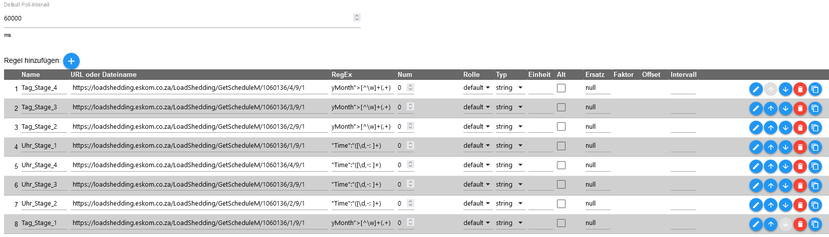

            @joergh said in Daten aus Webseite ziehen:

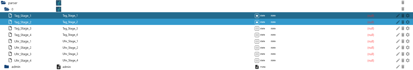

            @homoran @OliverIO Ok, jetzt habe ich die Daten ziehen können und bekomme auch ein Ergebnis angezeigt, wenn ich das Ganze in den Einstellungen teste.
            Er legt die DP an, aber diese bleiben leider leer, obwohl er zuvor in den Einstellungen den String als Ergebnis angezeigt hat...?
            Woran liegt das nun wieder?
            Die Einstellungen sehen so aus:

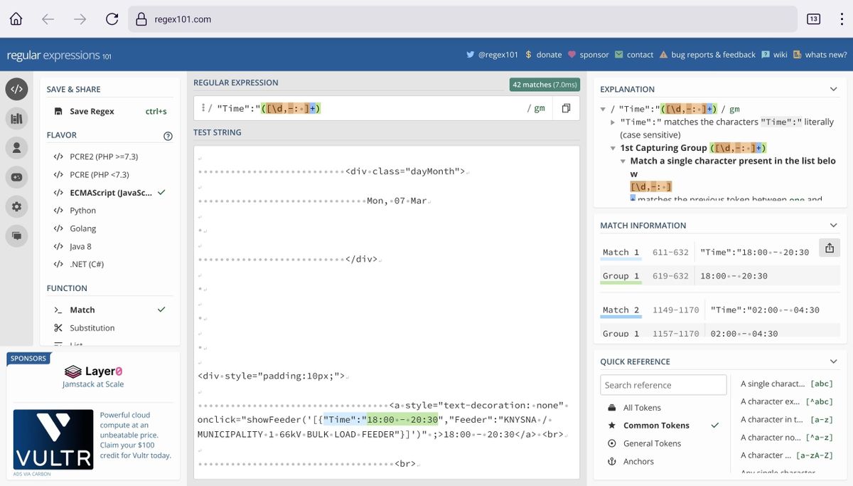

            In Regex gibt es Optionen, die man leider so direkt im iobroker nicht angeben kann.
            Im Parser-Adapter gibt es eine Logik, die diese ermittelt und leider je nach Suche ist die immer etwas anders.
            wenn man in Regex die Optionen auf /gs einstellt, dann stimmt die dortige Suche mit dem Ergebnis im Parseradapter überein. Leider gibt es mit dem Pattern von Homoran alles ab Fundstelle bis zum Ende zurück. Das kann sein, das das der Parseradapter nicht macht und deswegen dein Alternativwert (null) ausgibt.
            Probiere es einmal mit diesem
            yMonth">\s+([\w, ]+)
            Das Pattern mit Time müsste so passen.

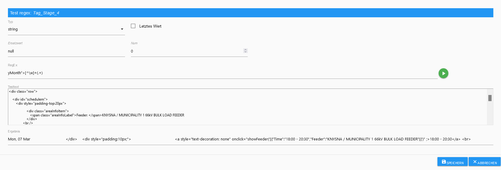

              #23
              @oliverio sagte in Daten aus Webseite ziehen:
              gab!
              habe es inzwischen angepasst und es läuft erfolgreich:
              @joergh sagte in Daten aus Webseite ziehen:
              @homoran sagte in Daten aus Webseite ziehen:
              @joergh Versuch mal yMonth">[^\S]+(\S+ \d+ \S+)
              was ist mit dem Datum?
              Danke. Damit bekomme ich den Tag schon einmal perfekt ausgeschnitten
