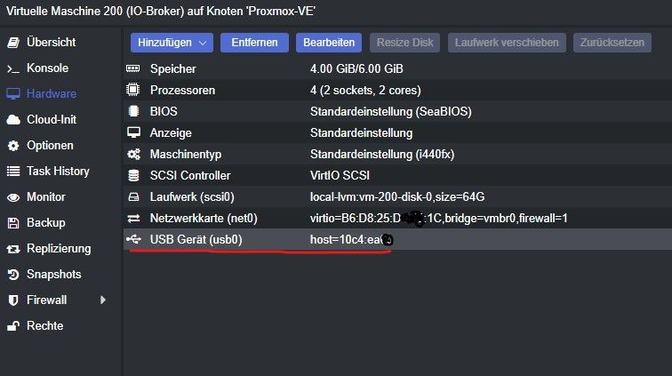

    Den Stick habe ich im Proxmox an die VM durchgereicht:
    Er wird in der VM auch gefunden:

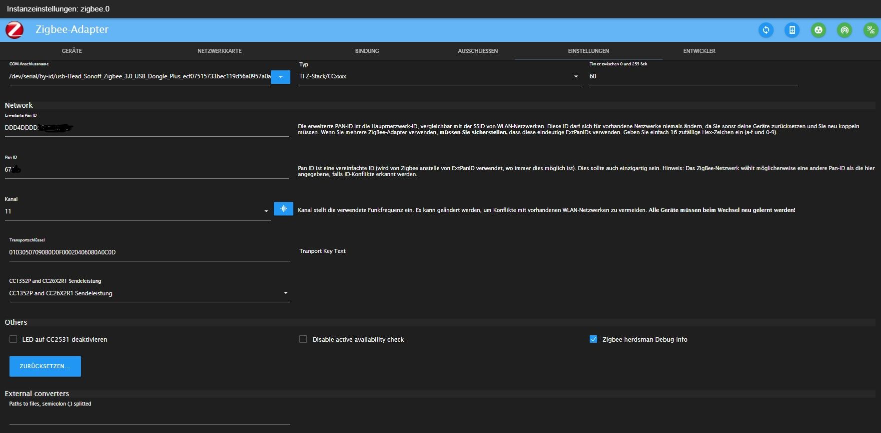

    Die Einstellungen im Zigbee-Adapter habe ich wie folgt gesetzt:

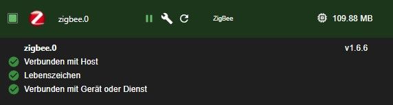

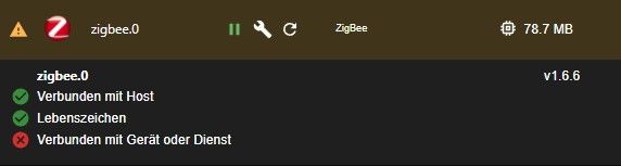

    Der Adaper startet auch, er verbindet sich jedoch nicht:
    Im Log kommen folgende Meldungen:
      zigbee.0
      2022-01-21 19:48:27.979	error	Error herdsman start
      zigbee.0
      2022-01-21 19:48:27.979	error	Failed to start Zigbee
      zigbee.0
      zigbee.0
      zigbee.0
      2022-01-21 19:48:27.978	error	Starting zigbee-herdsman problem : "Error while opening serialport 'Error: Error Resource temporarily unavailable Cannot lock port'"
      zigbee.0
      2022-01-21 19:48:27.769	info	Installed Version: iobroker.zigbee@1.6.6
      zigbee.0
      2022-01-21 19:48:27.757	info	Starting Zigbee npm ...
      zigbee.0
      2022-01-21 19:48:27.756	info	Try to reconnect. 1 attempts left
      zigbee.0
      2022-01-21 19:48:17.754	error	Error herdsman start
      zigbee.0
      2022-01-21 19:48:17.754	error	Failed to start Zigbee
      zigbee.0
      2022-01-21 19:48:17.753	error	Starting zigbee-herdsman problem : "startup failed - configuration-adapter mismatch - see logs above for more information"
      zigbee.0
      2022-01-21 19:48:17.657	error	Re-commissioning your network will require re-pairing of all devices!
      zigbee.0
      2022-01-21 19:48:17.657	error	If you wish to re-commission your network, please remove coordinator backup at /opt/iobroker/iobroker-data/zigbee_0/nvbackup.json.
      zigbee.0
      2022-01-21 19:48:17.657	error	Please update configuration to prevent further issues.
      zigbee.0
      2022-01-21 19:48:17.656	error	- Channel List: configured=11, adapter=11
      zigbee.0
      2022-01-21 19:48:17.656	error	- Network Key: configured=01030507090b0d0f00020406080a0c0d, adapter=01030507090b0d0f00020406080a0c0d
      zigbee.0
      2022-01-21 19:48:17.655	error	- Extended PAN ID: configured=dd2ddd5dddddd4dd, adapter=00124b0024cae298
      zigbee.0
      2022-01-21 19:48:17.655	error	- PAN ID: configured=6746, adapter=6746
      zigbee.0
      2022-01-21 19:48:17.654	error	Configuration is not consistent with adapter state/backup!
      zigbee.0
      2022-01-21 19:48:17.487	info	Installed Version: iobroker.zigbee@1.6.6
      zigbee.0
      2022-01-21 19:48:17.167	info	Starting Zigbee npm ...
      zigbee.0
      2022-01-21 19:48:17.105	info	starting. Version 1.6.6 in /opt/iobroker/node_modules/iobroker.zigbee, node: v12.22.9, js-controller: 3.3.22

        @freundernacht sagte in Fehler Sonoff Zigbee Stick Zigbee Adapter -> Proxmox VM:
        Muss übereinstimmen. Im Adapter anpassen.

          @freundernacht probier doch mal in der Instanz Einstellung, den Com Anschlussname aus dem Auswahlmenü, anstatt manuell rein zu schreiben
          FreunderNachtF Offline
          FreunderNacht
          @crunchip
          Hab ich auch schon versucht das selbe Ergebnis.

            Er wurde aber soweit installiert.

            @freundernacht Lesen bildet:
            zigbee.0
            zigbee.0
            zigbee.0
            zigbee.0
            zigbee.0
            zigbee.0
            zigbee.0
            zigbee.0
            Da steht genau was nicht ok ist. Manchmal frage ich mich echt warum wir das ins Log schreiben (lassen), wenn es doch keiner liest.
            Du musst entweder 98e2ca24004b1200 als ExtPanId eintragen oder deine Shepherd.db und nvbackup.json (in /opt/iobroker/iobroker-data/zigbee_0) löschen (und alle Geräte neu anlernen)
            A.

              das war es.
              Manchmal sieht man den Wald vor lauter Bäumen nicht mehr.
              Ich hatte gelesen, das die PAN ID frei vergeben werden kann.
              Tut mir leid, hätte ich wirklich selbst sehen können.
              Vielen Dank

                @freundernacht Kann sie ja auch. Aber dann müssen alle Kommunikationspartner auch diese Information haben.
                (War übrigens die Extended PAN-ID, die PAN-ID passte bei dir)
                  Kann sie. Allerdings kann (wird) es passieren das wenn die PanID und/oder ExtPanID geändert wird nachdem der Adapter schon einmal gestartet war der Adapter nicht durchstartet - wegen eines Konfigurationsmismatch. Dieses ist eine Absicherung dagegen das aus versehen die Konfiguration geändert wird und danach das Zigbee Netzwerk neu aufgebaut werden muss.
                  Deswegen auch dieser lange Text, wo halt drin steht:
                  entweder Datei /opt/iobroker/iobroker-data/zigbee_0/nvbackup.json löschen oder die unter "adapter" stehenden Werte von Channel, PanID und extPanID in die Konfiguration übernehmen.
                    FreunderNacht
                    @thomas-braun
                    Sorry, meinte doch die Extended PAN ID.
                    Ich hatte noch nichts angelernt, der Adapter war quasi noch jungfräulich.
                    Wie mache ich denn den in so einem Falle die Extended PAN ID den anderen Kommunikationspartner bekannt.
                    Wären ja in diesem Falle nur der Adapter und der Zigbee Stick, oder?
                    Ich habe angenommen, dass ich die Extended PAN ID die ich direkt nach der Installation im Adapter setze automatisch auch vom Stick übernommen wird.
                    Intel NUC mit Proxmox
                    IO Broker (Homematic IP / CCU3 / Shelly / Tasmota / Zigbee)
                    Influx DB
                    Grafana
                    PiHole
                    PiVPN
                    • FreunderNachtF FreunderNacht
                      @thomas-braun
                      AsgothianA Offline
                      AsgothianA Offline
                      Asgothian
                      @freundernacht um die ExtPanID zu setzen musst du den Adapter starten. Damit wird diese auch auf das Netzwerk angewandt. Deswegen der Hinweis zum löschen der Datei. Wenn nichts angelernt ist ist das of die einfachere Wahl.
                      Löschen der Datei lohnt natürlich nur nachdem der Adapter angehalten wurde.
                      A.
                      • AsgothianA Asgothian
                        Das der Wert den ich Dir genannt hab anders aussieht liegt daran das die im Log stehende ExtPanID "reversed" ausgegeben wird, sprich byteweise vertauscht. Wenn du also die beiden Werte vergleichst (00124b0024cae298 und 98e2ca24004b1200) sollte klar sein was gemeint ist.
                        A.
                        FreunderNacht
                        @asgothian
                        Vielen Dank für die ausführliche Antwort, das hat mir sehr geholfen.
                        Nach dem Stoppen des Adapters und dem löschen des Ordners:
                        Hats dann beim erneuten starten funktioniert.
                        Ich hatte ja eh noch keine Geräte angelernt.
                          zigbee.0
                          zigbee.0
                          zigbee.0
                          zigbee.0
                          zigbee.0
                          zigbee.0
                          zigbee.0
                          zigbee.0
