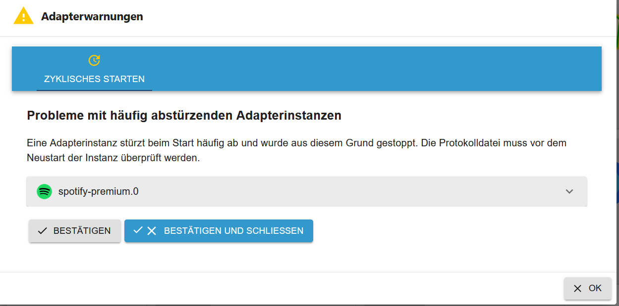

    Hallo Zusammen,
    ich konnte den Spotify Adapter eigentlich erfolgreich installieren...(grüne Instanz), aber nach einer Weile wenn ich wieder aufs Webinterface gehe kommt die Absturzmeldung :-( was läuft da falsch?
    Über ne Info was ich da machen kann wäre ich Euch sehr dankbar.

      @kusselin
      Was steht denn in der genannten Protokolldatei?

                          @thomas-braun
                          2021-12-02 09:47:20.635  - error: spotify-premium.0 (21759) spotify status polling stopped with error Error: getaddrinfo EAI_AGAIN api.spotify.com
                          021-12-02 11:04:24.783  - info: spotify-premium.0 (21759) State value to set for "spotify-premium.0.player.playlist.tracksTotal" has to be type "string" but received type "number"
                          2021-12-02 11:04:24.935  - error: spotify-premium.0 (21759) uncaught exception: Cannot read property 'name' of undefined
                          2021-12-02 11:04:24.936  - error: spotify-premium.0 (21759) TypeError: Cannot read property 'name' of undefined
                              at Object.listenOnHtmlTracklist [as func] (/opt/iobroker/node_modules/iobroker.spotify-premium/main.js:2035:33)
                              at /opt/iobroker/node_modules/iobroker.spotify-premium/lib/cache.js:229:19
                              at Array.forEach (<anonymous>)
                              at trigger (/opt/iobroker/node_modules/iobroker.spotify-premium/lib/cache.js:223:14)
                              at Object.setExternal (/opt/iobroker/node_modules/iobroker.spotify-premium/lib/cache.js:262:5)
                              at Object.stateChange (/opt/iobroker/node_modules/iobroker.spotify-premium/main.js:56:43)
                              at Immediate.<anonymous> (/opt/iobroker/node_modules/iobroker.js-controller/lib/adapter.js:5706:41)
                              at processImmediate (internal/timers.js:461:21)
                          2021-12-02 11:04:24.936  - error: spotify-premium.0 (21759) Cannot read property 'name' of undefined
                          2021-12-02 11:04:24.984  - info: spotify-premium.0 (21759) State value to set for "spotify-premium.0.player.playlist.trackNo" has to be type "number" but received type "string"
                          2021-12-02 11:04:24.991  - info: spotify-premium.0 (21759) terminating
                          2021-12-02 11:04:24.991  - warn: spotify-premium.0 (21759) Terminated (UNCAUGHT_EXCEPTION): Without reason
                          2021-12-02 11:04:25.564  - error: host.iobroker-live instance system.adapter.spotify-premium.0 terminated with code 6 (UNCAUGHT_EXCEPTION)
                          2021-12-02 11:04:25.566  - info: host.iobroker-live Restart adapter system.adapter.spotify-premium.0 because enabled
                          2021-12-02 11:04:55.591  - info: host.iobroker-live instance system.adapter.spotify-premium.0 started with pid 326
                          2021-12-02 11:04:56.716  - info: spotify-premium.0 (326) starting. Version 1.1.3 in /opt/iobroker/node_modules/iobroker.spotify-premium, node: v12.22.6, js-controller: 3.3.21
                          2021-12-02 11:04:57.504  - error: spotify-premium.0 (326) Unhandled promise rejection. This error originated either by throwing inside of an async function without a catch block, or by rejecting a promise which was not handled with .catch().
                          2021-12-02 11:04:57.504  - error: spotify-premium.0 (326) unhandled promise rejection: Cannot read property 'name' of undefined
                          2021-12-02 11:04:57.505  - error: spotify-premium.0 (326) TypeError: Cannot read property 'name' of undefined
                              at Object.setValue (/opt/iobroker/node_modules/iobroker.spotify-premium/lib/cache.js:213:13)
                              at copyState (/opt/iobroker/node_modules/iobroker.spotify-premium/main.js:435:18)
                              at /opt/iobroker/node_modules/iobroker.spotify-premium/main.js:666:37
                          2021-12-02 11:04:57.505  - error: spotify-premium.0 (326) Cannot read property 'name' of undefined
                          2021-12-02 11:04:57.509  - info: spotify-premium.0 (326) State value to set for "spotify-premium.0.player.playlist.trackNo" has to be type "number" but received type "string"
                          2021-12-02 11:04:57.516  - info: spotify-premium.0 (326) terminating
                          2021-12-02 11:04:57.517  - warn: spotify-premium.0 (326) Terminated (UNCAUGHT_EXCEPTION): Without reason
                          2021-12-02 11:04:58.115  - error: host.iobroker-live instance system.adapter.spotify-premium.0 terminated with code 6 (UNCAUGHT_EXCEPTION)
                          2021-12-02 11:04:58.116  - info: host.iobroker-live Restart adapter system.adapter.spotify-premium.0 because enabled
                            @kusselin
                            Ich kann da nix draus erkennen. Aber ich kann auch kein javascript.
                            KusselinK 1 Antwort Letzte Antwort
