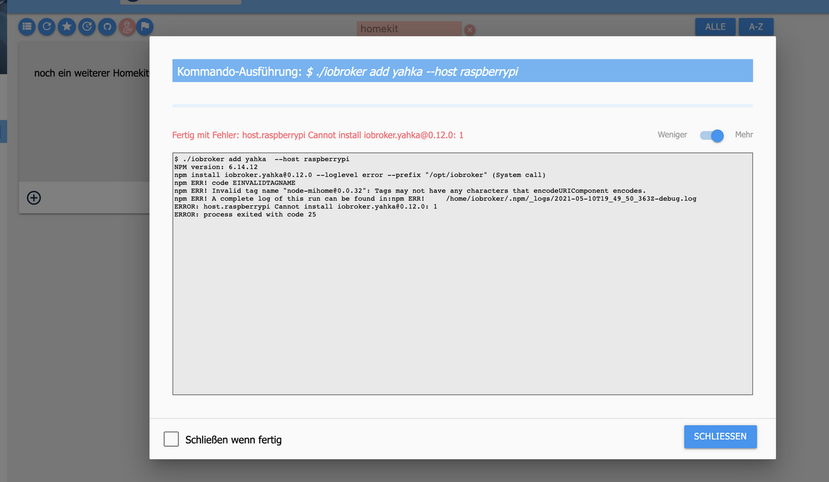

      Liebe Community,
      leider bekomme ich beim installieren des Homekit-Adapter folgenden Fehler:
      Wie lässt sich das beheben? Danke euch!
      LG
      Thomas Braun 1 Reply Last reply Reply Quote -1

          @thomas-braun ```
          $ ./iobroker add yahka --host raspberrypi
          NPM version: 6.14.12
          npm install iobroker.yahka@0.12.0 --loglevel error --prefix "/opt/iobroker" (System call)
          npm
          ERR! code EINVALIDTAGNAME
          npm
          ERR! Invalid tag name "node-mihome@0.0.32": Tags may not have any characters that encodeURIComponent encodes.
          npm ERR! A complete log of this run can be found in:npm ERR! /home/iobroker/.npm/_logs/2021-05-10T20_30_14_074Z-debug.log
          ERROR: host.raspberrypi Cannot install iobroker.yahka@0.12.0: 1
          ERROR: process exited with code 25

                                          npm install iobroker.telegram@1.8.1 --loglevel error --prefix "/opt/iobroker" (System call)
                                          npm ERR! code EINVALIDTAGNAME
                                          npm ERR! Invalid tag name "node-mihome@0.0.32": Tags may not have any characters that encodeURIComponent encodes.

                                          npm install iobroker.tr-064@4.2.12 --loglevel error --prefix "/opt/iobroker" (System call)
