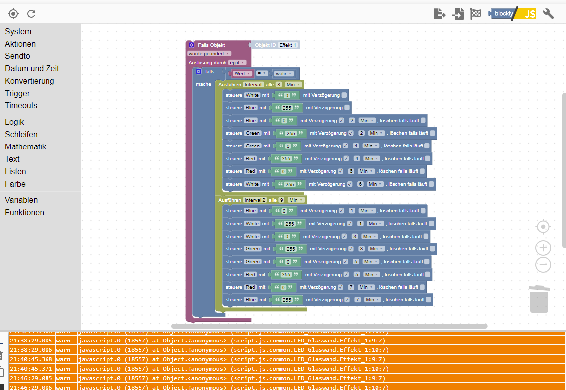

    Hallo Zusammen
    Kann mir jemand sagen wieso ich ein WARN bekomme?
    Eigentlich macht das Skript was ich will.
    Sind 2 LED Spripe mit RGBW die immer wider die Farbe wechseln.
    Schönen Abend Stefan

      Zeig mal das "richtige Log"
      Text statt Zahlen ?

        code_text
        `javascript.0	2021-04-28 23:56:45.379	warn	(18557) at processTimers (internal/timers.js:497:7)
        javascript.0	2021-04-28 23:56:45.379	warn	(18557) at listOnTimeout (internal/timers.js:554:17)
        javascript.0	2021-04-28 23:56:45.379	warn	(18557) at Timeout._onTimeout (/opt/iobroker/node_modules/iobroker.javascript/lib/sandbox.js:2073:34)
        javascript.0	2021-04-28 23:56:45.378	warn	(18557) at Object.<anonymous> (script.js.common.LED_Glaswand.Effekt_1:10:7)
        javascript.0	2021-04-28 23:56:45.378	warn	(18557) at setState (/opt/iobroker/node_modules/iobroker.javascript/lib/sandbox.js:1427:20)
        javascript.0	2021-04-28 23:56:45.375	warn	(18557) You are assigning a string to the state "shelly.0.SHRGBW2#0111DC#1.lights.blue" which expects a number. Please fix your code to use a number or change the state type to string. This warning mi
        javascript.0	2021-04-28 23:56:45.375	warn	(18557) at processTimers (internal/timers.js:497:7)
        javascript.0	2021-04-28 23:56:45.375	warn	(18557) at listOnTimeout (internal/timers.js:554:17)
        javascript.0	2021-04-28 23:56:45.375	warn	(18557) at Timeout._onTimeout (/opt/iobroker/node_modules/iobroker.javascript/lib/sandbox.js:2073:34)
        javascript.0	2021-04-28 23:56:45.374	warn	(18557) at Object.<anonymous> (script.js.common.LED_Glaswand.Effekt_1:9:7)
        javascript.0	2021-04-28 23:56:45.374	warn	(18557) at setState (/opt/iobroker/node_modules/iobroker.javascript/lib/sandbox.js:1427:20)
        javascript.0	2021-04-28 23:56:45.371	warn	(18557) You are assigning a string to the state "shelly.0.SHRGBW2#0111DC#1.lights.white" which expects a number. Please fix your code to use a number or change the state type to string. This warning m
        javascript.0	2021-04-28 23:56:45.341	warn	(18557) at processTimers (internal/timers.js:497:7)
        javascript.0	2021-04-28 23:56:45.341	warn	(18557) at listOnTimeout (internal/timers.js:556:17)
        javascript.0	2021-04-28 23:56:45.340	warn	(18557) at Timeout._onTimeout (/opt/iobroker/node_modules/iobroker.javascript/lib/sandbox.js:1485:29)
        javascript.0	2021-04-28 23:56:45.340	warn	(18557) at Object.setState (/opt/iobroker/node_modules/iobroker.javascript/lib/sandbox.js:1427:20)
        javascript.0	2021-04-28 23:56:45.337	warn	(18557) You are assigning a string to the state "shelly.0.SHRGBW2#0113F7#1.lights.blue" which expects a number. Please fix your code to use a number or change the state type to string. This warning mi
        javascript.0	2021-04-28 23:56:45.336	warn	(18557) at processTimers (internal/timers.js:497:7)``

          @bumm
          Zahlen anstelle von Text verwenden und die Intervalle im sonst-Zweig der Abfrage stoppen.

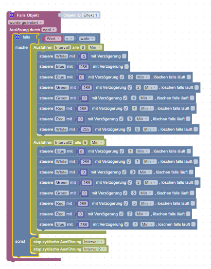

            @paul53 Hallo Paul
            Ist das so gemeint?
            Danke für deine Hilfe.

              @bumm sagte: Ist das so gemeint?
              Ja.
