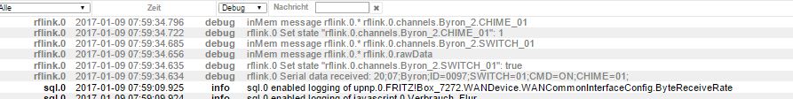

              Marcolotti
              Guten Morgen,
              die Log zeigt mir folgendes:
              rflink.0	2017-01-09 07:53:37.325	debug	inMem message rflink.0.* rflink.0.channels.Byron_2.CHIME_01
              rflink.0	2017-01-09 07:53:37.246	debug	rflink.0 Set state "rflink.0.channels.Byron_2.CHIME_01": 1
              rflink.0	2017-01-09 07:53:37.243	debug	inMem message rflink.0.* rflink.0.channels.Byron_2.SWITCH_01
              rflink.0	2017-01-09 07:53:37.198	debug	inMem message rflink.0.* rflink.0.rawData
              rflink.0	2017-01-09 07:53:37.177	debug	rflink.0 Set state "rflink.0.channels.Byron_2.SWITCH_01": true
              rflink.0	2017-01-09 07:53:37.176	debug	rflink.0 Serial data received: 20;05;Byron;ID=0097;SWITCH=01;CMD=ON;CHIME=01;
              Wenn ich 20;05;Byron;ID=0097;SWITCH=01;CMD=ON;CHIME=01; ins RawData kopiere und ausführe dann kommt:
              rflink.0	2017-01-09 08:00:09.252	debug	stateChange rflink.0.rawData {"val":"20;07;Byron;ID=0097;SWITCH=01;CMD=ON;CHIME=01;","ack":false,"ts":1483945209223,"q":0,"from":"system.adapter.admin.0","lc":1483945209223}
              inMem	2017-01-09 08:00:09.248	debug	message rflink.0.* rflink.0.rawData val=20;07;Byron;ID=0097;SWITCH=01;CMD=ON;CHIME=01;, ack=false, ts=1483945209223, q=0, from=system.adapter.admin.0, lc=1483945209223
              Gruß Marco
              CCU2-CuxD&Cul868MHz, 44xHM Geräte, 20xMAX Fenstersensoren.Acer Revo mit IoBroker, Tablet Captiva 9,7 SFHD. SMA SB2.5,STP7000TL20,SMA Energy Meter, Echo, Harmony, JeeLink868, Arduino 433MHz, MaxtoxCUL868,MilightEasyLED,Hue
