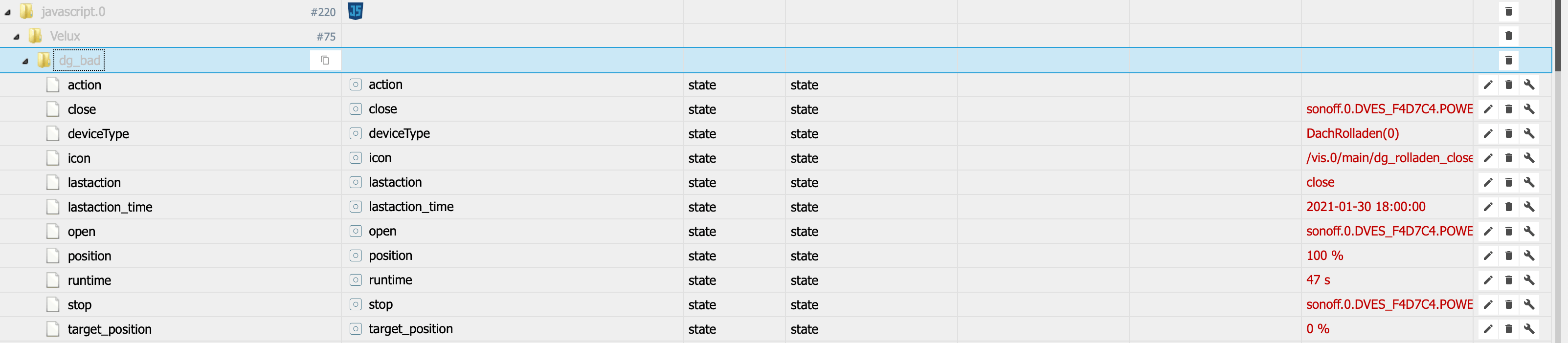

    function createRolladen(name){
        createState("javascript.0.Velux."+name+".position", "", {
            "name": "position",
            "role": "",
            "type": "number",
            "desc": "Position des Rolladen in % (0% ist offen).",
            "unit": "%",
            "min": 0,
            "max": 100,
            "def": 0,
            "read": true,
            "write": true
        console.log("Objekt close für Rolladen "+name+" erstellt.");
        createState("javascript.0.Velux."+name+".target_position", "", {
            "name": "target_position",
            "role": "",
            "type": "number",
            "desc": "Wunsch-Position des Rolladen in % (0% ist offen).",
            "unit": "%",
            "min": -1,
            "max": 100,
            "def": 0,
            "read": true,
            "write": true
        console.log("Objekt target_position für Rolladen "+name+" erstellt.");
        createState("javascript.0.Velux."+name+".runtime", 0, {
            "name": "runtime",
            "role": "",
            "type": "number",
            "desc": "Gibt in Sekunden an wie lange der Rolladen für einen kompletten Lauf benötigt ",
            "unit": "s",
            "min": 0,
            "max": 1000,
            "def": 15,
            "read": true,
            "write": true
        console.log("Objekt runtime für Rolladen "+name+" erstellt.");
        createState("javascript.0.Velux."+name+".icon", "",  {
            "name": "icon",
            "role": "",
            "type": "string",
            "desc": "Speichert den Icon-Namen zur Position.",
            "def": "open",
            "read": true,
            "write": true
        console.log("Objekt icon für Rolladen "+name+" erstellt.");
        // Hier muss noch geprüft werden, was sein Problem mit dem Type in Common ist...
        createState("javascript.0.Velux."+name+".deviceType", 0,  {
            "name": "deviceType",
            "role": "",
            "type": "state",
            "def": 0,
            "read": true,
            "write": true,
            "states": {
                0: "DachRolladen",
                1: "FensterRolladen",
                2: "Fenster"
        console.log("Objekt deviceType für Device "+name+" erstellt.");
        createState("javascript.0.Velux."+name+".open", "", {
            "name": "open",
            "role": "",
            "type": "string",
            "desc": "Speichert den Pfad zum Objekt für die Aktion: open.",
            "def": "",
            "read": true,
            "write": true
        console.log("Objekt open für Rolladen "+name+" erstellt.");
        createState("javascript.0.Velux."+name+".stop", "", {
            "name": "stop",
            "role": "",
            "type": "string",
            "desc": "Speichert den Pfad zum Objekt für die Aktion: stop.",
            "def": "",
            "read": true,
            "write": true
        console.log("Objekt stop für Rolladen "+name+" erstellt.");
        createState("javascript.0.Velux."+name+".close", "", {
            "name": "close",
            "role": "",
            "type": "string",
            "desc": "Speichert den Pfad zum Objekt für die Aktion: close.",
            "def": "",
            "read": true,
            "write": true
        createState("javascript.0.Velux."+name+".reed", "", {
            "name": "reed",
            "role": "",
            "type": "string",
            "desc": "Speichert den Pfad zum Objekt für den reed-Kontakt.",
            "def": "",
            "read": true,
            "write": true
        console.log("Objekt reed für Rolladen "+name+" erstellt.");
        createState("javascript.0.Velux."+name+".action", "", {
            "name": "action",
            "role": "",
            "type": "string",
            "desc": "Befehl an den Rolladen.",
            "def": false,
            "read": true,
            "write": true
        console.log("Objekt action für Rolladen "+name+" erstellt.");
        createState("javascript.0.Velux."+name+".lastaction", "", {
            "name": "lastaction",
            "role": "",
            "type": "string",
            "desc": "Letzter Befehl an den Rolladen.",
            "def": "",
            "read": true,
            "write": true
        console.log("Objekt lastaction für Rolladen "+name+" erstellt.");
        createState("javascript.0.Velux."+name+".lastaction_time", "", {
            "name": "lastaction_time",
            "role": "",
            "type": "string",
            "desc": "Zeitpunkt der letzten Änderung.",
            "def": "",
            "read": true,
            "write": true
        console.log("Objekt lastaction_time für Rolladen "+name+" erstellt.");

      Hallo Zusammen,
      ich hatte mal Bock was mit einem NodeMCU zusammen zu bauen und habe es zum Anlass genommen endlich mal meine Velux-Rolläden in meinen ioBroker zu integrieren. Und zwar ohne mich von Velux weiter veräppeln zu lassen mit KLF-200-Firmware-Updates oder irgendwelchen teueren nicht-smarten INTEGRA-Produkten.
      Dazu habe ich 3x Relais-Boards mit drei I/O-Extension-Boards an einen NodeMCU angeschlossen (~40EUR).
      Die 8 INTEGRA Fernbedienungen habe ich gestapelt und an die Relais angeschlossen. Versorgt werden sie über den 3V Ausgang vom NodeMCU. Versorgt wird das Ganze über ein USB Ladegerät.
      Ich nennen das Projekt F**K-YOU-VELUX-Stack.
      Die Einbindung habe ich über Tasmota gemacht, eine großartige Firmware. Erkennt automatisch die I/O-Extensions und stellt jeden Kontakt als MQTT zur Verfügung.
      Macht richtig Spaß dem Klackern der Relais zu lauschen. :-D
      VG Tristan

      Schöne Lösung! Ich habe dasselbe direkt an einem Raspberry Pi gemacht (I2C Adapter, PCF8574 und 16x Relais Karte).
                "role": "",
                "type": "state",
                "def": 0,
                "read": true,
                "write": true,
                "states": {
                    0: "DachRolladen",
                    2: "Fenster"
                "name": "open",
                "role": "",
                "type": "string",
                "def": "",
                "read": true,
                "write": true
                "name": "stop",
                "role": "",
                "type": "string",
                "def": "",
                "read": true,
                "write": true
                "name": "close",
                "role": "",
                "type": "string",
                "def": "",
                "read": true,
                "write": true
                "name": "reed",
                "role": "",
                "type": "string",
                "def": "",
                "read": true,
                "write": true
                "name": "action",
                "role": "",
                "type": "string",
                "def": false,
                "read": true,
                "write": true
                "role": "",
                "type": "string",
                "def": "",
                "read": true,
                "write": true
                "role": "",
                "type": "string",
                "def": "",
                "read": true,
                "write": true
