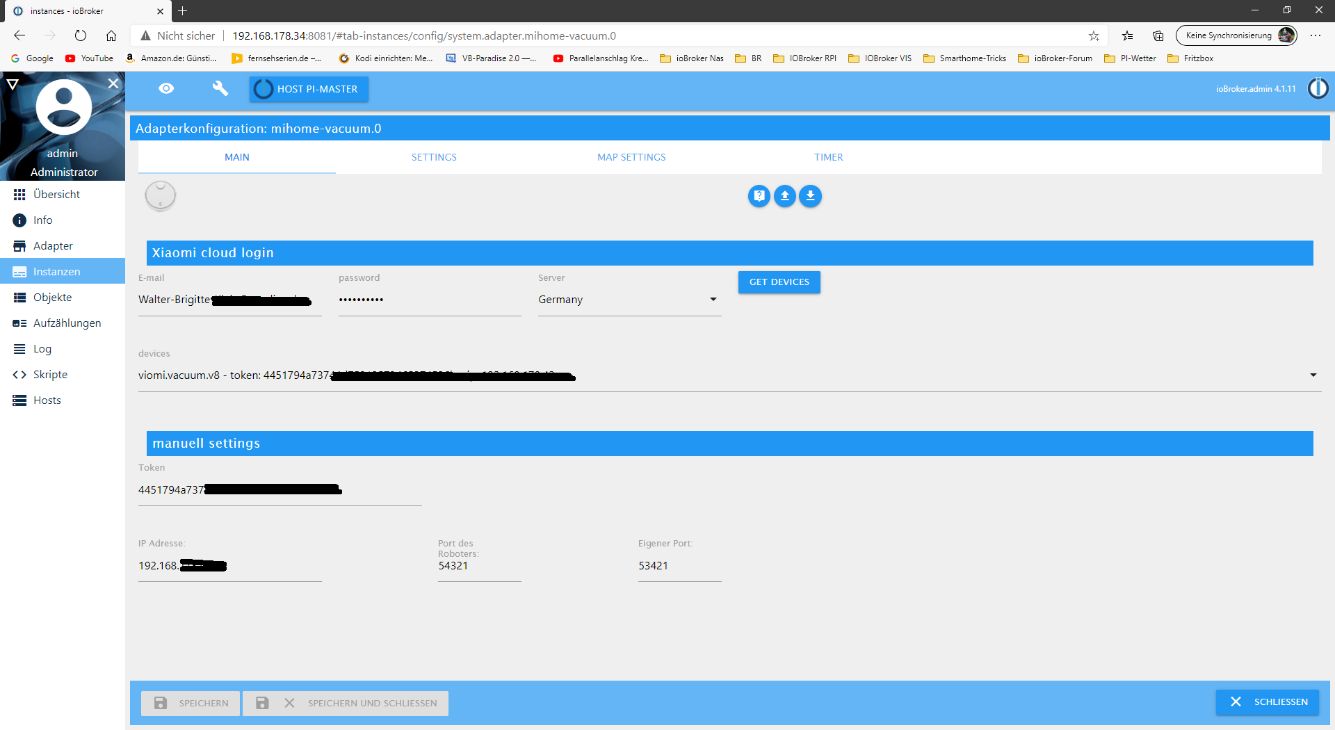

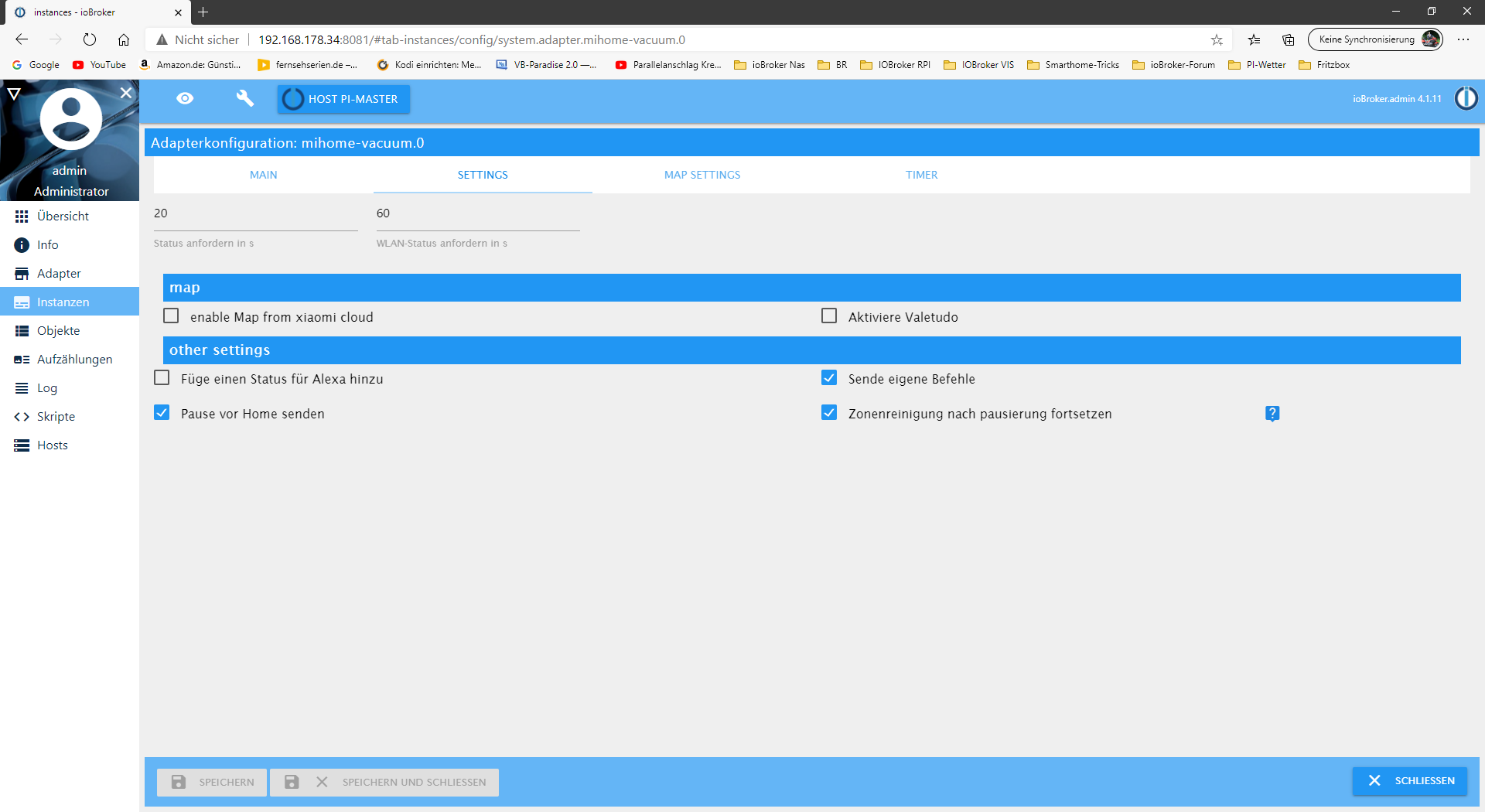

                noch ein Versuch um Hilfe!
                Es geht um den "Xiaomi Mi Robot Vacuum Mop Pro Saugroboter mit Wischfunktion" in Verbindung mit dem "mihome-vacuum" Adapter.
                Hier die Einstellungen:
                Instanz auf debug und folgender Log-Auszug:

                mihome-vacuum.0	2021-01-06 08:13:36.185	debug	(6023) Receive <<< Helo <<< 2131002000000000165d849b5ff5631fffffffffffffffffffffffffffffffff
                mihome-vacuum.0	2021-01-06 08:13:36.153	debug	(6023) No suitable Lua script, fallback to keys!: function(doc) { if (doc.type === 'state') emit(doc._id, doc) }
                mihome-vacuum.0	2021-01-06 08:13:36.114	debug	(6023) server started on 0.0.0.0:53421
                mihome-vacuum.0	2021-01-06 08:13:36.096	info	(6023) Cloud control disabled
                mihome-vacuum.0	2021-01-06 08:13:36.094	info	(6023) Expert mode enabled, states created
                mihome-vacuum.0	2021-01-06 08:13:36.027	info	(6023) starting. Version 2.2.4 in /opt/iobroker/node_modules/iobroker.mihome-vacuum, node: v12.20.0, js-controller: 3.1.6
                host.PI-Master	2021-01-06 08:13:33.338	info	instance system.adapter.mihome-vacuum.0 started with pid 6023
                host.PI-Master	2021-01-06 08:13:30.860	info	instance system.adapter.mihome-vacuum.0 terminated with code 11 (ADAPTER_REQUESTED_TERMINATION)
                mihome-vacuum.0	2021-01-06 08:13:30.305	info	(29044) Terminated (ADAPTER_REQUESTED_TERMINATION): Without reason
                mihome-vacuum.0	2021-01-06 08:13:30.304	info	(29044) terminating
                mihome-vacuum.0	2021-01-06 08:13:30.301	info	(29044) Got terminate signal TERMINATE_YOURSELF
                host.PI-Master	2021-01-06 08:13:30.296	info	stopInstance system.adapter.mihome-vacuum.0 send kill signal
                host.PI-Master	2021-01-06 08:13:30.290	info	stopInstance system.adapter.mihome-vacuum.0 (force=false, process=true)
                mihome-vacuum.0	2021-01-06 08:13:24.518	info	(29044) connecting, this can take up to 10 minutes ...
                mihome-vacuum.0	2021-01-06 08:13:04.507	info	(29044) connecting, this can take up to 10 minutes ...
                mihome-vacuum.0	2021-01-06 08:12:44.607	info	(29044) connecting, this can take up to 10 minutes ...
                Was mache ich falsch???
                Danke im voraus.
                Wastl
                596
