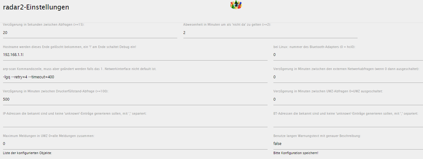

    Neuerdings bleibt mein Radar2 Adapter rot?
    Im Bereich Hostname habe ich schon verschiedene Varianten für die Fritzbox probiert
    Off Topic: Ist Radar2 die "schnelleste" und "zuverlässigste" Anwendung für die Überprüfung von
    Online Zuständen von Devices
    Hier die Logdatei von Radar2:
    radar2.0	2020-12-03 09:50:31.437	info	(3781) radar2 set to scan every 20 seconds and printers every 500 minutes.
    radar2.0	2020-12-03 09:50:31.437	info	(3781) arp-scan will use the following interfaces: [ 'eth0' ]
    radar2.0	2020-12-03 09:50:31.436	info	(3781) Remove name end for host names: 192.168.1.1
    radar2.0	2020-12-03 09:50:31.436	info	(3781) use known IP list: []
    radar2.0	2020-12-03 09:50:31.436	info	(3781) use known BT list: []
    radar2.0	2020-12-03 09:50:31.435	info	(3781) Debug mode set by adapter config ('!' as last letter in removeEnd)!
    radar2.0	2020-12-03 09:50:31.435	info	(3781) radar2 set to flag items away if they are not seen for 2 minutes
    radar2.0	2020-12-03 09:50:31.435	warn	(3781) node-bluetooth not found!
    radar2.0	2020-12-03 09:50:31.430	warn	(3781) Noble not available, Error: Error: The module '/opt/iobroker/node_modules/@abandonware/bluetooth-hci-socket/lib/binding/binding.node'was compiled against a different Node.js version usingNODE_M
    radar2.0	2020-12-03 09:50:31.343	info	(3781) Adapter disconnected and stopped with dostop(false) and callback(true)
    radar2.0	2020-12-03 09:50:31.342	error	(3781) Error: bind EACCES 0.0.0.0:67 at dgram.js:338:20 at processTicksAndRejections (internal/process/task_queues.js:85:21)
    radar2.0	2020-12-03 09:50:31.341	error	(3781) uncaught exception: bind EACCES 0.0.0.0:67
