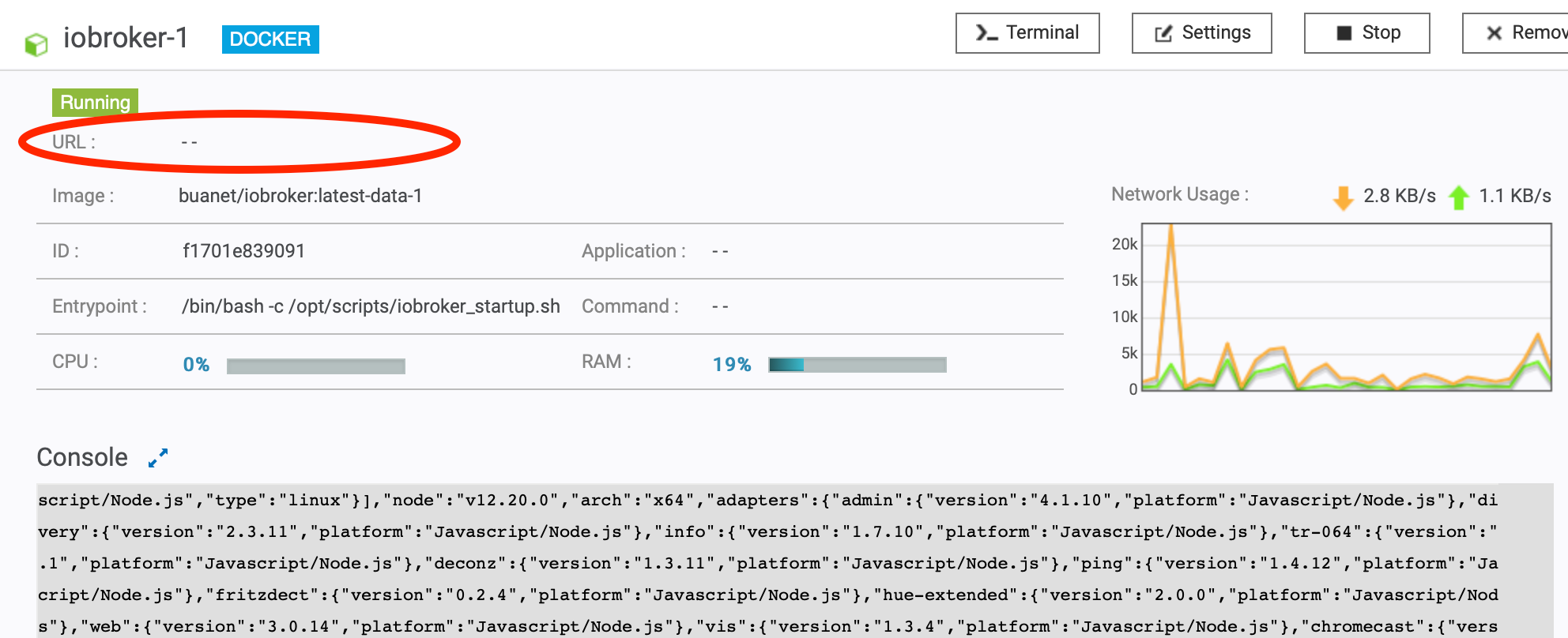

                      @AndiBee
                      Hallo Andi,
                      ich bekomme ioBroker nicht zum laufen, ich erreiche die WEB Gui einfach nicht, glaube ich hätte lieber eine sysnology kaufen sollen.
                      -----              Debugging information               -----
                      -----                      System                      -----
                      -----               arch:      x86_64                  -----
                      -----                     Versions                     -----
                      -----               image:     v5.1.0                  -----
                      -----               node:      v12.20.0                -----
                      -----               npm:       6.14.8                  -----
                      -----                       ENV                        -----
                      -----               SETGID:    1000                    -----
                      -----               SETUID:    1000                    -----
                      -----         Step 1 of 5: Preparing container         -----
                      Registering maintenance script as command.
                      Done.
                      -----   Step 2 of 5: Detecting ioBroker installation   -----
                      Existing installation of ioBroker detected in /opt/iobroker.
                      -----   Step 3 of 5: Checking ioBroker installation    -----
                      (Re)Setting folder permissions (This might take a while! Please be patient!)...
                      Done.
                      Fixing "sudo-bug" by replacing sudo in iobroker with gosu...
                      Done.
                      Hostname in ioBroker does not match the hostname of this container.
                      Updating hostname to  NAS40D3FF...
                      The host for instance "system.adapter.admin.0" was changed from "c33ae6495f03" to "NAS40D3FF".
                      The host for instance "system.adapter.discovery.0" was changed from "c33ae6495f03" to "NAS40D3FF".
                      The host for instance "system.adapter.info.0" was changed from "c33ae6495f03" to "NAS40D3FF".
                      Done.
                      -----      Step 4 of 5: Applying special settings      -----
                      Some adapters have special requirements/ settings which can be activated by the use of environment variables.
                      For more information take a look at readme.md on Github!
                      -----          Step 5 of 5: ioBroker startup           -----
                      Starting ioBroker...
                      host.NAS40D3FF check instance "system.adapter.admin.0" for host "NAS40D3FF"
                      host.NAS40D3FF check instance "system.adapter.discovery.0" for host "NAS40D3FF"
                      host.NAS40D3FF check instance "system.adapter.info.0" for host "NAS40D3FF"
                      Send diag info: {"uuid":"7abd3182-d399-f7bd-da19-9550d8babede","language":"","country":"","hosts":[{"version":"3.1.6","platform":"Javascript/Node.js","type":"linux"}],"node":"v12.20.0","arch":"x64","adapters":{"ad
                      min":{"version":"4.1.10","platform":"Javascript/Node.js"},"discovery":{"version":"2.3.11","platform":"Javascript/Node.js"},"info":{"version":"1.7.10","platform":"Javascript/Node.js"}},"statesType":"file","objectsT
                      ype":"file","model":"Intel(R) Celeron(R) J4025 CPU @ 2.00GHz","cpus":2,"mem":4022652928,"ostype":"Linux","city":""}
                      hash changed or no sources cached => force download of new sources
                      ================================== > LOG REDIRECT system.adapter.admin.0 => false [Process stopped]
                      ================================== > LOG REDIRECT system.adapter.admin.0 => false [system.adapter.admin.0.logging]
                      ...hier bliebt die Ausgabe in der Console stehen und es passiert nix mehr.
                      Hast Du wirklich nichts weiter gemacht? Habe das Netzwerk als Host eingerichtet und versuche die Web-Gui auf dem Standardport 8081 zu erreichen?
                      Habe mich zum ersten Mal mit dem Thema Smarthome beschäftigt, das QNAP ist neu und ich habe die fixe Idee meine HUE Lampen die an einer Hue Bridge hängen künftig über einen Conbee 2 Gateway zu verwalten. Bevor ich ioBroker ausprobieren wollte hat es mit Homeassistant fast problemlos funktioniert inclusive dem durchreichen des Conbee2 Sticks? Bevor ich mich auf HA festlege wollte ich Schin noch zumindest ioBroker probieren.
                      Es soll nicht bei den Lampen bleiben, ich möchte noch ALEXA, Heizungsthermostate und IKEA Fyrtur Rollos einbinden und alles über ein System konfigurieren
                      und steuern.
                      Gruss Diana

                                  dianaD Offline
                                  dianaD Offline
                                  diana
                                  schrieb am zuletzt editiert von diana
                                  @fastfoot
                                  beim erneuten ausrollen des Containers hatte sich in der GUI das Netzwerk verstellt, NAT statt Host, jetzt komme ich via Port 9081 auf die Admin GUI.
                                  In der Containerstation wird Überhaut keine URL angezeigt, das hat bisher nur beim Pi-Hole Container funktioiert. Irgendwas mache ich falsch mit den Doker Containern.
                                  Ich habe mich vorher noch nie damit beschäftigt, das QNAP hab ich seit einer Woche und bin am "basteln", weder mit Joker noch mit Smarthome, bisher hatte ich nur HUE mit HUE-Bridge und da ging alles automatisch was der Hersteller vorgesehen hat.
                                  Der conbee 2 Stick wird übrigens in den Container durchgereicht und die verbunden Testlampe funktioniert.
                                  erstes Fazit: Finde das ioBroker ein bisschen den Charm der 90er hat, Homeassistant ist schon in 2020 angekommen und dort mehr automatisch geht und das Dashboard schneller zusammen geklickt ist. VIS von iobroker ist noch ein Buch mit sieben Siegeln, muss wohl mal die Doku finden wie man da ein Dashboard zusammen stellt?
                                  Danke für die Unterstützung!
                                  Gruss Diana
                                  F 1 Antwort Letzte Antwort

                                    F Online
                                    F Online
                                    fastfoot
                                    @diana sagte in ioBroker Docker auf QNAP:
                                    @fastfoot
                                    Tja, kleine Sünden werden sofort bestraft :-)
                                    Ist hier auch so, ich meinte aber das Icon in der Übersicht, das wird mir im Hostmodus nicht angezeigt. Diesen brauchst du aber wohl damit der Conbee durchgereicht werden kann. Zur Verwaltung deiner Container empfehle ich Portainer(auch ein Container), die Verwaltung ist sonst fürn ....
                                    Ich habe nur Hue, reicht mir. Es gibt für Hue auch zwei Adapter, falls der Adapter für Conbee nicht das tut was du erwartest
                                    Unter der Haube werkelt da neueste Technologie, iobroker ist sehr flexibel, was für viele Leute wohl ein Grund war von HA zu wechseln, aber ich kenne den nicht. VIS entdecke ich gerade für mich, und was die sieben Siegel angeht, für mich sind es mehr :-) Immerhin kann ich jetzt Tabellen füllen und seit Neuestem auch eine Grafik erstellen, es gibt hier aber sehr schöne Visualisierungen zu bestaunen, da geht definitiv sehr viel. Zum Zusammenklicken ist das Alles nicht, für mich macht es aber genau das aus
                                    Gruss Diana
                                      @fastfoot
