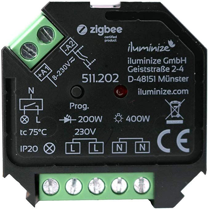

      @PeterPan sagte in Keine Zigbee-Kopplung zu iluminize 511.202:
      511.202 von iluminiz
      hast mal ein bild von dem teil
        Hallo arteck,
        er wurde gestern Abend noch als "unknown device" gefunden.
          Hallo arteck,
          zigbee.0 2019-12-05 19:21:05.115 error (21649) Cannot get the Node Descriptor of the Device: 0x00158d00025196a6 (Error: Timed out after 10000 ms)
          zigbee.0 2019-12-05 19:20:18.015 info (21649) Zigbee: allowing new devices to join.
          zigbee.0 2019-12-05 19:17:06.235 info (21649) new dev 0xec1bbdfffe7bba20 56406 511.202
          zigbee.0 2019-12-05 19:17:06.206 error (21649) Unknown device model 511.202 emit event readRsp with data:{"cid":"genGreenPowerProxy","data":{"34":[90,105,103,66,101,101,65,108,108,105,97,110,99,101,48,57],"65533":2}}
          zigbee.0 2019-12-05 19:17:06.068 error (21649) Unknown device model 511.202 emit event readRsp with data:{"cid":"genGreenPowerProxy","data":{"5":1,"6":1027631,"7":16777215,"32":3,"33":[0,0,0,0,0,0,0,0,0,0,0,0,0,0,0,0]}}
          zigbee.0 2019-12-05 19:17:05.939 error (21649) Unknown device model 511.202 emit event readRsp with data:{"cid":"genGreenPowerProxy","data":{"0":20,"1":"","2":1,"3":3,"4":180}}
          zigbee.0 2019-12-05 19:17:05.679 error (21649) Unknown device model 511.202 emit event readRsp with data:{"cid":"lightLink","data":{"65533":1}}
          zigbee.0 2019-12-05 19:17:05.446 error (21649) Unknown device model 511.202 emit event readRsp with data:{"cid":"haDiagnostic","data":{"65533":1,"numberOfResets":0,"averageMacRetryPerApsMessageSent":0,"lastMessageLqi":0,"lastMessageRssi":0
          zigbee.0 2019-12-05 19:17:05.068 error (21649) Unknown device model 511.202 emit event readRsp with data:{"cid":"genOnOff","data":{"30726":1,"65533":1}}
          zigbee.0 2019-12-05 19:17:04.954 error (21649) Unknown device model 511.202 emit event readRsp with data:{"cid":"genOnOff","data":{"16387":255,"onOff":1,"globalSceneCtrl":1,"onTime":0,"offWaitTime":0}}
          zigbee.0 2019-12-05 19:17:04.709 error (21649) Unknown device model 511.202 emit event readRsp with data:{"cid":"genScenes","data":{"65533":1}}
          zigbee.0 2019-12-05 19:17:04.600 error (21649) Unknown device model 511.202 emit event readRsp with data:{"cid":"genScenes","data":{"count":0,"currentScene":0,"currentGroup":0,"sceneValid":0,"nameSupport":0}}
          zigbee.0 2019-12-05 19:17:04.346 error (21649) Unknown device model 511.202 emit event readRsp with data:{"cid":"genGroups","data":{"65533":1,"nameSupport":0}}
          zigbee.0 2019-12-05 19:17:04.113 error (21649) Unknown device model 511.202 emit event readRsp with data:{"cid":"genIdentify","data":{"65533":1,"identifyTime":0}}
          zigbee.0 2019-12-05 19:17:03.859 error (21649) Unknown device model 511.202 emit event readRsp with data:{"cid":"genBasic","data":{"65533":1}}
          zigbee.0 2019-12-05 19:17:03.745 error (21649) Unknown device model 511.202 emit event readRsp with data:{"cid":"genBasic","data":{"34820":0,"36864":2,"36865":1000,"36866":[132,249,13,67,163,205,190,101,96,195,124,91,63,250,157,200],"36867
          zigbee.0 2019-12-05 19:17:03.612 error (21649) Unknown device model 511.202 emit event readRsp with data:{"cid":"genBasic","data":{"30722":528,"30723":255,"30724":1,"30725":0,"34819":0}}
          zigbee.0 2019-12-05 19:17:03.478 error (21649) Unknown device model 511.202 emit event readRsp with data:{"cid":"genBasic","data":{"10":{"type":"Buffer","data":[48,48]},"11":"NULL","16389":0,"30721":49246,"swBuildId":"2.5.3_r46"}}
          zigbee.0 2019-12-05 19:17:03.324 error (21649) Unknown device model 511.202 emit event readRsp with data:{"cid":"genBasic","data":{"9":255,"modelId":"511.202","dateCode":"NULL","powerSource":1,"appProfileVersion":255}}
          zigbee.0 2019-12-05 19:17:03.107 error (21649) Unknown device model 511.202 emit event readRsp with data:{"cid":"genBasic","data":{"zclVersion":3,"appVersion":0,"stackVersion":0,"hwVersion":0,"manufacturerName":"iluminize"}}
          zigbee.0 2019-12-05 19:16:32.241 info (21649) new dev 0x00158d00024e2eae 48606 lumi.sensor_magnet.aq2
          Nach dem ich dann viel ohne Sinn und Verstand rumprobiert habe, bin ich mittlerweile auf die Zigbee Version 0.11.5 hochgegangen, da ich im Forum gelesen hatte, dass zumindest der 511.201 drin ist. Meine Hoffnung war, dass ich einfach den Eintrag in der devices.js vom 511.201 als 511.202. Aber das war es dann mit meinen bescheidenen und beschränkten Mitteln auch.
          Dies erhalte ich jetzt im Log:
          zigbee.0 2019-12-06 10:50:01.694 info (6966) new dev 0xec1bbdfffe7bba20 55777 511.202
          zigbee.0 2019-12-06 10:50:00.522 error (6966) Device ec1bbdfffe7bba20 "511.202" not described in statesMapping.
          zigbee.0 2019-12-06 10:50:00.382 error (6966) Device ec1bbdfffe7bba20 "511.202" not described in statesMapping.
          zigbee.0 2019-12-06 10:49:58.814 error (6966) Device ec1bbdfffe7bba20 "511.202" not described in statesMapping.
          zigbee.0 2019-12-06 10:48:29.829 info (6966) 4 (0xec1bbdfffe7bba20): 511.202 - undefined Schalt-Aktor (Router)
          zigbee.0 2019-12-06 10:48:29.828 info (6966) 3 (0x00158d00025196a6): MCCGQ11LM - Xiaomi Aqara door & window contact sensor (EndDevice)
          zigbee.0 2019-12-06 10:48:29.826 info (6966) 2 (0x00158d0002b54707): WSDCGQ11LM - Xiaomi Aqara temperature, humidity and pressure sensor (EndDevice)
          zigbee.0 2019-12-06 10:48:29.823 info (6966) 1 (0x00158d00024e2eae): MCCGQ11LM - Xiaomi Aqara door & window contact sensor (EndDevice)
          zigbee.0 2019-12-06 10:48:29.799 info (6966) Shepherd ready. {"state":"Coordinator","channel":"11","panId":6754,"extPanId":[221,221,221,221,221,221,221,221],"ieeeAddr":"0x00124b0018ed134b","nwkAddr":0}
          zigbee.0 2019-12-06 10:48:29.797 info (6966) Zigbee-shepherd ready. Firmware version: 2.6.3 rev 20180815
          zigbee.0 2019-12-06 10:48:29.757 info (6966) zigbee-shepherd started!
          zigbee.0 2019-12-06 10:48:27.586 info (6966) Reset coordinator
          zigbee.0 2019-12-06 10:48:27.443 info (6966) Queue is: true
          zigbee.0 2019-12-06 10:48:27.440 info (6966) Start on port: /dev/ttyACM0 channel 11
          zigbee.0 2019-12-06 10:48:27.337 info (6966) starting. Version 0.11.5 in /opt/iobroker/node_modules/iobroker.zigbee, node: v8.14.0
          Was kann ich noch machen?
          LG Martin

            P Offline
            PeterPan
            @Asgothian Hey, danke für die Antwort. Ja, es ist ein reiner an/aus-Schalter und kann mit einem externen Taster geschaltet werden. LG Martin
