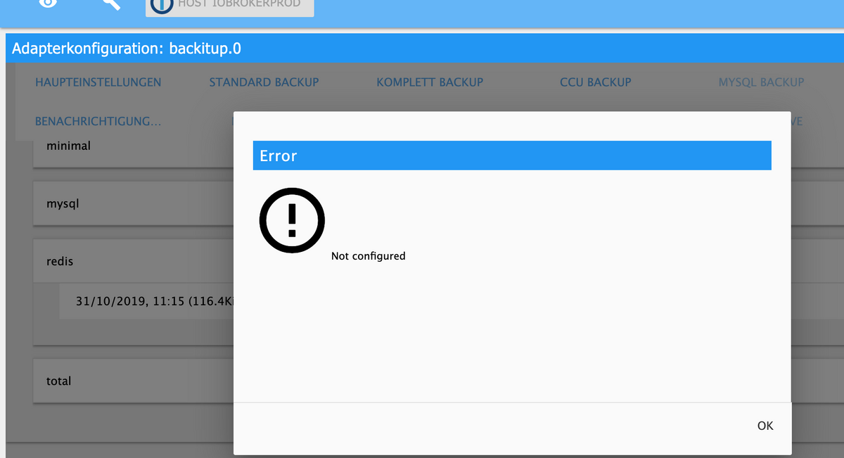

    versuche gerade im BackitUp Adapter meine Redis DB zu restoren.
    Da kommt dann die Meldung ioBroker wird beendet und dann kommt "Not Configured"?
    Was mache ich falsch? Backup auf FTP Server wird gefunden.

      @weidlix sagte in BackitUp:
      Configured
      Hast du die richtige Pfadangabe für redis eingetragen?
      Gib mal bitte die Debug Logausgaben

        @simatec said in BackitUp:
        Pfad hatte ich eingetragen und gecheckt.
        2019-11-07 14:54:25.936  - ^[[34mdebug^[[39m: backitup.0 objectDB connected
        2019-11-07 14:54:25.951  - ^[[34mdebug^[[39m: backitup.0 statesDB connected
        2019-11-07 14:54:25.953  - ^[[32minfo^[[39m: backitup.0 States connected to redis: 127.0.0.1:6379
        2019-11-07 14:54:26.073  - ^[[32minfo^[[39m: backitup.0 starting. Version 1.2.0 in /opt/iobroker/node_modules/iobroker.backitup, node: v10.17.0
        2019-11-07 14:54:26.113  - ^[[32minfo^[[39m: backitup.0 [total] backup was activated at 03:00 every 5 day(s)
        2019-11-07 14:54:26.127  - ^[[34mdebug^[[39m: backitup.0 [total] 10 00 03 */5 * *
        2019-11-07 14:54:30.021  - ^[[34mdebug^[[39m: backitup.0 redis pmessage  messagebox.system.adapter.backitup.0 messagebox.system.adapter.backitup.0 {"command":"getTelegramUser","message":null,"from":"syst$
        2019-11-07 14:54:30.023  - ^[[34mdebug^[[39m: backitup.0 sendTo "getTelegramUser" to system.adapter.admin.0 from system.adapter.backitup.0: {"661753021":"Stephan"}
        2019-11-07 14:54:31.433  - ^[[34mdebug^[[39m: backitup.0 redis pmessage  messagebox.system.adapter.backitup.0 messagebox.system.adapter.backitup.0 {"command":"list","message":"ftp","from":"system.adapter$
        2019-11-07 14:54:31.599  - ^[[34mdebug^[[39m: backitup.0 FTP connected.
        2019-11-07 14:54:33.668  - ^[[34mdebug^[[39m: backitup.0 sendTo "list" to system.adapter.admin.0 from system.adapter.backitup.0
        2019-11-07 14:54:41.884  - ^[[34mdebug^[[39m: backitup.0 redis pmessage  messagebox.system.adapter.backitup.0 messagebox.system.adapter.backitup.0 {"command":"restore","message":{"type":"ftp","fileName":$
        2019-11-07 14:54:41.886  - ^[[34mdebug^[[39m: backitup.0 Test: redis_2019_10_31-11_15_41_backupiobroker.tar.gz
        2019-11-07 14:54:41.887  - ^[[34mdebug^[[39m: backitup.0 sendTo "restore" to system.adapter.admin.0 from system.adapter.backitup.0

          @weidlix probiere das ganze mal lokal
            klappt auch nicht .. :-(

              @weidlix
              Nimm mal die Version 1.3.0 ...
              Da sollte der Fehler gefixt sein
