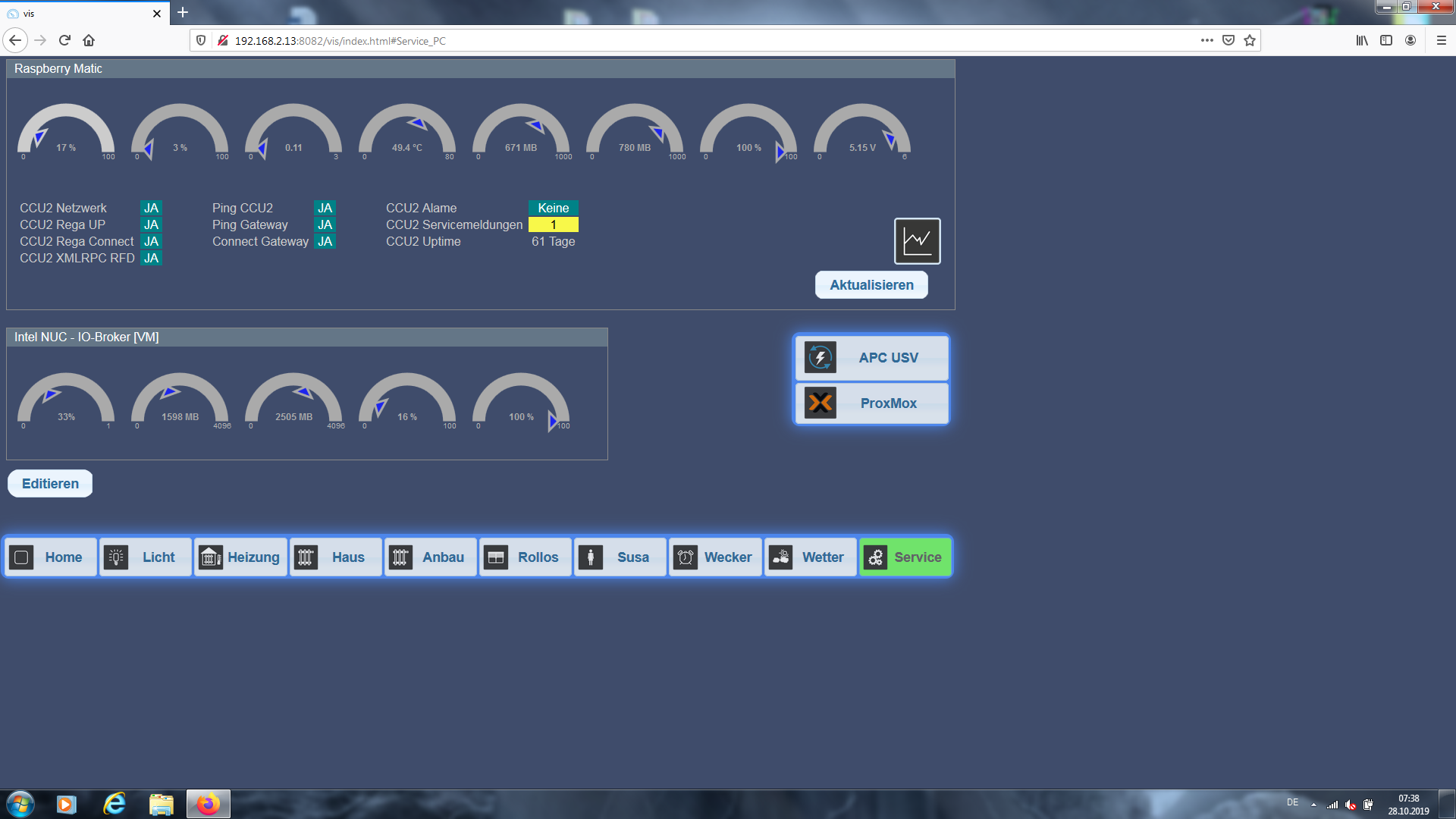

    Aufgrund einer längeren Dienstreise kam ich erst gestern wieder sinnvoll an meine Maschine. 7 Updates standen an
    Snapshot - IOBroker stop, iobroker update und dann manuell die datapter durch via IOBroker upgrade Adaptername
    Nach dem Start funktionierten die jzstgae Widgets nicht mehr. keine Farbe, die beschreibung fehlt
    Das problem ist browserunabhängig (Firefox, chrome) und auch PC Unabhängig (auf 2 rechnern, einmal unter win7 und einmalunter win10)
    so ist die datstellung :
    und dies ist der export eines dieser widgets:
    [{"tpl":"tplJustgageJustGage","data":{"g_fixed":false,"g_visibility":false,"g_css_font_text":false,"g_css_background":false,"g_css_shadow_padding":false,"g_css_border":false,"g_gestures":false,"g_signals":false,"visibility-cond":"==","visibility-val":1,"visibility-groups-action":"hide","is_tdp":false,"factor":"1","balance1":"50","balance2":"50","signals-cond-0":"==","signals-val-0":true,"signals-icon-0":"/vis/signals/lowbattery.png","signals-icon-size-0":0,"signals-blink-0":false,"signals-horz-0":0,"signals-vert-0":0,"signals-hide-edit-0":false,"signals-cond-1":"==","signals-val-1":true,"signals-icon-1":"/vis/signals/lowbattery.png","signals-icon-size-1":0,"signals-blink-1":false,"signals-horz-1":0,"signals-vert-1":0,"signals-hide-edit-1":false,"signals-cond-2":"==","signals-val-2":true,"signals-icon-2":"/vis/signals/lowbattery.png","signals-icon-size-2":0,"signals-blink-2":false,"signals-horz-2":0,"signals-vert-2":0,"signals-hide-edit-2":false,"oid":"javascript.1.WRAPPER.SYSTEM.DUTY_CCU","min_oid":0,"max_oid":"100","unit":" %","title":"Duty Cycle CCU","pointer":true,"pointerColor":"#1d25ed","gaugeWidthScale":"70","hideInnerShadow":true,"shadowSize":"30","label_oid":"","valueFontColor":"#AAAAAA","color1":"#008287","color2":"yellow","color3":"#ed4d61","sector1":"30","sector2":"70","fullBri":false,"gaugeColor":"#cccccc","noGradient":true,"valueFontFamily":"","valueOffsetY":"18","is_comma":false,"digits":"0","titleFontColor":"#cccccc","lc-type":"last-change","lc-is-interval":true,"lc-is-moment":false,"lc-format":"","lc-position-vert":"top","lc-position-horz":"right","lc-offset-vert":0,"lc-offset-horz":0,"lc-font-size":"12px","lc-font-family":"","lc-font-style":"","lc-bkg-color":"","lc-color":"","lc-border-width":"0","lc-border-style":"","lc-border-color":"","lc-border-radius":10,"lc-zindex":0},"style":{"left":"7px","top":"33px","width":"160px","height":"139px"},"widgetSet":"justgage"}]
    Hat diesen Effekt noch jemand oder an welcher Schaube hier könnte ich drehen ?
    gruss,Black

        @Blackmike
        Dein Widget geht bei mir auch nicht, sende dir meines das geht, teste es mal.
        Welche Version von dem Widget hast du? Version Vis?
        [{"tpl":"tplJustgageJustGage","data":{"g_fixed":false,"g_visibility":false,"g_css_font_text":true,"g_css_background":false,"g_css_shadow_padding":false,"g_css_border":false,"g_gestures":false,"g_signals":false,"g_last_change":false,"visibility-cond":"==","visibility-val":1,"visibility-groups-action":"hide","is_tdp":"false","factor":"1","balance1":"50","balance2":"50","signals-cond-0":"==","signals-val-0":true,"signals-icon-0":"/vis/signals/lowbattery.png","signals-icon-size-0":0,"signals-blink-0":false,"signals-horz-0":0,"signals-vert-0":0,"signals-hide-edit-0":false,"signals-cond-1":"==","signals-val-1":true,"signals-icon-1":"/vis/signals/lowbattery.png","signals-icon-size-1":0,"signals-blink-1":false,"signals-horz-1":0,"signals-vert-1":0,"signals-hide-edit-1":false,"signals-cond-2":"==","signals-val-2":true,"signals-icon-2":"/vis/signals/lowbattery.png","signals-icon-size-2":0,"signals-blink-2":false,"signals-horz-2":0,"signals-vert-2":0,"signals-hide-edit-2":false,"lc-type":"last-change","lc-is-interval":true,"lc-is-moment":false,"lc-format":"","lc-position-vert":"top","lc-position-horz":"right","lc-offset-vert":0,"lc-offset-horz":0,"lc-font-size":"12px","lc-font-family":"","lc-font-style":"","lc-bkg-color":"","lc-color":"","lc-border-width":"0","lc-border-style":"","lc-border-color":"","lc-border-radius":10,"lc-zindex":0,"oid":"daswetter.0.NextHours.Location_1.Day_1.current.temp_value","unit":"°C","min_oid":"0","max_oid":"30","digits":"0","pointer":true,"pointerMid":true,"pointerColor":"#71fb2d","mid_oid":"","hideValue":false,"valueFontColor":"#22f729","title":"Temp","titleFontColor":"#ffffff","titleBelow":false,"titleFontFamily":"\"Courier New\", Courier, monospace","titleOffsetY":"","hideMinMax":false,"label_oid":"","is_comma":false},"style":{"left":"818px","top":"233px","z-index":"1","width":"236px","height":"204px","color":"#ffffff","font-family":"RobotoCondensed-Light"},"widgetSet":"justgage"}]

          sehr interessant.... bei mir tuns nun die Farbverlufe wieder nachdem ich deins importiert hatte, aber die Titeldarstellung tuts immer noch nicht .
          der muss sich ja über verschluckt haben beim Update.

              @sigi234 ich habe noch nicht den Controller auf 2.x.x gezogen, ich arbeite noch mit dem 1.5.14

                Ist bei mir leider genauso.
                Mit der justgage Version 1.0.0 und js-controller 2.x.x funktionieren die min, mid, max Werte nicht mehr, dafür funktionieren noch alle Einstellungen unter Layout wie z.B. Farbverläufe, Ende Sektor 1, Ende Sektor 2 etc. Beim Update auf justgage 1.0.1 funktionieren die min, mid, max Werte wieder, da dieser Bug in der Version gefixt wurde, dafür funktionieren bei mir sämtlich Einstellungen unter Layout nicht mehr und die Formatierung des Widgets hinsichtlich Größe und Schriftgröße des Aktualwertes hat sich verändert.
                Es hilft nur downgrade auf js-controller 1.5.14 und justgage 1.0.0, dann wird alles wieder korrekt dargestellt. Es sind auch bereits issues auf github/justgage erstellt. Hoffe dies kann mit einer neuen Version von justage gefixt werden oder im js-controller 2.x.x kann etwas angepasst werden, da ich das justgage Widget auch in vielen meiner vis views nutze.

                  ok, aber wie kriege ich das justgage wieder auf 1.0.0 ? im Admin zeigt er mir nicht die Möglichkeit an: bestimmte Version installieren. (expertenmodus hab ich, admin udn so zeigtermir das auch, aber bei den wirdgets nicht)
                  Black
                  die Wahrheit ist ein Chor aus Wind
                    MK-66
                    Justgage Widgets adapter 1.0.1 deinstallieren, in den Admin Einstellungen den aktiven Verwahrungsort auf stable einstellen und dann wird bei den Adaptern der justgage Adapter als stable version 1.0.0 angezeigt und kann in der Version 1.0.0 wieder neu installiert werden.

                      danke, mache eben einen Snapshot der VM und probiere das
                      [Edit] Downgrade erfolgreich, Anzeige passt erstmal wieder. Vielen Dank

                          Ich kann das fehlerhafte Verhalten des justgage Widgets bestätigen.
                          Unter js-Controller 2.0.38 werden die Einstellungen für Farbe, Schatten etc. ignoriert.
                          Unter 1.15.14 war noch alles ok.

                              Es gibt inzwischen die Version 1.0.2 des justGage Adapters im latest. Es sieht so aus, dass die Bugs gefixt wurden, bei mir funktioniert auf jeden Fall alles wunderbar mit der Version 1.0.2 und js-controller 2.0.39.
                              Vielen vielen Dank an die Entwickler und vielen Dank auch für die schnelle Reaktion!
