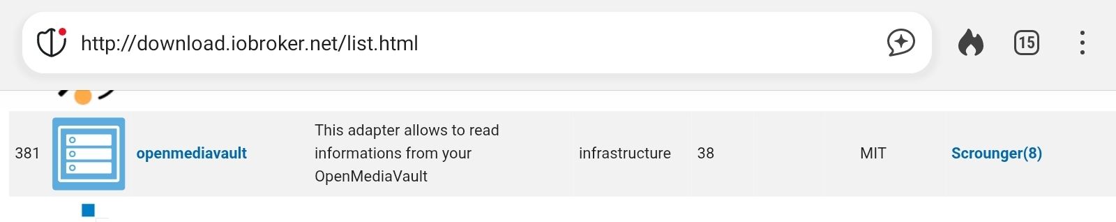

        is it this?
        so I will mention @scrounger
