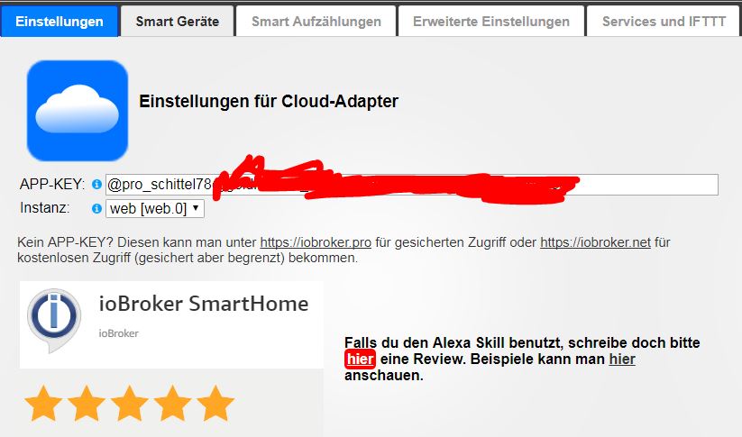

    Konfiguration:
    Adapter web und cloud sind auf grün und ich komme in die Adminoberfläche. Nur VIS und Bearbeitung der Skripte funktioniert nicht.
    Skript-Bearbeitung:

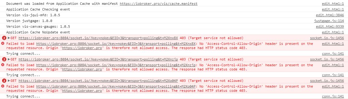

    ****Anzeige VIS:****
     ![3116_error_vis.jpg](/assets/uploads/files/3116_error_vis.jpg)
    Document was loaded from Application Cache with manifest https://iobroker.pro/vis/cache.manifest
    edit.html:1 Application Cache Checking event
    edit.html:3846 Version vis-jqui-mfd: 1.0.5
    justgage.js:114 Version justgage: 1.0.0
    edit.html:9339 Version vis-canvas-gauges: 1.0.5
    edit.html:1 Application Cache NoUpdate event
    2socket.io.js:1456 GET https://iobroker.pro:8084/socket.io/?key=nokey&EIO=3&transport=polling&t=M2Xnx8X 403 (Target service not allowed)
    Request.create @ socket.io.js:1456
    Request @ socket.io.js:1369
    XHR.request @ socket.io.js:1297
    XHR.doPoll @ socket.io.js:1327
    Polling.poll @ socket.io.js:1740
    Polling.doOpen @ socket.io.js:1684
    Transport.open @ socket.io.js:827
    Socket.open @ socket.io.js:248
    Socket @ socket.io.js:129
    Socket @ socket.io.js:55
    Manager.open.Manager.connect @ socket.io.js:4549
    Manager @ socket.io.js:4403
    Manager @ socket.io.js:4372
    lookup @ socket.io.js:4301
    init @ conn.js:234
    main @ vis.js:3556
    (anonymous) @ vis.js:3818
    j @ jquery-1.11.2.min.js:2
    fireWith @ jquery-1.11.2.min.js:2
    ready @ jquery-1.11.2.min.js:2
    J @ jquery-1.11.2.min.js:2
    edit.html:1 Failed to load https://iobroker.pro:8084/socket.io/?key=nokey&EIO=3&transport=polling&t=M2Xnx8X: No 'Access-Control-Allow-Origin' header is present on the requested resource. Origin 'https://iobroker.pro' is therefore not allowed access. The response had HTTP status code 403.
    conn.js:141 Trying connect...
    2socket.io.js:1456 GET https://iobroker.pro:8084/socket.io/?key=nokey&EIO=3&transport=polling&t=M2Xnzjp 403 (Target service not allowed)
    Socket.open.Socket.connect @ socket.io.js:5022
    (anonymous) @ conn.js:142
    setInterval (async)
    reconnect @ conn.js:140
    (anonymous) @ conn.js:323
    Emitter.emit @ socket.io.js:5657
    Socket.emit @ socket.io.js:5053
    Manager.emitAll @ socket.io.js:4416
    (anonymous) @ socket.io.js:4566
    Emitter.emit @ socket.io.js:2556
    Socket.onError @ socket.io.js:688
    (anonymous) @ socket.io.js:279
    Transport.onError @ socket.io.js:814
    (anonymous) @ socket.io.js:1333
    Request.onError @ socket.io.js:1502
    (anonymous) @ socket.io.js:1449
    setTimeout (async)
    xhr.onreadystatechange @ socket.io.js:1448
    XMLHttpRequest.send (async)
    init @ conn.js:234
    main @ vis.js:3556
    edit.html:1 Failed to load https://iobroker.pro:8084/socket.io/?key=nokey&EIO=3&transport=polling&t=M2Xnzjp: No 'Access-Control-Allow-Origin' header is present on the requested resource. Origin 'https://iobroker.pro' is therefore not allowed access. The response had HTTP status code 403.
              init @ conn.js:234
              main @ vis.js:3556
              setInterval (async)
              setTimeout (async)
              init @ conn.js:234
              main @ vis.js:3556
              Was mich stutzig macht, ist dass im Log steht das socketio auf 8082 gestartet wird aber er auf 8084 nachschaut.
              web.0 2017-12-29 10:11:31.289 info http server listening on port 8082
              web.0 2017-12-29 10:11:31.282 info socket.io server listening on port 8082
              web.0 2017-12-29 10:11:30.844 info Allow states only when user is owner: false
              web.0 2017-12-29 10:11:30.840 info simpleAPI server listening on port 8082
              web.0 2017-12-29 10:11:30.594 info starting. Version 2.1.9 in /opt/iobroker/node_modules/iobroker.web, node: v6.12.2
              Auch die Installation vom Adapter socket.io und Anpassung der Einstellungen brachte keine Verbesserung.
              Habt Ihr vielleicht eine Idee woran das liegt? Wie habt Ihr das eingestellt? Als Browser habe ich Chrome/FF/IE ausprobiert, nutze aber hauptsächlich Chrome.
              vg
              Falk `
              8082 und 8084 sind falsch. So sieht es bei mir aus:
              https://iobroker.pro/socket.io/?key=nokey&EIO=3&transport=polling
              Kannst du eingebaute Socket.io Ausprobieren?

                  Wie sieht bei dir die erste Konfig-Seite für cloud? Welche web Instanz?
                    schittl
                    @Bluefox:
                    Wie sieht bei dir die erste Konfig-Seite für cloud? Welche web Instanz? ` 3116_cloud2.jpg
                    Habt Ihr irgendetwas verändert? Ich jedenfalls nicht. VIS funktioniert auf einmal aber js funktioniert immer noch nicht heul. Hier der Fehler: 3116_js2.jpg

                                Es hat zwischenzeitlich funktioniert, aber aktuell funktioniert VIS (1.0.4) über iobroker.pro nicht mehr. Veränderungen wurden nicht vorgenommen. Es wurde lediglich hqwidgets(1.1.1) installiert. Es erscheint folgender Fehler:
                                Uncaught ReferenceError: getUsedObjectIDs is not defined
                                at Object.getUsedObjectIDs (vis.js:316)
                                at vis.js:1725
                                at conn.js:521
                                Folgendes habe ich schon ausprobiert, aber leider ohne Erfolg:
                                  • iobroker upload all bzw. iobroker upload vis
                                - Neustart iobroker
                                Was könnte die Ursache sein? Danke im voraus.

                                        Wollte nun heute von extern anfangen meine VIS zu modifizieren, aber der Fehler erscheint nun wieder :oops: . Am Wochenende funktionierte es. Kann es sein, dass es am Browser/OS/NW liegt?
                                        Am WE mit Safari am IPad im Heimnetzwerk (wo ich auch direkt ohne Cloud Zugriff habe) funktionierte es und nun mit Chrome/FF in Windows ohne direkten Zugriff (Hotspot) funktioniert es nicht.
                                        Browser-Cache wurde natürlich mehrmals gelöscht…
                                        Von extern hat es aber schon mal funktioniert. Ich glaube aber da war iobroker noch auf RPi3(Stretch). Es ist nun umgezogen auf einen Rock64 mit Armbian.

                                          @schittl:
                                          vg
                                          Falk `
                                          Es liegt an dem Browsecache. Bitte löschen.
