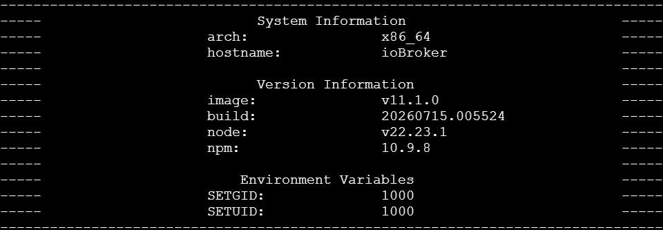

          • T TripleX
            @Thomas-Braun sagte:
            @TripleX
            Na dann. Ist der Rest dann jetzt konsistent?
            Gib nochmal die Ausgabe von
            iob diag
            zum Besten.
            ```bash
            Script v.2026-06-06
            *** BASE SYSTEM ***cat: /sys/devices/virtual/dmi/id/sys_vendor: No such file or directory
            Hardware Vendor :
            Kernel          : x86_64
            Userland        : 64bit
            Docker          : v11.1.0
            Virtualization  : Docker
            Kernel          : x86_64
            Userland        : 64bit
            Installation date unknown (filesystem does not support birth time).
            Systemuptime and Load:
             20:45:19 up 1 day, 23 min,  0 user,  load average: 2.53, 2.60, 2.33
            CPU threads     : 4
            *** LIFE CYCLE STATUS ***
            Debian 'bookworm' is the current oldstable version. Please upgrade to the latest stable release 'trixie' in due time!
            *** TIME AND TIMEZONES ***
            Sun Jul 19 18:45:19 UTC 2026
            Sun Jul 19 20:45:19 CEST 2026
            CEST +0200
            Etc/UTC
            *** Users and Groups ***
            User that called 'iob diag':
            root
            HOME=/root
            GROUPS=root
            iobroker
            HOME=/opt/iobroker
            GROUPS=iobroker tty dialout audio video plugdev
            *** DISPLAY-SERVER SETUP ***
            Display-Server:         Unknown
            Display-Manager:        System has not been booted with systemd as init system (PID 1). Can't operate.
            Desktop:
            Session:
            *** MEMORY ***
            Mem:             16G        7.2G        697M        412M        9.8G        9.5G
            Swap:            17G        247M         16G
            Total:           33G        7.4G         17G
            Active iob-Instances:   14
                    15856 M total memory
                     6830 M used memory
                     2492 M active memory
                    11311 M inactive memory
                      665 M free memory
                     1304 M buffer memory
                     8036 M swap cache
                    16383 M total swap
                      235 M used swap
                    16148 M free swap
            top - 20:45:20 up 1 day, 23 min,  0 user,  load average: 2.53, 2.60, 2.33
            Tasks:  27 total,   1 running,  26 sleeping,   0 stopped,   0 zombie
            %Cpu(s):  2.7 us,  8.0 sy,  0.0 ni, 20.0 id, 68.0 wa,  0.0 hi,  1.3 si,  0.0 st
            MiB Mem :  15856.8 total,    664.8 free,   6830.3 used,   9341.7 buff/cache
            MiB Swap:  16384.0 total,  16148.0 free,    236.0 used.   9026.4 avail Mem
            *** DMESG CRITICAL ERRORS ***
            dmesg: read kernel buffer failed: Operation not permitted
            No critical errors detected
            *** FILESYSTEM ***
            Filesystem     Type     Size  Used Avail Use% Mounted on
            overlay        overlay  8.1T  7.2T  937G  89% /
            tmpfs          tmpfs     64M     0   64M   0% /dev
            tmpfs          tmpfs    7.8G     0  7.8G   0% /sys/fs/cgroup
            shm            tmpfs     64M     0   64M   0% /dev/shm
            /dev/md0       ext4     8.1T  7.2T  937G  89% /opt/iobroker
            tmpfs          tmpfs    7.8G     0  7.8G   0% /proc/asound
            tmpfs          tmpfs    7.8G     0  7.8G   0% /proc/acpi
            tmpfs          tmpfs    7.8G     0  7.8G   0% /proc/scsi
            tmpfs          tmpfs    7.8G     0  7.8G   0% /sys/firmware
            Messages concerning filesystems in dmesg:
            Show mounted filesystems:
            TARGET           SOURCE                                                                                                                                         FSTYPE OPTIONS
            /opt/iobroker    /dev/md0[/Container/container-station-data/lib/docker/volumes/0502e0c7b239add37e4f0de02fdef39d12a4fb519164e5fce6bd240aaadf3312/_data]          ext4   rw,relatime,data=ordered,data_err=abort,jqfmt=vfsv1,usrjquota=aquota.user
            /etc/resolv.conf /dev/md0[/Container/container-station-data/lib/docker/containers/6e5c313a5aab805dec577e8f62e92d298b2b7e0d558d817ac0fa936d7d4face9/resolv.conf] ext4   rw,relatime,data=ordered,data_err=abort,jqfmt=vfsv1,usrjquota=aquota.user
            /etc/hostname    /dev/md0[/Container/container-station-data/lib/docker/containers/6e5c313a5aab805dec577e8f62e92d298b2b7e0d558d817ac0fa936d7d4face9/hostname]    ext4   rw,relatime,data=ordered,data_err=abort,jqfmt=vfsv1,usrjquota=aquota.user
            /etc/hosts       /dev/md0[/Container/container-station-data/lib/docker/containers/6e5c313a5aab805dec577e8f62e92d298b2b7e0d558d817ac0fa936d7d4face9/hosts]       ext4   rw,relatime,data=ordered,data_err=abort,jqfmt=vfsv1,usrjquota=aquota.user
            /var:
            35M     /var/
            33M     /var/lib
            19M     /var/lib/apt/lists
            19M     /var/lib/apt
            14M     /var/lib/dpkg
            /opt/iobroker/backups:
            1.2G    /opt/iobroker/backups/
            /opt/iobroker/iobroker-data:
            1.1G    /opt/iobroker/iobroker-data/
            972M    /opt/iobroker/iobroker-data/files
            577M    /opt/iobroker/iobroker-data/files/vis.0
            528M    /opt/iobroker/iobroker-data/files/vis.0/Slideshow
            504M    /opt/iobroker/iobroker-data/files/vis.0/Slideshow/Wien 2019
            54M     /opt/iobroker/iobroker-data/objects.jsonl
            32M     /opt/iobroker/iobroker-data/files/mytime.admin/custom/assets/index-EvBwdTZH.js.map
            27M     /opt/iobroker/iobroker-data/files/tankerkoenig.admin/build/index.js.map
            13M     /opt/iobroker/iobroker-data/files/vis.0/Slideshow/Wien 2019/052.jpg
            9.8M    /opt/iobroker/iobroker-data/files/vis.0/Videos/Video - ioBroker-Logo 1920x1080.mp4
            USB-Devices by-id:
            USB-Sticks - Avoid direct links to /dev/tty* in your adapter setups,
            please always prefer the links 'by-id':
            No Devices found 'by-id'
            No nvbackup.json found.
            *** NodeJS-Installation ***
            /usr/bin/nodejs         v22.23.1
            /usr/bin/node           v22.23.1
            /usr/bin/npm            10.9.8
            /usr/bin/npx            10.9.8
            ✓ Node.js installation is correct
            nodejs:
              Installed: 22.23.1-1nodesource1
              Candidate: 22.23.1-1nodesource1
              Version table:
             *** 22.23.1-1nodesource1 1001
                    500 https://deb.nodesource.com/node_22.x nodistro/main amd64 Packages
                    100 /var/lib/dpkg/status
                 22.23.0-1nodesource1 1001
                 22.22.3-1nodesource1 1001
                 22.22.2-1nodesource1 1001
                 22.22.1-1nodesource1 1001
                 22.22.0-1nodesource1 1001
                 22.21.0-1nodesource1 1001
                 22.20.0-1nodesource1 1001
                 22.19.0-1nodesource1 1001
                 22.18.0-1nodesource1 1001
                 22.17.1-1nodesource1 1001
                 22.17.0-1nodesource1 1001
                 22.16.0-1nodesource1 1001
                 22.15.1-1nodesource1 1001
                 22.15.0-1nodesource1 1001
                 22.14.0-1nodesource1 1001
                 22.13.1-1nodesource1 1001
                 22.13.0-1nodesource1 1001
                 22.12.0-1nodesource1 1001
                 22.11.0-1nodesource1 1001
                 22.10.0-1nodesource1 1001
                 22.9.0-1nodesource1 1001
                 22.8.0-1nodesource1 1001
                 22.7.0-1nodesource1 1001
                 22.6.0-1nodesource1 1001
                 22.5.1-1nodesource1 1001
                 22.5.0-1nodesource1 1001
                 22.4.1-1nodesource1 1001
                 22.4.0-1nodesource1 1001
                 22.3.0-1nodesource1 1001
                 22.2.0-1nodesource1 1001
                 22.1.0-1nodesource1 1001
                 22.0.0-1nodesource1 1001
                 18.20.4+dfsg-1~deb12u2 500
                    500 http://deb.debian.org/debian bookworm/main amd64 Packages
                    500 http://deb.debian.org/debian-security bookworm-security/main amd64 Packages
            No problems detected
            Errors in npm tree: 0
            No known Vulnerabilities detected!
            *** ioBroker-Installation ***
            ioBroker Status
            Objects type: jsonl
            States  type: jsonl
            Hosts:
            ioBroker            ioBroker (version: 7.2.2, hostname: ioBroker      , alive, uptime: 1957)
            Core adapters versions
            js-controller:  7.2.2
            admin:          7.8.23
            javascript:     9.0.18
            nodejs modules from github:     0
            Adapter State
            + system.adapter.admin.0                  : admin                 : ioBroker                                 -  enabled, port: 8081, bind: 0.0.0.0, run as: admin
              system.adapter.alexa2.0                 : alexa2                : ioBroker                                 - disabled
            + system.adapter.backitup.0               : backitup              : ioBroker                                 -  enabled
              system.adapter.bambulab.0               : bambulab              : ioBroker                                 - disabled, port: 8883
              system.adapter.boschindego.0            : boschindego           : ioBroker                                 - disabled
              system.adapter.bydbatt.0                : bydbatt               : ioBroker                                 - disabled
              system.adapter.cloud.0                  : cloud                 : ioBroker                                 - disabled
              system.adapter.daikin-cloud.0           : daikin-cloud          : ioBroker                                 - disabled
              system.adapter.daswetter.0              : daswetter             : ioBroker                                 - disabled
              system.adapter.device-reminder.0        : device-reminder       : ioBroker                                 - disabled
              system.adapter.devices.0                : devices               : ioBroker                                 - disabled
              system.adapter.discovery.0              : discovery             : ioBroker                                 - disabled
              system.adapter.echarts.0                : echarts               : ioBroker                                 - disabled
              system.adapter.feiertage.0              : feiertage             : ioBroker                                 -  enabled
            + system.adapter.fritzdect.0              : fritzdect             : ioBroker                                 -  enabled
            + system.adapter.hm-rega.0                : hm-rega               : ioBroker                                 -  enabled
            + system.adapter.hm-rpc.1                 : hm-rpc                : ioBroker                                 -  enabled, port: 0
              system.adapter.ical.0                   : ical                  : ioBroker                                 -  enabled
              system.adapter.ical.1                   : ical                  : ioBroker                                 -  enabled
              system.adapter.icons-addictive-flavour-png.0: icons-addictive-flavour-png: ioBroker                                 - disabled
              system.adapter.icons-mfd-svg.0          : icons-mfd-svg         : ioBroker                                 -  enabled
              system.adapter.influxdb.0               : influxdb              : ioBroker                                 - disabled, port: 8086
            + system.adapter.javascript.0             : javascript            : ioBroker                                 -  enabled
            + system.adapter.modbus.0                 : modbus                : ioBroker                                 -  enabled
              system.adapter.mytime.0                 : mytime                : ioBroker                                 - disabled
              system.adapter.openweathermap.0         : openweathermap        : ioBroker                                 - disabled
              system.adapter.plex.0                   : plex                  : ioBroker                                 - disabled
            + system.adapter.pushover.0               : pushover              : ioBroker                                 -  enabled
            + system.adapter.pushover.1               : pushover              : ioBroker                                 -  enabled
            + system.adapter.semp.0                   : semp                  : ioBroker                                 -  enabled
              system.adapter.slideshow.0              : slideshow             : ioBroker                                 -  enabled
              system.adapter.smartthings.0            : smartthings           : ioBroker                                 -  enabled
              system.adapter.sonoff.0                 : sonoff                : ioBroker                                 - disabled, port: 1883, bind: 0.0.0.0
