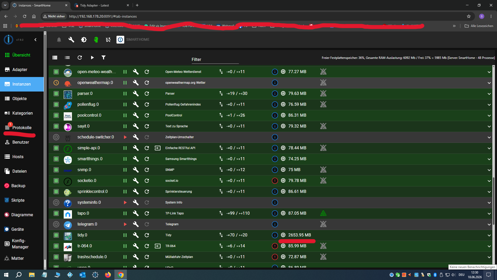

          der Adapter arbeitet gut wenn man keinen Complet Scan macht.
          Dann stürzt er ab und blockiert mein System.
          tidy.0
          2026-06-18 12:30:42.761	warn	Cannot parse "QUEUED"
          tidy.0
          2026-06-18 12:30:42.760	warn	Cannot parse "OK"
          tidy.0
          2026-06-18 12:30:27.763	warn	Cannot parse "QUEUED"
          tidy.0
          2026-06-18 12:30:27.762	warn	Cannot parse "OK"
          tidy.0
          2026-06-18 12:30:12.752	warn	Cannot parse "QUEUED"
          tidy.0
          2026-06-18 12:30:12.751	warn	Cannot parse "OK"
          tidy.0
          2026-06-18 12:29:57.724	warn	Cannot parse "QUEUED"
          tidy.0
          2026-06-18 12:29:57.723	warn	Cannot parse "OK"
          tidy.0
          2026-06-18 12:29:57.716	info	Automatic scanning enabled: Every 24 hour(s)
          tidy.0
          2026-06-18 12:29:57.715	error	Error during complete scan: Invalid string length
          tidy.0
          2026-06-18 12:29:40.025	info	Scanning entire object tree (complete scan) ...
          tidy.0
          2026-06-18 12:29:40.024	info	Scan completed for 0_userdata.0: 1940 datapoints (471 dead, 548 stale, 0 orphaned, 0 excluded) in 1.30s
          tidy.0
          2026-06-18 12:29:38.727	info	Scanning path: 0_userdata.0
          tidy.0
          2026-06-18 12:29:38.708	info	Starting Tidy adapter...
          tidy.0
          2026-06-18 12:29:38.699	info	starting. Version 0.3.2 in C:/SmartHome/node_modules/iobroker.tidy, node: v22.23.0, js-controller: 7.2.2
          tidy.0
          2026-06-18 12:29:33.607	warn	redis get 0_userdata.0.allestoerungen.Hot.disruption_desc_2, error - Connection is closed.
          tidy.0
          2026-06-18 12:29:33.605	warn	redis get 0_userdata.0.allestoerungen.Hot.disruption_2, error - Connection is closed.
          tidy.0
          2026-06-18 12:29:33.601	info	terminating
          tidy.0
          tidy.0
          2026-06-18 12:29:33.155	info	Scanning path: 0_userdata.0
          tidy.0
          2026-06-18 12:29:33.102	info	Terminated (ADAPTER_REQUESTED_TERMINATION): Without reason
          tidy.0
          2026-06-18 12:29:33.100	info	terminating
          tidy.0
          2026-06-18 12:29:33.099	info	Got terminate signal TERMINATE_YOURSELF
          tidy.0
          2026-06-18 12:29:33.098	info	Configuration updated — reloading paths and rescanning
          tidy.0
          2026-06-18 12:28:40.956	info	Automatic scanning enabled: Every 24 hour(s)
          tidy.0
          2026-06-18 12:28:40.955	info	Scan completed for 0_userdata.0: 1940 datapoints (471 dead, 548 stale, 0 orphaned, 0 excluded) in 1.51s
          tidy.0
          2026-06-18 12:28:39.441	info	Scanning path: 0_userdata.0
          Plattform: Windows
          RAM: 15.9 GB
          Node.js: v22.23.0
          NPM: 10.9.8
          Tidy: 0.3.2
          JS: 7.2.2
          Admin: 7.9.2
          Immer Daten sichern!

              @sigi234 ..
              Der Fehler Invalid string length tritt auf, wenn der Complete Scan versucht, alle Datenpunkte mit ihren vollen Werten in einem einzigen JSON-State zu speichern – bei großen Installationen überschreitet das das Node.js-Limit.
              In der nächsten Version (0.3.3) ist das behoben: Werte werden gekürzt, States werden gebündelt geladen, und bei extrem großen Instanzen gibt es einen Fallback ohne Wert-Feld.
              Bis dahin: Complete Scan vorübergehend deaktivieren und stattdessen gezielte Pfad-Scans nutzen (z. B. alias, hm-rpc, 0_userdata.0).
              Bitte testen und mir eine kurze Rückmeldung geben 😊

                @skvarel sagte:
                Die 0.3.3 ist online
                Ja, schaut besser aus.
