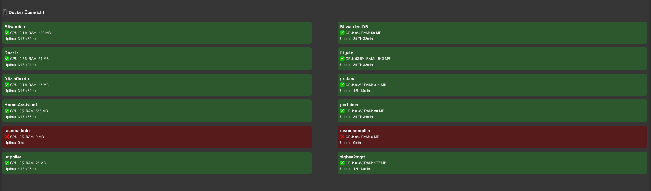

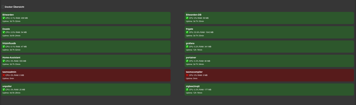

      const mobileLayoutColumns = 1; // 1 = eine Spalte, 2 = zwei Spalten in mobiler Ansicht
      const mobileColumnOrder = [
          'name', 'state', 'cpu', 'mem', 'uptime'
      ]; // Spaltenreihenfolge in der mobilen Ansicht

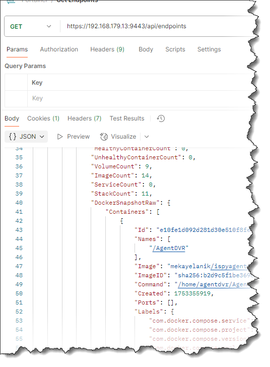

      const username = 'admin';
      const password = 'supergeheimespassword!';
      const portainerHost = 'http://10.10.2.10:9000';
      const endpointId = 2;  //default 1

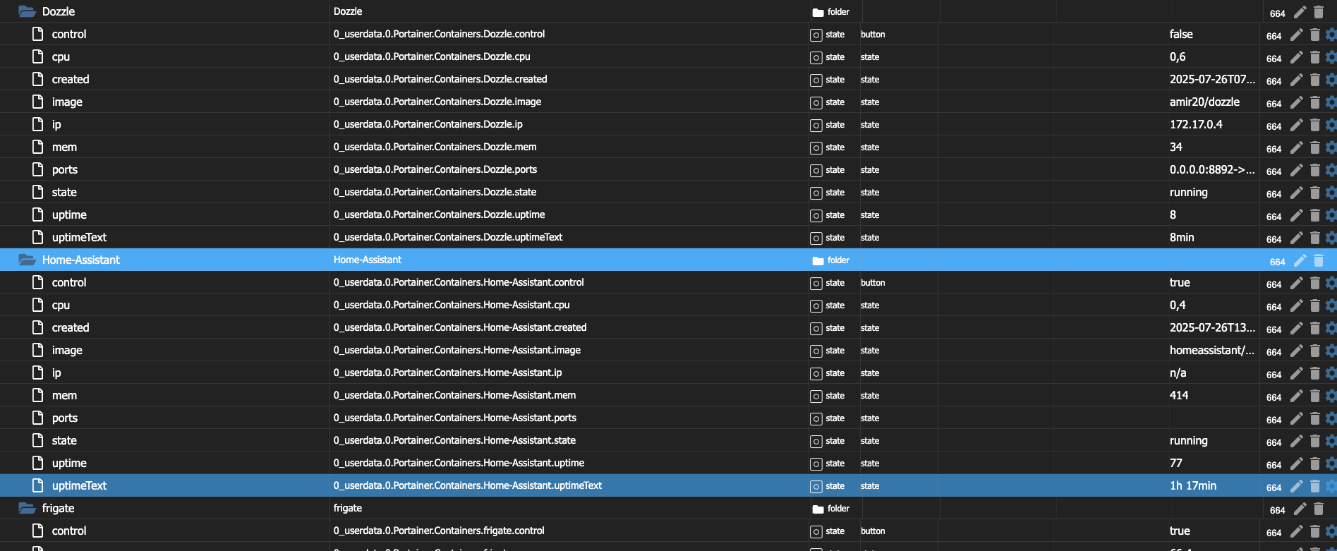

      const datapointBase = '0_userdata.0.Portainer.Containers.';
      const statusBoardDP = '0_userdata.0.Portainer.Containers.Statusboard';

      const mobileStatusDP = '0_userdata.0.Portainer.Containers.StatusMobile';
      const mobileUseSymbol = true;       // true = ✅/❌, false = 'running'
      const mobileShowCPU = true;         // true = CPU in mobiler Ansicht anzeigen
      const mobileShowRAM = true;         // true = RAM in mobiler Ansicht anzeigen
      const mobileTwoLineLayout = true;   // true = Name/Status oben, Details unten

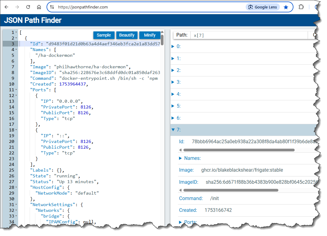

      function getContainerList(token) {
          const url = `${portainerHost}/api/endpoints/${endpointId}/docker/containers/json?all=1`;
          const cmd = `curl -s -H "Authorization: Bearer ${token}" "${url}"`;
          exec(cmd, (error, stdout) => {
              if (error) return log(`❌ Fehler beim Containerabruf: ${error}`, 'error');
              try {
                  const containers = JSON.parse(stdout);
                  const containerList = [];
                  containers.forEach(container => {
                      const id = container.Id;
                      const name = container.Names[0].replace(/^\//, '');
                      const dp = `${datapointBase}${name}`;
                      const image = container.Image;
                      const createdDate = new Date(container.Created * 1000);
                      const createdDaysAgo = Math.floor((Date.now() - createdDate.getTime()) / (1000 * 60 * 60 * 24));
                      const created = `${createdDate.toLocaleString('de-DE', { hour12: false })} (${createdDaysAgo} Tage alt)`;
                      const ports = (container.Ports || []).map(p => `${p.IP || '0.0.0.0'}:${p.PublicPort}->${p.PrivatePort}/${p.Type}`).join(', ');
                      const ip = container.NetworkSettings?.Networks?.bridge?.IPAddress || 'n/a';
                      createState(`${dp}.image`, image, true);
                      setState(`${dp}.image`, image, true);
                      createState(`${dp}.created`, created, true);
                      setState(`${dp}.created`, created, true);
                      createState(`${dp}.ports`, ports, true);
                      setState(`${dp}.ports`, ports, true);
                      createState(`${dp}.ip`, ip, true);
                      setState(`${dp}.ip`, ip, true);
                      createState(`${dp}.control`, false, { type: 'boolean', role: 'button', write: true, read: false });

                              const stateDP = `${dp}.state`;
                              getStateAsync(stateDP).then(oldState => {
                                  if (oldState && oldState.val !== state) {
                                      const msg = `🔔 Container \`${name}\` Status: \`${oldState.val}\` → \`${state}\``;
                                      sendDiscordMessage(msg);
                                      sendTelegramMessage(msg);
                              createState(stateDP, state, true);
                              setState(stateDP, state, true);
                              createState(`${dp}.uptimeText`, uptimeText, true);
                              setState(`${dp}.uptimeText`, uptimeText, true);

                                      const memMB = Math.round((stats.memory_stats.usage || 0) / 1024 / 1024);
                                      createState(`${dp}.cpu`, Math.round(cpuPercent * 10) / 10, true);
                                      setState(`${dp}.cpu`, Math.round(cpuPercent * 10) / 10, true);
                                      createState(`${dp}.mem`, memMB, true);
                                      setState(`${dp}.mem`, memMB, true);

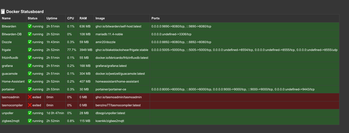

      function buildHTML(list) {
          list.sort((a, b) => a.name.localeCompare(b.name));
          let html = `<b style="color:#ffffff;">🧾 Docker Statusboard</b><br>
          <label for="runningFilter" style="color:#ffffff;">🚦 Nur laufende anzeigen</label>
          <input type="checkbox" id="runningFilter" onchange="filterRunning()" style="margin-bottom:10px;">
          <label for="themeToggle" style="color:#ffffff;">🌗 Theme</label>
          <input type="checkbox" id="themeToggle" checked onchange="toggleTheme()" style="margin-bottom: 10px;"><br>
          <table id="dockerStatus" border="1" cellspacing="0" cellpadding="6"
              style="font-family:Arial; font-size:13px; border-collapse:collapse;
                     text-align:left; background:#1e1e1e; color:#ffffff; border-color:#444; width:100%;">
              <thead>
              <tr style="background:#333;">
                  <th onclick="sortTable(0)">Name</th>
                  <th onclick="sortTable(1)">CPU</th>
                  <th onclick="sortTable(2)">RAM</th>
                  <th onclick="sortTable(3)">Status</th>
                  <th onclick="sortTable(4)">Uptime</th>
                  <th onclick="sortTable(5)">Restarted</th>
                  <th onclick="sortTable(6)">Restart-Zeit</th>
                  <th onclick="sortTable(7)">Image</th>
                  <th onclick="sortTable(8)">Erstellt</th>

      Screenshot von den Objects:

      Screenshot: Tabelle
      Screenshot: Mobile Ansicht, 2 Spaltig (konfigurierbar)

        @ilovegym sagte in script Dockermon Api:
        wie zerlege ich denn am besten das json
        Ich mache das erstmal immer mit dem "JSON Path Finder":
        vom Dockermon-Container
        Geht das nicht auch direkt mit dem Portainer-API?
        vor allem, wenn ein Container weg oder dazu kommt.. ?
        In Zabbix geht das mit JSONPath, da kann man nach bestimmten Einträgen suchen.
        Geht sowas nicht auch mit JSONATA? Da ist vermutlich @mickym der Fachmann 😉

            hab mal meinen "Sheldon" 🙂 gefragt (Chatgpt), und das kam zum schluss raus, habs noch n bisserl verfeinert, da die ersten Ansaetze nix waren..
            Das Script fragt direkt die Portainer-Api ab, einen Api-Key braucht man nicht und legt die Datenpunkte fuer Status, Ram, CPU und uptime im gewuenschten Ordner an.
            Man kann den/die Container starten/stoppen.
            Script in den ersten Beitrag verschoben, dieser wird immer aktualisiert.

                    endpointid richtig? muss nicht 1 sein,bei ist es 2

                          Portainer 2.27.9
                          Edit
                          Evtl kann man den Endpoint automatisch ausfüllen, wenn man diesen leer lässt.
                          curl -H "Authorization: Bearer <JWT>" \
                               http://10.68.xx.zzz:9000/api/endpoints
                          und dann den ersten falls es mehrere gibt.
