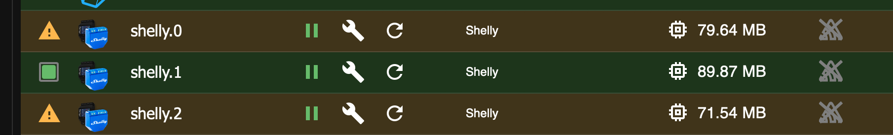

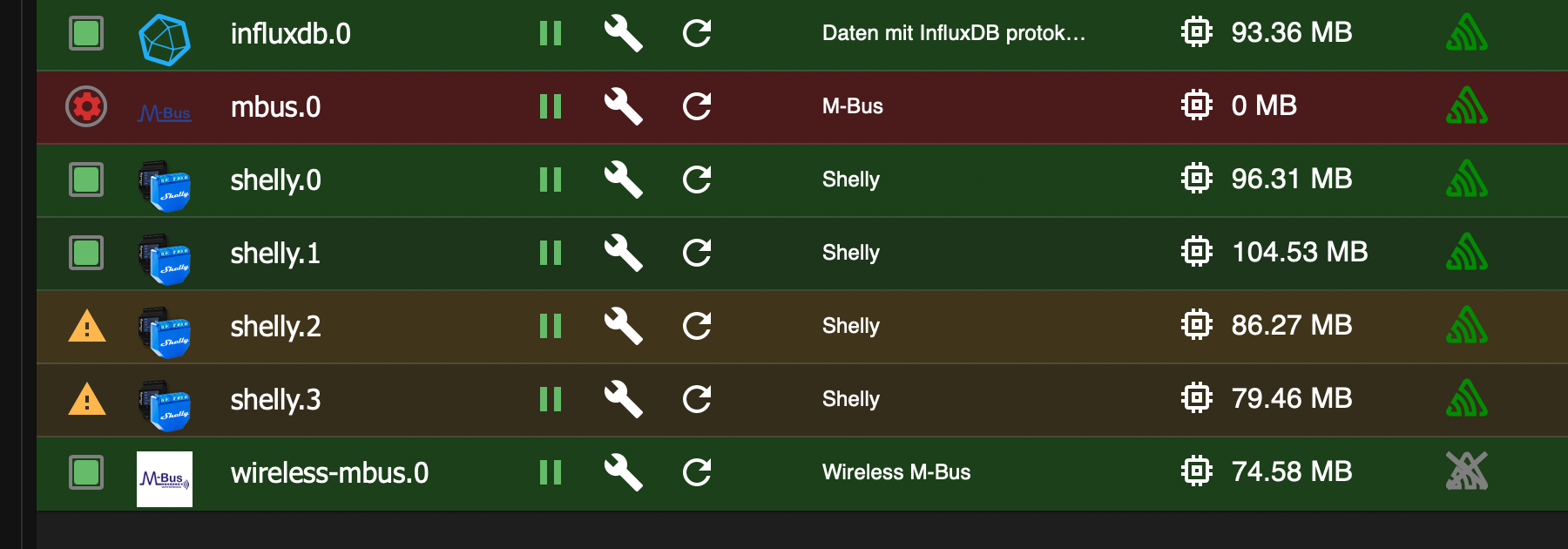

    ... 2 von den Shelly-Adaptern (Gen2.) mqtt
    nach update:
    shelly.0 ist Gen1 - Shelly 3EM
    shelly1 ist Gen2 - Shelly Pro 1PM
    shelly2 ist Gen2 - Shelly Pro 1PM
    shelly3 ist Gen2 - Shelly Plus 1PM
    shelly1-3 alle das gleiche adminPW und mqttPW, nur auf verschiedenen Ports

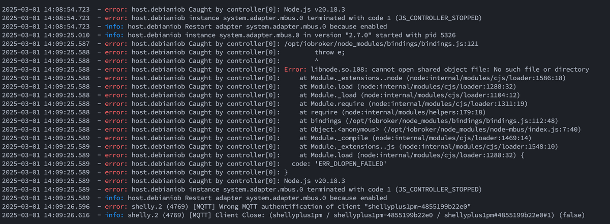

    iob diag spuckt unterwegs noch das hier aus:
    any idea?

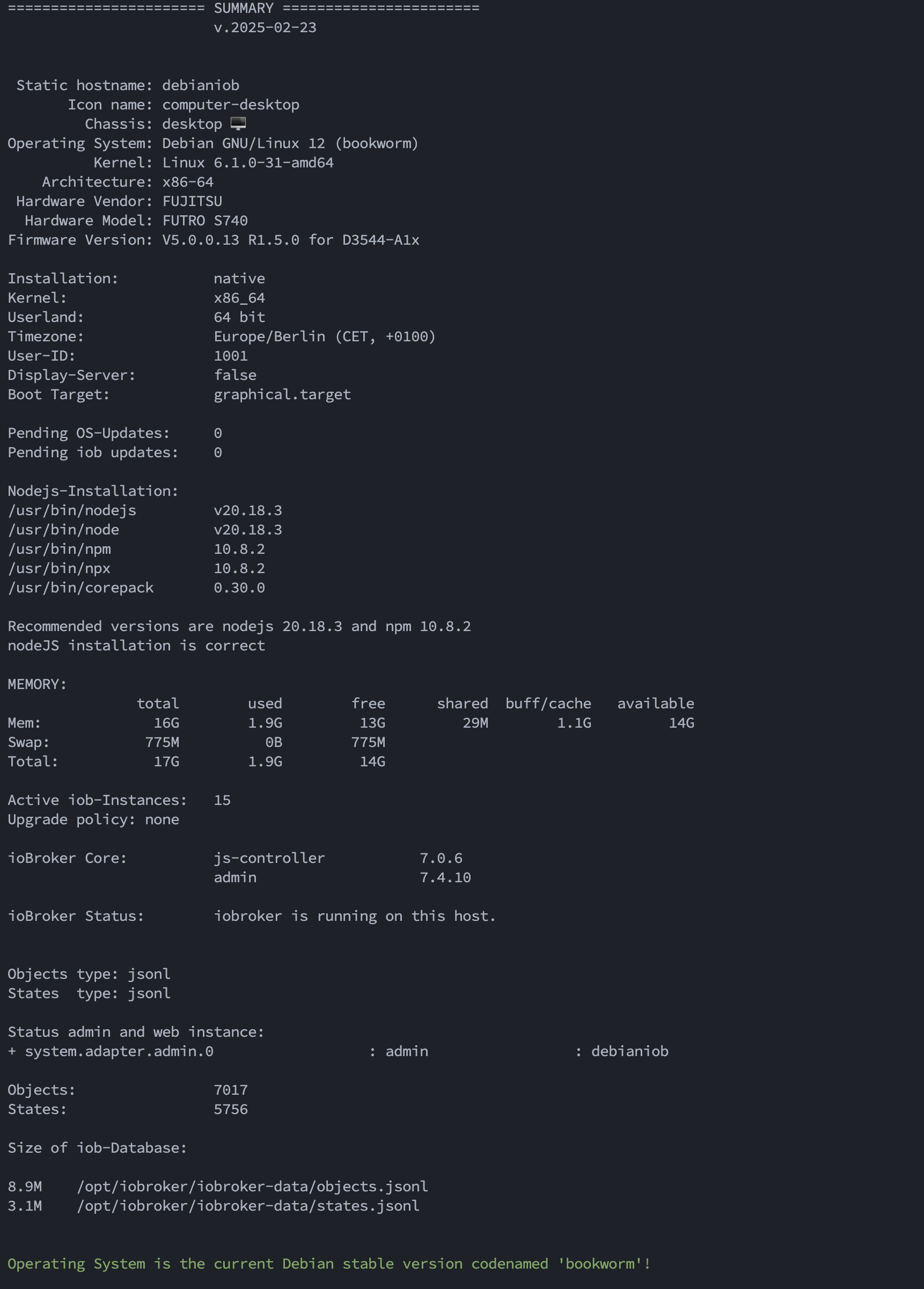

        Könnte eine falsche Installation von nodejs sein. Die Langfassung von
        iob diag
        sagt? Und KEINE Screenshots von Text.

          @thomas-braun
          Script v.2025-02-23
          *** BASE SYSTEM ***
           Static hostname: debianiob
                 Icon name: computer-desktop
                   Chassis: desktop 🖥️
                    Kernel: Linux 6.1.0-31-amd64
              Architecture: x86-64
           Hardware Vendor: FUJITSU
            Hardware Model: FUTRO S740
          Firmware Version: V5.0.0.13 R1.5.0 for D3544-A1x
          OS is similar to:
          model name      : Intel(R) Celeron(R) J4105 CPU @ 1.50GHz
          Docker          : false
          Virtualization  : none
          Kernel          : x86_64
          Userland        : 64 bit
          Systemuptime and Load:
           23:29:36 up 10:32,  2 users,  load average: 0.05, 0.34, 0.27
          CPU threads: 4
          *** LIFE CYCLE STATUS ***
          Operating System is the current Debian stable version codenamed 'bookworm'!
          *** TIME AND TIMEZONES ***
                         Local time: Sat 2025-03-01 23:29:36 CET
                     Universal time: Sat 2025-03-01 22:29:36 UTC
                           RTC time: Sat 2025-03-01 22:29:36
                        NTP service: active
                    RTC in local TZ: no
          *** Users and Groups ***
          User that called 'iob diag':
          peter
          HOME=/home/peter
          GROUPS=peter sudo iobroker
          iobroker
          HOME=/home/iobroker
          GROUPS=iobroker tty dialout audio video plugdev
          *** DISPLAY-SERVER SETUP ***
          Display-Server: false
          Desktop:
          Terminal:       tty
          *** MEMORY ***
          Mem:             16G        1.9G         13G         31M        1.5G         14G
          Swap:           775M          0B        775M
          Total:           17G        1.9G         14G
          Active iob-Instances:   14
                  15762 M total memory
                   1783 M used memory
                    784 M active memory
                   1763 M inactive memory
                  12881 M free memory
                    459 M buffer memory
                    977 M swap cache
                    739 M total swap
                      0 M used swap
                    739 M free swap
          top - 23:29:37 up 10:32,  2 users,  load average: 0.05, 0.34, 0.27
          Tasks: 166 total,   1 running, 165 sleeping,   0 stopped,   0 zombie
          %Cpu(s): 25.0 us,  0.0 sy,  0.0 ni, 75.0 id,  0.0 wa,  0.0 hi,  0.0 si,  0.0 st
          MiB Mem :  15762.3 total,  12881.5 free,   1783.9 used,   1437.1 buff/cache
          MiB Swap:    740.0 total,    740.0 free,      0.0 used.  13978.4 avail Mem
          *** FAILED SERVICES ***
          0 loaded units listed.
          *** DMESG CRITICAL ERRORS ***
          No critical errors detected
          *** FILESYSTEM ***
          udev           devtmpfs  7.7G     0  7.7G   0% /dev
          tmpfs          tmpfs     1.6G  1.5M  1.6G   1% /run
          /dev/sda1      ext4      233G   13G  209G   6% /
          tmpfs          tmpfs     7.7G     0  7.7G   0% /dev/shm
          tmpfs          tmpfs     5.0M  8.0K  5.0M   1% /run/lock
          /dev/sda2      vfat      300M  5.9M  294M   2% /boot/efi
          tmpfs          tmpfs     1.6G   48K  1.6G   1% /run/user/114
          tmpfs          tmpfs     1.6G   44K  1.6G   1% /run/user/1001
          [Sat Mar  1 12:57:07 2025] EXT4-fs (sda1): mounted filesystem with ordered data mode. Quota mode: none.
          [Sat Mar  1 12:57:08 2025] EXT4-fs (sda1): re-mounted. Quota mode: none.
          Show mounted filesystems:
          TARGET      SOURCE    FSTYPE OPTIONS
          /           /dev/sda1 ext4   rw,relatime,errors=remount-ro
          `-/boot/efi /dev/sda2 vfat   rw,relatime,fmask=0077,dmask=0077,codepage=437,iocharset=ascii,shortname=mixed,utf8,errors=remount-ro
          /var:
          3.3G    /var/
          1.9G    /var/cache
          1.8G    /var/cache/apt/archives
          1.8G    /var/cache/apt
          1.3G    /var/log
          Archived and active journals take up 63.8M in the file system.
          /opt/iobroker/backups:
          47M     /opt/iobroker/backups/
          /opt/iobroker/iobroker-data:
          240M    /opt/iobroker/iobroker-data/
          181M    /opt/iobroker/iobroker-data/files
          158M    /opt/iobroker/iobroker-data/files/admin.admin
          157M    /opt/iobroker/iobroker-data/files/admin.admin/custom/static/js
          14M     /opt/iobroker/iobroker-data/objects.jsonl
          7.7M    /opt/iobroker/iobroker-data/states.jsonl
          7.4M    /opt/iobroker/iobroker-data/files/admin.admin/custom/static/js/vendors-node_modules_iobroker_adapter-react-v5_node_modules_mui_icons-material_esm_index_js.d7ed606b.chunk.js.map
          7.0M    /opt/iobroker/iobroker-data/files/admin.admin/custom/static/js/vendors-node_modules_mui_icons-material_esm_index_js.e5b40573.chunk.js.map
          7.0M    /opt/iobroker/iobroker-data/files/admin.admin/custom/static/js/vendors-node_modules_mui_icons-material_esm_index_js.8219fdd8.chunk.js.map
          USB-Devices by-id:
          /dev/serial/by-id/usb-FTDI_FT232R_USB_UART_A50285BI-if00-port0
          zigbee.X
          Extended Pan ID:
          *** MASKED ***
          Pan ID:
          *** MASKED ***
          Channel:
          *** MASKED ***
          Network Key:
          *** MASKED ***
          *** NodeJS-Installation ***
          /usr/bin/nodejs         v20.18.3
          /usr/bin/node           v20.18.3
          /usr/bin/npm            10.8.2
          /usr/bin/npx            10.8.2
          /usr/bin/corepack       0.30.0
          nodejs:
            Installed: 20.18.3-1nodesource1
            Candidate: 20.18.3-1nodesource1
            Version table:
           *** 20.18.3-1nodesource1 1001
                  500 https://deb.nodesource.com/node_20.x nodistro/main amd64 Packages
                  100 /var/lib/dpkg/status
               20.18.2-1nodesource1 1001
               20.18.1-1nodesource1 1001
               20.18.0-1nodesource1 1001
               20.17.0-1nodesource1 1001
               20.16.0-1nodesource1 1001
               20.15.1-1nodesource1 1001
               20.15.0-1nodesource1 1001
               20.14.0-1nodesource1 1001
               20.13.1-1nodesource1 1001
               20.13.0-1nodesource1 1001
               20.12.2-1nodesource1 1001
               20.12.1-1nodesource1 1001
               20.12.0-1nodesource1 1001
               20.11.1-1nodesource1 1001
               20.11.0-1nodesource1 1001
               20.10.0-1nodesource1 1001
               20.9.0-1nodesource1 1001
               20.8.1-1nodesource1 1001
               20.8.0-1nodesource1 1001
               20.7.0-1nodesource1 1001
               20.6.1-1nodesource1 1001
               20.6.0-1nodesource1 1001
               20.5.1-1nodesource1 1001
               20.5.0-1nodesource1 1001
               20.4.0-1nodesource1 1001
               20.3.1-1nodesource1 1001
               20.3.0-1nodesource1 1001
               20.2.0-1nodesource1 1001
               20.1.0-1nodesource1 1001
               20.0.0-1nodesource1 1001
               18.19.0+dfsg-6~deb12u2 500
                  500 http://deb.debian.org/debian bookworm/main amd64 Packages
               18.19.0+dfsg-6~deb12u1 500
                  500 http://security.debian.org/debian-security bookworm-security/main amd64 Packages
          No problems detected
          Errors in npm tree: 0
          *** ioBroker-Installation ***
          ioBroker Status
          Objects type: jsonl
          States  type: jsonl
          Hosts:
          debianiob           debianiob (version: 7.0.6, hostname: debianiob     , alive, uptime: 18737)
          Core adapters versions
          js-controller:  7.0.6
          admin:          7.4.10
          javascript:     "javascript" not found
          nodejs modules from github:     0
          Adapter State
          + system.adapter.admin.0                  : admin                 : debianiob                                -  enabled, port: 8081, bind: 0.0.0.0, run as: admin
          + system.adapter.backitup.0               : backitup              : debianiob                                -  enabled
            system.adapter.discovery.0              : discovery             : debianiob                                - disabled
          + system.adapter.fronius-solarweb.0       : fronius-solarweb      : debianiob                                -  enabled
          + system.adapter.fronius-wattpilot.0      : fronius-wattpilot     : debianiob                                -  enabled
          + system.adapter.fronius.0                : fronius               : debianiob                                -  enabled
                     Chassis: desktop 🖥️
            Installation:           native
            Kernel:                 x86_64
            Userland:               64 bit
            Timezone:               Europe/Berlin (CET, +0100)
            User-ID:                1001
            Boot Target:            multi-user.target
            Pending OS-Updates:     0
            Pending iob updates:    0
            Nodejs-Installation:
            /usr/bin/npm            10.8.2
            /usr/bin/npx            10.8.2
            Recommended versions are nodejs 20.18.3 and npm 10.8.2
            nodeJS installation is correct
            MEMORY:
            Swap:           775M          0B        775M
            Total:           17G        1.9G         14G
            Upgrade policy: none
            ioBroker Core:          js-controller           7.0.6
                                    admin                   7.4.10
            Objects type: jsonl

            so ... iobroker auf einem raspi neu installiert
            mbus läuft hier jetzt wieder
            bzgl. shelly wieder das gleiche Ergebnis:
            shelly0 ist Gen2 - Shelly Pro 1PM Port 1882
            shelly1 ist Gen2 - Shelly Pro 1PM Port 1883
            shelly2 ist Gen2 - Shelly Plus 1PM Port 1884
            shelly0-2 wieder alle das gleiche adminPW und mqttPW, nur auf verschiedenen Ports
            pille0557P 1 Antwort Letzte Antwort
