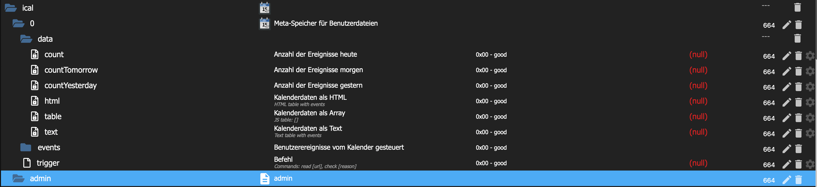

            @marcio Ich würde noch versuchen, die URL in den Grafiken und den Listings zu anonymisieren.... die URL funktioniert im Browser und gibt eine *.ics Datei aus, die man herunterladen kann ....
            Darf denn Dein iobroker ins Internet?
            ist die Adresse denn erreichbar?
            Was sagt denn ein wget aus der Linux-Maschine des iobroker auf die URL
            wget http://p102-caldav.icloud.com/published/2/Mj.............................."

              2024-07-22 14:20:07.951	info	Terminated (NO_ERROR): Without reason
              2024-07-22 14:20:07.950	debug	Plugin sentry destroyed
              2024-07-22 14:20:02.943	info	All calenders could not be processed, Do not clean up events
              2024-07-22 14:20:02.942	warn	Error reading "http://p102-caldav.icloud.com/published/2/Mjxxx6dA": Cannot read URL: "http://p102-caldav.icloud.com/published/2/MjkxODAxxxDcLvG_Iu6dA"
              2024-07-22 14:20:02.941	warn	Error reading from URL "http://p102-caldav.icloud.com/published/2/Mjkxxxx6dA"
              2024-07-22 14:20:02.716	debug	reading calendar from URL: http://p102-caldav.icloud.com/published/2/MjkxODAzxxxvG_Iu6dA, color: #000000
              2024-07-22 14:20:02.570	info	starting. Version 1.15.0 in /opt/iobroker/node_modules/iobroker.ical, node: v20.15.1, js-controller: 5.0.19
              2024-07-22 14:20:02.004	debug	Plugin sentry Initialize Plugin (enabled=true)
              2024-07-22 14:20:01.964	debug	States connected to redis: 127.0.0.1:9000
              2024-07-22 14:20:01.905	debug	States create User PubSub Client
              2024-07-22 14:20:01.903	debug	States create System PubSub Client
              2024-07-22 14:20:01.890	debug	Redis States: Use Redis connection: 127.0.0.1:9000
              2024-07-22 14:20:01.858	debug	Objects connected to redis: 127.0.0.1:9001
              2024-07-22 14:20:01.848	debug	Objects client initialize lua scripts
              2024-07-22 14:20:01.810	debug	Objects create User PubSub Client
              2024-07-22 14:20:01.808	debug	Objects create System PubSub Client
              2024-07-22 14:20:01.805	debug	Objects client ready ... initialize now
              2024-07-22 14:20:01.758	debug	Redis Objects: Use Redis connection: 127.0.0.1:9001
              2024-07-22 14:15:07.926	info	Terminated (NO_ERROR): Without reason
              2024-07-22 14:15:07.925	debug	Plugin sentry destroyed
              2024-07-22 14:15:02.918	info	All calenders could not be processed, Do not clean up events
              2024-07-22 14:15:02.917	warn	Error reading "http://p102-caldav.icloud.com/published/2/MxxxxLvG_Iu6dA": Cannot read URL: "http://p102-caldav.icloud.com/published/2/MjkxODAzNTI2MjkxODAzNYvJNo8h8kCm2kxUdK1-Az79RwSwuRaI3xxxE4gs6c3hDcLvG_Iu6dA"
              2024-07-22 14:15:02.916	warn	Error reading from URL "http://p102-caldav.icloud.com/published/2/Mjkxxxxxs6c3hDcLvG_Iu6dA"

                            @martinp also deine Vermutung lag richtig, der IOB kommt leider nicht ins Internet.
                            Die Datei habe ich erstmal lokal abgelegt und kann per IP zugreifen.
