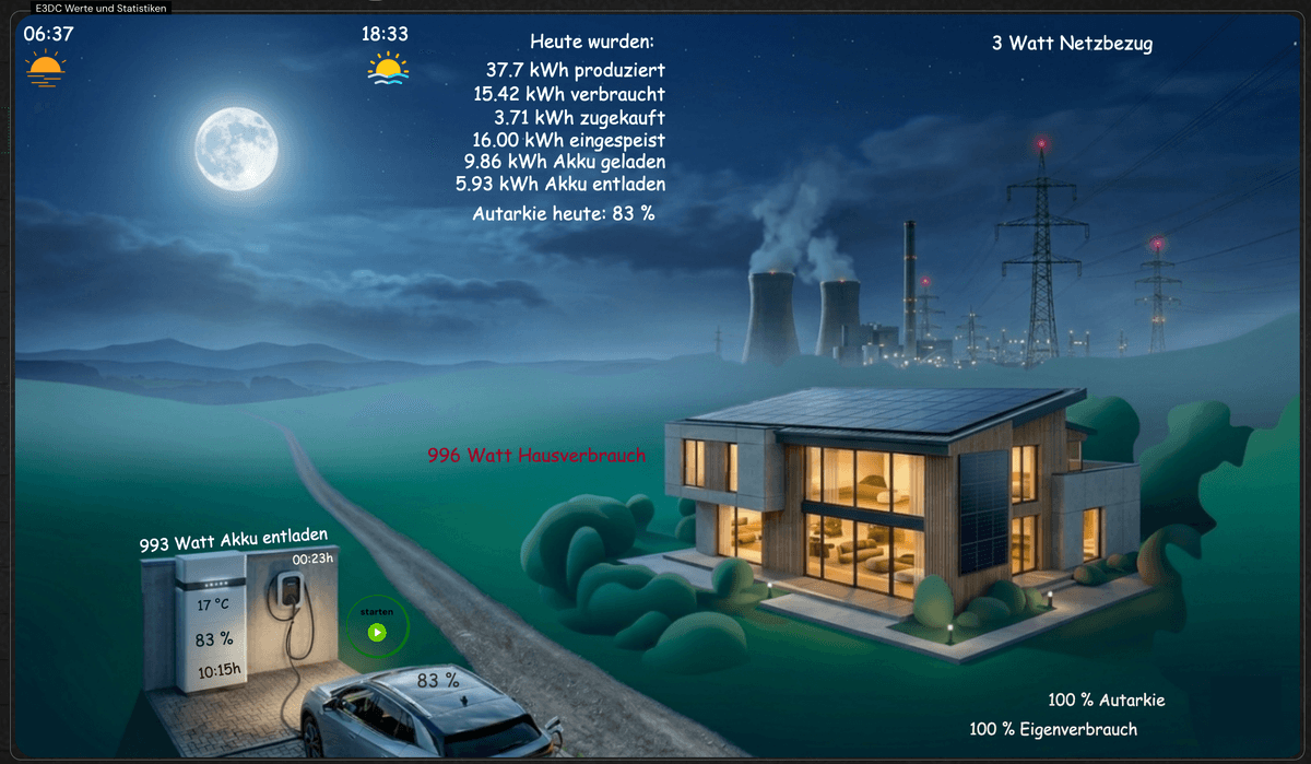

                        Für alle Besitzer einer E3DC Anlage:
                        ich nutze den RSCP Adapter, um die Daten in den iobroker zu ziehen.
                        hier das config file:
                          "basic": {
                            "enable_grid": true,
                            "enable_animation": true,
                            "enable_area_catch": true,
                            "enable_config_icon": false,
                            "enable_last_id": false,
                            "enable_icon_proxy": false,
                            "enable_low_performance": false,
                            "height": 1200,
                            "width": 2000,
                            "styles": "#svg_display{\n background-image: url(\"https://images.unsplash.com/photo-1439792675105-701e6a4ab6f0?q=80&w=4000&auto=format&fit=crop&ixlib=rb-4.0.3&ixid=M3wxMjA3fDB8MHxwaG90by1wYWdlfHx8fGVufDB8fHx8fA%3D%3D");\n height: 100%;\n  width: 100%;\n  background-repeat: no-repeat;\n  background-size: cover;\n  position: absolute;\n  border-radius: 20;\n background-color: #cccccc;\n}\n.glow {\n  animation: glow 3s ease-in-out infinite alternate;\n}\n\n@-webkit-keyframes glow {\n  from {\n    text-shadow: 0 0 10px #fff, 0 0 20px #0000ff, 0 0 30px #0000ff, 0 0 40px #0000ff, 0 0 50px #0000ff, 0 0 60px #0000ff, 0 0 70px #0000ff;\n  }\n  \n  to {\n    text-shadow: 0 0 20px #FFB266, 0 0 30px #FFB266, 0 0 40px #FFB266, 0 0 50px #FFB266, 0 0 60px #FFB266, 0 0 70px #FFB266, 0 0 80px #FFB266;\n    }\n}\n.blink_value {\n  transition: opacity .4s ease-in-out;\n  animation-name: animation_blink;\n  animation-timing-function: ease-in;\n  animation-duration: 1.6s;\n  animation-iteration-count: infinite;\n}\n \n@keyframes animation_blink {\n    50% {\n        opacity: 0.4;\n    }\n}\n#https://cdn.pixabay.com/photo/2019/12/16/22/08/sky-4700394_1280.jpg",
                            "font": {
                              "family": "\"Comic Sans MS\", cursiv",
                              "size": "12",
                              "color": "",
                              "fill": "#171717",
                              "align": "middle"
                            "rect": {
                              "height": 100,
                              "width": 100,
                              "corners": 10
                            "circle": {
                              "radius": 50
                            "elm": {
                              "stroke_width": 2,
                              "color": "",
                              "fill": "",
                              "pos_x": 300,
                              "pos_y": 300
                            "icon": {
                              "height": 24,
                              "width": 24,
                              "color": ""
                            "background_color": "#7A8E8EF5",
                            "enable_show_coordinates": true,
                            "tourVisited": true
                          "calculation": {
                            "battery": {
                              "dod": 68,
                              "capacity": 39,
                              "percent": 6,
                              "charge": 4,
                              "charge_prop": false,
                              "charge_kw": false,
                              "discharge": 4,
                              "discharge_prop": true,
                              "discharge_kw": false
                            "consumption": {
                              "production": [
                                "0"
                              "production_kw": false,
                              "gridFeed": 3,
                              "gridFeed_kw": false,
                              "gridFeed_prop": true,
                              "gridConsume": 3,
                              "gridConsume_kw": false,
                              "gridConsume_prop": false,
                              "batteryCharge": 4,
                              "batteryCharge_kw": false,
                              "batteryCharge_prop": false,
                              "batteryDischarge": 4,
                              "batteryDischarge_kw": false,
                              "batteryDischarge_prop": true
                          "animation": {
                            "stroke_dasharray": "1 10 1 10 1 10 1 10 1 10 1 10 1 10 1 10 1 10 1  36",
                            "stroke_width": 8,
                            "animation_duration": 3500,
                            "stroke_linecap": "round",
                            "animation_timing_function": "linear"
                          "animation_configuration": {
                            "dots": 10,
                            "distance": 10,
                            "length": 1
                          "line": {
                            "stroke_width": 8,
                            "stroke": "#000000"
                          "elements": {
                            "28": {
                              "position": 60,
                              "type": "text",
                              "subType": "datasource",
                              "id": 28,
                              "pos_x": 1187,
                              "pos_y": 578,
                              "color": "none",
                              "fill": "rgb(242, 107, 70)",
                              "font_family": "\"Comic Sans MS\", cursiv",
                              "font_size": 22,
                              "align": "start",
                              "text": "ID 28",
                              "unit": "",
                              "source": 2,
                              "source_option": -1,
                              "source_display": "auto",
                              "shadow": "rgb(196, 196, 196)",
                              "threshold": 0,
                              "calculate_kw": "none",
                              "counter_animation": true,
                              "convert": false,
                              "decimal_places": 0,
                              "action": "none",
                              "subtract": [
                                -1
                              "add": [
                                -1
                              "frame": "_overlay",
                              "override": {
                                ">=1500": {
                                  "fill": "#F20E40"
                              "prepend": "aktuell",
                              "append": "Watt Hausverbrauch",
                              "source_action": 2,
                              "linebreak": 8
                            "52": {
                              "position": 57,
                              "type": "text",
                              "id": 52,
                              "pos_x": 1829,
                              "pos_y": 593,
                              "color": "none",
                              "fill": "rgb(255, 206, 74)",
                              "font_size": 20,
                              "align": "middle",
                              "text": "",
                              "shadow": "",
                              "frame": "_overlay"
                            "54": {
                              "position": 16,
                              "type": "text",
                              "id": 54,
                              "pos_x": 1678,
                              "pos_y": 179,
                              "color": "none",
                              "fill": "rgb(14, 14, 13)",
                              "font_size": 17,
                              "align": "end",
                              "text": "ID 54",
                              "unit": "%",
                              "prepend": "Autarkie aktuell:  ",
                              "source": 9,
                              "source_display": "value",
                              "shadow": "",
                              "threshold": 0,
                              "convert": false,
                              "action": "none",
                              "subtract": [
                                -1
                              "add": [
                                -1
                              "group": 1
                            "56": {
                              "position": 12,
                              "type": "text",
                              "id": 56,
                              "pos_x": 555,
                              "pos_y": 177,
                              "color": "none",
                              "font_size": 17,
                              "align": "end",
                              "text": "ID 56",
                              "unit": "%",
                              "prepend": "Eigenverbrauch aktuell: ",
                              "source": 10,
                              "shadow": "",
                              "threshold": 0,
                              "counter_animation": false,
                              "convert": false,
                              "action": "none",
                              "subtract": [
                                -1
                              "add": [
                                -1
                              "group": 2
                            "125": {
                              "position": 40,
                              "type": "text",
                              "id": 125,
                              "pos_x": 1020,
                              "pos_y": 540,
                              "color": "none",
                              "fill": "rgb(32, 2, 9)",
                              "font_size": 22,
                              "align": "middle",
                              "text": "ID 125",
                              "unit": "W",
                              "source": 4,
                              "shadow": "",
                              "threshold": 0,
                              "convert": true,
                              "action": "none",
                              "subtract": [
                                -1
                              "add": [
                                -1
                              "override": {
                                "<0": {
                                  "fill": "rgb(32,2,9)"
                                ">0": {
                                  "fill": "rgb(0,0,0,0)"
                                "==0": {
                              "source_action": 4
                            "138": {
                              "position": 14,
                              "type": "image",
                              "id": "138",
                              "width": 60,
                              "height": 60,
                              "pos_x": 674,
                              "pos_y": 154,
                              "shadow": "",
                              "source": -1,
                              "threshold": 0,
                              "href": "{daswetter.0.NextDays.Location_1.Day_2.iconURL}",
                              "preserveAspectRatio": "xMidYMid meet",
                              "action": "none"
                            "139": {
                              "position": 17,
                              "type": "text",
                              "id": 139,
                              "pos_x": 695,
                              "pos_y": 577,
                              "color": "none",
                              "font_size": 22,
                              "align": "end",
                              "text": "ID 139",
                              "unit": "",
                              "source": 0,
                              "threshold": 900,
                              "convert": false,
                              "action": "none",
                              "subtract": [
                                -1
                              "add": [
                                -1
                              "override": {
                                "==0": {
                              "prepend": "",
                              "append": "Watt Gesamtproduktion",
                              "source_action": 0,
                              "linebreak": 4,
                              "css_active_positive": "blink_value"
                            "144": {
                              "position": 19,
                              "type": "image",
                              "id": "144",
                              "width": 60,
                              "height": 69,
                              "pos_x": 674,
                              "pos_y": 26,
                              "shadow": "",
                              "source": -1,
                              "threshold": 0,
                              "href": "{daswetter.0.NextDays.Location_1.Day_1.iconURL}",
                              "action": "none"
                            "164": {
                              "position": 11,
                              "type": "text",
                              "id": 164,
                              "pos_x": 694,
                              "pos_y": 752,
                              "color": "none",
                              "fill": "rgb(167, 177, 206)",
                              "font_size": 22,
                              "align": "end",
                              "text": "ID 164",
                              "unit": "",
                              "source": 3,

                                    #57
                                    der Adapter ist mega - bin aktuell aber ganz weg vom "fliessen" - habe jetzt 2 Wallpaper für den Tag und die Nacht, einn CSS Script wechselt die Bilder und die Textfarben :-)) - das ganze ist eingebunden in eine VIS2
                                    Tag:
                                    Nacht:
