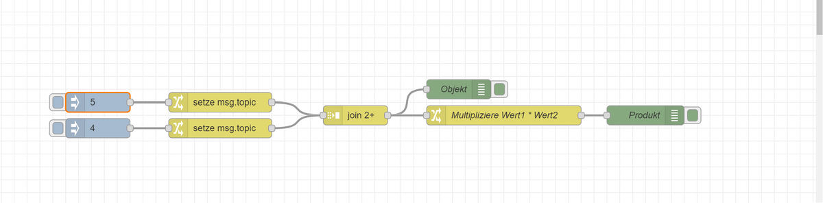

                          @hi Du musst das auf manuell stellen.
                          Das topic ist der Pfad bei der iobroker inNode - ich würde Dir empfehlen ein kurzes topic in Form von 2 Change Nodes zu erstellen. Ich ändere meinen Flow nochmal ab - den kannst Du einfach importieren.
                          hier nochmal zum Import:
                          [{"id":"1294479ebef1d214","type":"inject","z":"27cc87995d951128","name":"","props":[{"p":"payload"}],"repeat":"","crontab":"","once":false,"onceDelay":0.1,"topic":"","payload":"5","payloadType":"num","x":690,"y":1180,"wires":[["be576b4b3863f064"]]},{"id":"9b5cbbe28b4f9881","type":"inject","z":"27cc87995d951128","name":"","props":[{"p":"payload"}],"repeat":"","crontab":"","once":false,"onceDelay":0.1,"topic":"","payload":"4","payloadType":"num","x":690,"y":1220,"wires":[["dfa23b486d6efcce"]]},{"id":"444d72549d7aad6a","type":"join","z":"27cc87995d951128","name":"","mode":"custom","build":"object","property":"payload","propertyType":"msg","key":"topic","joiner":"\\n","joinerType":"str","accumulate":true,"timeout":"","count":"2","reduceRight":false,"reduceExp":"","reduceInit":"","reduceInitType":"","reduceFixup":"","x":1090,"y":1200,"wires":[["c4c7d61f1aadb0d8","b45936755e6c29fa"]]},{"id":"c4c7d61f1aadb0d8","type":"debug","z":"27cc87995d951128","name":"Objekt","active":true,"tosidebar":true,"console":false,"tostatus":false,"complete":"payload","targetType":"msg","statusVal":"","statusType":"auto","x":1250,"y":1160,"wires":[]},{"id":"b45936755e6c29fa","type":"change","z":"27cc87995d951128","name":"Multipliziere Wert1 * Wert2","rules":[{"t":"set","p":"payload","pt":"msg","to":"payload.Wert1 * payload.Wert2","tot":"jsonata"}],"action":"","property":"","from":"","to":"","reg":false,"x":1320,"y":1200,"wires":[["2823bccf62186142"]]},{"id":"2823bccf62186142","type":"debug","z":"27cc87995d951128","name":"Produkt","active":true,"tosidebar":true,"console":false,"tostatus":false,"complete":"payload","targetType":"msg","statusVal":"","statusType":"auto","x":1540,"y":1200,"wires":[]},{"id":"be576b4b3863f064","type":"change","z":"27cc87995d951128","name":"","rules":[{"t":"set","p":"topic","pt":"msg","to":"Wert1","tot":"str"}],"action":"","property":"","from":"","to":"","reg":false,"x":880,"y":1180,"wires":[["444d72549d7aad6a"]]},{"id":"dfa23b486d6efcce","type":"change","z":"27cc87995d951128","name":"","rules":[{"t":"set","p":"topic","pt":"msg","to":"Wert1","tot":"str"}],"action":"","property":"","from":"","to":"","reg":false,"x":880,"y":1220,"wires":[["444d72549d7aad6a"]]}]
                          Mit den ChangeNodes kannst Du eine kurze sprechede Objekteigenschaft erstellen.
                          {"Wert1":5,"Wert2":4}

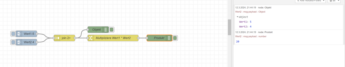

                          • H Hi
                            @mickym
                            ich habe es jetzt so wie oben aufgebaut, jedoch kommt der rechts gezeigte wert die ganze zeit und ich werde nich aus dem manual mode schlau.
                            mickymM Offline
                            mickymM Offline
                            mickym
                            @hi sagte in ioBroker input lesen:
                            Die JOIN Node macht ein Objekt mit einer Objekteigenschaft aus dem topic und dem Wert.
                            In meinem Beispiel sind Wert1 und Wert2 topics - die dann zu Objekteigenschaften des neuen Objektes werden.
