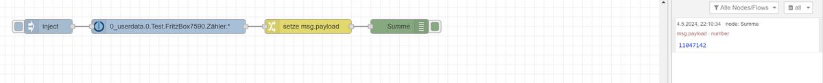

                            • C
                              cbrocker last edited by
                              @mickym
                              hey mickym,
                              ich versuche mich schon geraume Zeit an dem Flow für die Summe von Datenpunkten.
                              Könntest du mir sagen, welche Eigenschaften die nodes haben. Ich komme da nicht weiter.
                              vielen Dank.
                              https://forum.iobroker.net/assets/uploads/files/1708891083341-838bc0d0-fbe3-456b-abb9-d9bfa831bf5d-image.png
                              mickym 1 Reply Last reply Reply Quote 0
                              • mickym
                                mickym Most Active @cbrocker last edited by mickym
                                @cbrocker Du liest mit einer list Node einfach mit Wildcard alle untergeordneten Objekte/Datenpunkte mit den Werten.
                                Anschließend bildest Du einfach die Summe aus den Werten
                                Hier der Flow zum Import:
                                [{"id":"7d1e245379d70cc0","type":"inject","z":"289f539dcc33814e","name":"","props":[{"p":"trigger","v":"true","vt":"bool"}],"repeat":"","crontab":"","once":false,"onceDelay":0.1,"topic":"","x":130,"y":5160,"wires":[["c1364b291413b43e"]]},{"id":"c1364b291413b43e","type":"ioBroker list","z":"289f539dcc33814e","name":"","topic":"0_userdata.0.Test.FritzBox7590.Zähler.*","objType":"state","regex":"","asArray":"true","onlyIDs":"true","withValues":"true","x":380,"y":5160,"wires":[["7ae6b190062293fb","83565c11b43f8064"]]},{"id":"83565c11b43f8064","type":"debug","z":"289f539dcc33814e","name":"Array","active":true,"tosidebar":true,"console":false,"tostatus":false,"complete":"payload","targetType":"msg","statusVal":"","statusType":"auto","x":650,"y":5120,"wires":[]},{"id":"7ae6b190062293fb","type":"change","z":"289f539dcc33814e","name":"","rules":[{"t":"set","p":"payload","pt":"msg","to":"$sum(payload.val)","tot":"jsonata"}],"action":"","property":"","from":"","to":"","reg":false,"x":670,"y":5160,"wires":[["23d459549a7c4a1e"]]},{"id":"23d459549a7c4a1e","type":"debug","z":"289f539dcc33814e","name":"Summe","active":true,"tosidebar":true,"console":false,"tostatus":false,"complete":"payload","targetType":"msg","statusVal":"","statusType":"auto","x":860,"y":5160,"wires":[]}]
                                C 1 Reply Last reply Reply Quote 1

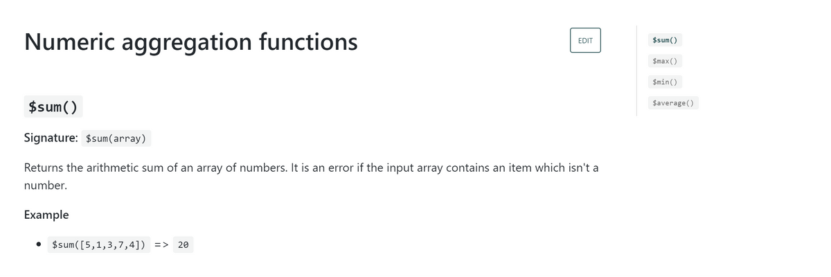

                                      • mickym
                                        @cbrocker Das ist halt die Macht der coolen JSONATA Bibliothek. 😉
                                        Zum einen dass Du aus einem Array von Objekten easy Arrays beliebiger Eigenschaften extrahieren kannst und diese dann mit einer der Aggregatfunktion aufsummieren kannst.
                                        https://docs.jsonata.org/aggregation-functions
                                        C 1 Reply Last reply Reply Quote 0

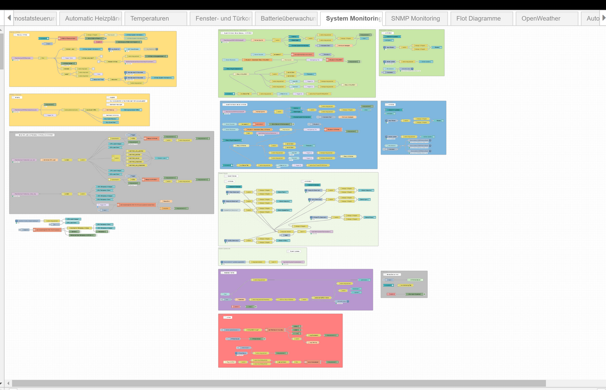

                                          • mickym
                                            @cbrocker sagte in Gelöst: Datenpunkte addieren:
                                            @mickym
                                            ja, den großen Nutzen habe ich schon gecheckt, echt der Hammer, was da möglich ist.
                                            Ist ja mit JS-Blockly viel umständlicher.
                                            Da kann ich mir nun die Nächte mit Node-Red um die Ohren schlagen 🙂
                                            Na ja dann gehörst Du zum auserwählten Kreis derjenigen, die das erkannt haben. 🙂 Die Mehrheit puzzelt lieber.
                                            Und wenn Du Hilfe bei NodeRed brauchst, stehe ich gerne weiter zur Verfügung - auch wenn es sich nur um Verständnisfragen handelt.
                                            C 2 Replies Last reply Reply Quote 0
