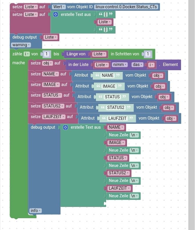

    ich lasse mir in der Shell folgende JSON generieren.
    Gibt's ein Fehler im Aufbau der json?
    [{"IMAGE":"frooodle/s-pdf:latest","STATUS":"Up","LAUFZEIT":"43 hours","STATUS2":"","NAME":"objective_leakey"}{"IMAGE":"jc21/nginx-proxy-manager:latest","STATUS":"Up","LAUFZEIT":"3 days","STATUS2":"","NAME":"nginx-app-1"}{"IMAGE":"linuxserver/heimdall:latest","STATUS":"Up","LAUFZEIT":"5 days","STATUS2":"","NAME":"heimdall"}{"IMAGE":"postgres:14-alpine","STATUS":"Up","LAUFZEIT":"5 days","STATUS2":"","NAME":"planka-postgres-1"}{"IMAGE":"jc21/mariadb-aria:latest","STATUS":"Up","LAUFZEIT":"2 weeks","STATUS2":"","NAME":"nginx-db-1"}{"IMAGE":"ghcr.io/plankanban/planka:latest","STATUS":"Up","LAUFZEIT":"2 weeks","STATUS2":"","NAME":"planka-planka-1"}{"IMAGE":"containrrr/watchtower","STATUS":"Up","LAUFZEIT":"2 weeks","STATUS2":"(healthy)","NAME":"WatchTower"}{"IMAGE":"portainer/portainer-ce:latest","STATUS":"Up","LAUFZEIT":"2 weeks","STATUS2":"","NAME":"portainer"}]
    Leider bemängelt Blockly da was dran.
    script.js.Eigene_Scripte.VIS.Tabelle_Docker: Cannot parse "t"SyntaxError: Unexpected end of JSON input
    Das mit jedem Zeichen der json.
    Oder liegt es am blockly?

      @david-g sagte: Gibt's ein Fehler im Aufbau der json?
      Es fehlen die Kommata zwischen den Objekten.

          Hier das neue json
          [{"IMAGE":"frooodle/s-pdf:latest","STATUS":"Up","LAUFZEIT":"43 hours","STATUS2":"","NAME":"objective_leakey"},{"IMAGE":"jc21/nginx-proxy-manager:latest","STATUS":"Up","LAUFZEIT":"3 days","STATUS2":"","NAME":"nginx-app-1"},{"IMAGE":"linuxserver/heimdall:latest","STATUS":"Up","LAUFZEIT":"5 days","STATUS2":"","NAME":"heimdall"},{"IMAGE":"postgres:14-alpine","STATUS":"Up","LAUFZEIT":"5 days","STATUS2":"","NAME":"planka-postgres-1"},{"IMAGE":"jc21/mariadb-aria:latest","STATUS":"Up","LAUFZEIT":"2 weeks","STATUS2":"","NAME":"nginx-db-1"},{"IMAGE":"ghcr.io/plankanban/planka:latest","STATUS":"Up","LAUFZEIT":"2 weeks","STATUS2":"","NAME":"planka-planka-1"},{"IMAGE":"containrrr/watchtower","STATUS":"Up","LAUFZEIT":"2 weeks","STATUS2":"(healthy)","NAME":"WatchTower"},{"IMAGE":"portainer/portainer-ce:latest","STATUS":"Up","LAUFZEIT":"2 weeks","STATUS2":"","NAME":"portainer"}]
          Jetzt meckert Blockly:
          script.js.Eigene_Scripte.VIS.Tabelle_Docker: Cannot get IMAGE of undefined
          Für die verschiedenen Felder.
          Der link zum Prüfen meint, dass die json okay ist (außer er korrigiert da schon was...)

            @david-g sagte: Jetzt meckert Blockly:
            Man kann nicht über ein JSON iterieren. Mach aus dem JSON erst eine Liste: JSON nach Objekt.

              Danke, jetzt klappt es.
              Immer wieder die selben Stolpersteine.....
