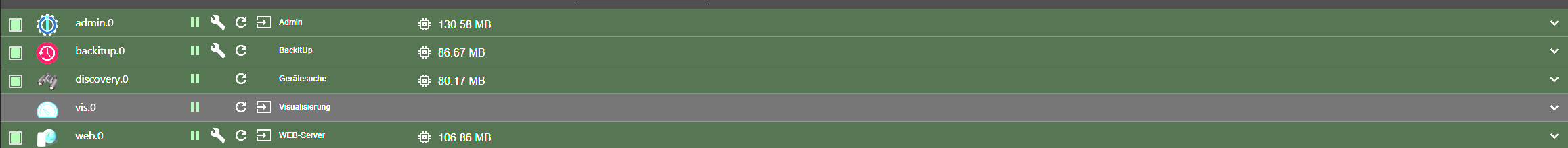

                Habe beide Neuinstalliert
                Opera Momentaufnahme_2023-12-30_165659_192.168.178.76.png Opera Momentaufnahme_2023-12-30_165709_192.168.178.76.png
                • Max 0M Max 0

                  @max-0 bitte iob diag in der Langfassung!

                      + system.adapter.admin.0                  : admin                 : raspberrypi5                             -  enabled, port: 8081, bind: 0.0.0.0, run as: admin
                      + system.adapter.backitup.0               : backitup              : raspberrypi5                             -  enabled
                      + system.adapter.discovery.0              : discovery             : raspberrypi5                             -  enabled
                        system.adapter.vis.0                    : vis                   : raspberrypi5                             -  enabled
                      + system.adapter.web.0                    : web                   : raspberrypi5                             -  enabled, port: 8082, bind: 0.0.0.0, run as: admin
                      + instance is alive

                      2023-12-30 15:42:03.837  - info: admin.0 (915) received all objects
                      2023-12-30 15:42:04.857  - info: admin.0 (915) socket.io server listening on port 8081
                      2023-12-30 15:42:04.860  - info: admin.0 (915) http server listening on port 8081
                      2023-12-30 15:42:04.861  - info: admin.0 (915) Use link "http://127.0.0.1:8081" to configure.
                      2023-12-30 15:42:04.929  - info: host.raspberrypi5 instance system.adapter.discovery.0 started with pid 938
                      2023-12-30 15:42:06.016  - info: discovery.0 (938) starting. Version 4.2.0 in /opt/iobroker/node_modules/iobroker.discovery, node: v18.19.0, js-controller: 5.0.17
                      2023-12-30 15:42:08.930  - info: host.raspberrypi5 instance system.adapter.backitup.0 started with pid 958
                      2023-12-30 15:42:09.916  - info: backitup.0 (958) starting. Version 2.9.8 in /opt/iobroker/node_modules/iobroker.backitup, node: v18.19.0, js-controller: 5.0.17
                      2023-12-30 15:42:09.977  - info: backitup.0 (958) [iobroker] backup will be activated at 02:48 every 1 day(s)
                      2023-12-30 15:42:12.929  - info: host.raspberrypi5 instance system.adapter.web.0 started with pid 973
                      2023-12-30 15:42:13.948  - info: web.0 (973) starting. Version 6.1.10 in /opt/iobroker/node_modules/iobroker.web, node: v18.19.0, js-controller: 5.0.17
                      2023-12-30 15:42:14.040  - info: web.0 (973) socket.io server listening on port 8082
                      2023-12-30 15:42:14.043  - info: web.0 (973) http server listening on port 8082
                      2023-12-30 15:42:17.694  - info: vis.0 (988) starting. Version 1.5.4 in /opt/iobroker/node_modules/iobroker.vis, node: v18.19.0, js-controller: 5.0.17
                      2023-12-30 15:42:18.455  - info: vis.0 (988) Terminated (NO_ERROR): Without reason
                      2023-12-30 15:42:19.004  - info: host.raspberrypi5 instance system.adapter.vis.0 terminated while should be started once
                      2023-12-30 15:42:31.020  - info: admin.0 (915) ==> Connected system.user.admin from ::ffff:192.168.178.109
                      2023-12-30 15:42:31.118  - error: host.raspberrypi5 cannot call visUtils: Not exists
                      2023-12-30 15:42:36.962  - error: host.raspberrypi5 cannot call visUtils: Not exists
                      2023-12-30 15:42:42.183  - info: web.0 (973) ==> Connected system.user.admin from ::ffff:192.168.178.109
                      2023-12-30 15:42:45.358  - info: web.0 (973) <== Disconnect system.user.admin from ::ffff:192.168.178.109 vis.0
                      2023-12-30 15:42:45.630  - info: web.0 (973) ==> Connected system.user.admin from ::ffff:192.168.178.109
                      2023-12-30 15:42:50.459  - info: web.0 (973) <== Disconnect system.user.admin from ::ffff:192.168.178.109 vis.0
                      2023-12-30 15:54:29.081  - info: admin.0 (915) ==> Connected system.user.admin from ::ffff:192.168.178.109
                      2023-12-30 15:54:31.491  - info: admin.0 (915) <== Disconnect system.user.admin from ::ffff:192.168.178.109 web

                        #37
                        @max-0
                        Zeitzone ist wohl falsch.
                        Und nodejs ist auch nicht die richtige Version.
                        https://forum.iobroker.net/topic/71478/plötzliche-probleme-durch-nodejs-dfsg-version
