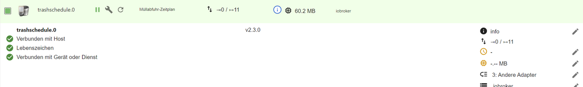

    Hallo liebe Iobroker-Gemeinde,
    ich habe hier in meiner Log einige Fehler. Die ich nicht ganz zuordnen kann.
    Ich habe
    Node.js:
    v18.18.2
    NPM
    9.8.1
    Ich habde den Javascript Instant schon ausgeschaltet, das Problem bleibt.Könnt Ihr mir helfen bitte?
    Hier der Error Code
    host.iobroker
    2023-11-24 18:58:28.786	warn	instance system.adapter.trashschedule.0 terminated due to SIGABRT
    host.iobroker
    2023-11-24 18:58:28.786	error	Caught by controller[10]: 10: 0x1705b39 [/usr/bin/node]
    host.iobroker
    2023-11-24 18:58:28.786	error	Caught by controller[9]: 9: 0x12d85c5 v8::internal::Runtime_StackGuard(int, unsigned long*, v8::internal::Isolate*) [/usr/bin/node]
    host.iobroker
    2023-11-24 18:58:28.786	error	Caught by controller[8]: 8: 0xed7d6f v8::internal::StackGuard::HandleInterrupts() [/usr/bin/node]
    host.iobroker
    2023-11-24 18:58:28.786	error	Caught by controller[7]: 7: 0xf59c15 v8::internal::Heap::HandleGCRequest() [/usr/bin/node]
    host.iobroker
    2023-11-24 18:58:28.786	error	Caught by controller[6]: 6: 0xf56cad v8::internal::Heap::CollectGarbage(v8::internal::AllocationSpace, v8::internal::GarbageCollectionReason, v8::GCCallbackFlags) [/usr/bin/node]
    host.iobroker
    2023-11-24 18:58:28.786	error	Caught by controller[5]: 5: 0xf447c5 [/usr/bin/node]
    host.iobroker
    2023-11-24 18:58:28.786	error	Caught by controller[4]: 4: 0xd670b7 v8::internal::V8::FatalProcessOutOfMemory(v8::internal::Isolate*, char const*, bool) [/usr/bin/node]
    host.iobroker
    2023-11-24 18:58:28.786	error	Caught by controller[3]: 3: 0xd66d10 v8::Utils::ReportOOMFailure(v8::internal::Isolate*, char const*, bool) [/usr/bin/node]
    host.iobroker
    2023-11-24 18:58:28.786	error	Caught by controller[2]: 2: 0xa94834 [/usr/bin/node]
    host.iobroker
    2023-11-24 18:58:28.786	error	Caught by controller[1]: 1: 0xb85bc0 node::Abort() [/usr/bin/node]
    host.iobroker
    2023-11-24 18:58:28.786	error	Caught by controller[0]: FATAL ERROR: Reached heap limit Allocation failed - JavaScript heap out of memory
    host.iobroker
    2023-11-24 18:58:28.786	error	Caught by controller[0]: <--- JS stacktrace --->
    host.iobroker
    2023-11-24 18:58:28.786	error	Caught by controller[0]: i[1345643:0x6d896c0] 564 ms: Mark-sweep (reduce) 19.0 (21.3) -> 18.3 (21.3) MB, 1.9 / 0.0 ms (+ 0.7 ms in 13 steps since start of marking, biggest step 0.1 ms, walltime since start of marking 10 ms) (average mu = 0.914, current mu = 0.777) finalize i[1345643:0x6d896c0] 576 ms: Mark-sweep (reduce) 19.3 (21.3) -> 18.4 (21.8) MB, 2.2 / 0.0 ms (+ 0.9 ms in 14 steps since start of marking, biggest step 0.1 ms, walltime since start of marking 10 ms) (average mu = 0.869, current mu = 0.734) finalize i
    host.iobroker
    2023-11-24 18:58:28.786	error	Caught by controller[0]: <--- Last few GCs --->
    Vielen Dank im Vorraus

      @nicoloma
      Da braucht ein nodejs-Prozess viel zu viel Speicher.
      Gesamtsystem schaut wie aus?
      iob diag
      anschauen.

                                      • NicolomaN Nicoloma
                                        Hallo Jungs und Mädels,
                                        ich habe immer noch das gleiche Problem.
                                        Kann bitte mir einer versuchen nochmal zu helfen. Mein Web adapter bzw VIS funktioniert nicht. Er zeigt keine fehlermeldung im Log an aber ich kann es nicht aufrufen.
                                        Ich wäre euch sehr verbunden

                                          NicolomaN Offline
                                          NicolomaN Offline
                                          Nicoloma
                                          @arteck doch, ich habe den den Adapter sogar schon komplett deaktiviert, die Meldung bleibt gleich.
