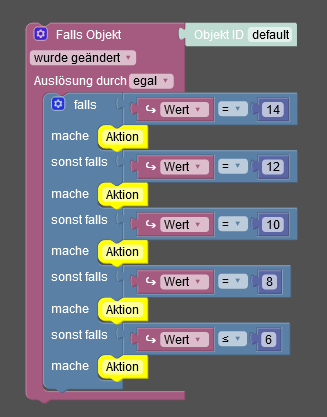

                  !<xml xmlns="https://developers.google.com/blockly/xml">
                    <variables>
                      <variable id="8*5^ofEwK~ZX^(3g_g4I">Ladestrom1</variable>
                    </variables>
                    <block type="on_ext" id="0:l@rhk_Xqs:!aW8H,[U" x="88" y="338">
                      <value name="OID0">
                        <shadow type="field_oid" id="=$7/fm]%pbr?{R94W5Tf">
                          <field name="oid">javascript.0.Amtron_Steuerung.AmtronrechtsLadestrom</field>
                        </shadow>
                      </value>
                      <statement name="STATEMENT">
                        <block type="variables_set" id="75fz7/2PZijN%*~#n2H@">
                          <field name="VAR" id="8*5^ofEwK~ZX^(3g_g4I">Ladestrom1</field>
                          <value name="VALUE">
                            <block type="get_value" id="@L;urS))dD4stZ+*9Ole">
                              <field name="OID">javascript.0.Amtron_Steuerung.AmtronrechtsLadestrom</field>
                            </block>
                          </value>
                          <next>
                            <block type="controls_if" id="M:Il/:.iA+:v84{lU2|;">
                              <value name="IF0">
                                <block type="logic_compare" id="s#10o62Dw[QTAW}*8ZHr">
                                  <field name="OP">EQ</field>
                                  <value name="A">
                                    <block type="get_value" id="3n+!SJGL[#x{)pB~O^|#">
                                    </block>
                                  </value>
                                  <value name="B">
                                    <block type="math_number" id="amg4fCu0h5:[bKdnV:3P">
                                      <field name="NUM">0</field>
                                    </block>
                                  </value>
                                </block>
                              </value>
                              <statement name="DO0">
                                <block type="exec" id="rjk`.p)X)}J_BexM}!5k">
                                  <mutation xmlns="http://www.w3.org/1999/xhtml" with_statement="false"></mutation>
                                  <field name="WITH_STATEMENT">FALSE</field>
                                  <field name="LOG">log</field>
                                  <value name="COMMAND">
                                    <shadow type="text" id="tglTN^nyT#E-do|,iHH;">
                                      <field name="TEXT">curl -d '{ "Permanent": true, "RemoteCurr": 6, "AutoChg": null, "ChgState": "Pause", "Uid": null}' -H "Content-Type: application/json" -X POST http://192.168.160.4:25000/MHCP/1.0/ChargeData?DevKey=445588</field>
                                    </shadow>
                                  </value>
                                </block>
                              </statement>
                              <next>
                                <block type="controls_if" id="Sp?NyW0[$b?$coL~iI,,">
                                  <value name="IF0">
                                    <block type="logic_compare" id="j$HdKDo*n]J@v]z$Z^Ez">
                                      <field name="OP">GT</field>
                                      <value name="A">
                                        <block type="get_value" id="FOvypR:1X${%/ZIYUW7P">
                                        </block>
                                      </value>
                                      <value name="B">
                                        <block type="math_number" id="$r[DQfzR=bwf/w,D?A/L">
                                          <field name="NUM">1</field>
                                        </block>
                                      </value>
                                    </block>
                                  </value>
                                    <block type="exec" id="=XKcY+P:0ZormIN+fUl!">
                                        <shadow type="text" id="4=qWbjz$Y!AFwt/-nJwg">
                                          <field name="TEXT">curl -d '{ "Permanent": true, "RemoteCurr": 6, "AutoChg": null, "ChgState": "Continue", "Uid": null}' -H "Content-Type: application/json" -X POST http://192.168.160.4:25000/MHCP/1.0/ChargeData?DevKey=445588</field>
                                        </shadow>
                                      </value>
                                    </block>
                                  </statement>
                                  <next>

                      @christian23 wie @Thomas-Braun schrieb in Codetags und zusätzlich einen Screenshot vom Skript zeigen
                      Lehrling seit 1975 !!!
                      C 1 Antwort Letzte Antwort
                      • DJMarc75D DJMarc75
                        C Offline
                        C Offline
                        Christian23
                        @djmarc75
                        ich habe den Code in den Codetag gepackt und einen Screenshot angehängt.
                        • C Christian23
                          @djmarc75
                          DJMarc75D Offline
                          DJMarc75D Offline
                          DJMarc75
                          @christian23 sagte in Skripte in der Nacht funktionieren nicht mehr.:
                          das erste Ausrufezeichen bitte entfernen
                          Und einen Screenshot fügt man per
                          ein ;)
                          Dann bitte einen Screenshot von
                          Ich setze über ein anderes Script den Ladestrom.
                          diesem zeigen.
                            ein ;)
                            diesem zeigen.
                            C Offline
                            C Offline
                            Christian23
                            Das hatte ich oben auch gemacht. Hier ist nochmal der Screenshot
                            • C Christian23
                              DJMarc75D Offline
                              DJMarc75D Offline
                              DJMarc75
                              @christian23 Vorschlag:
                              Allerdings hast Du noch "von einem anderen Skript" geschrieben.
                              Darf man das auch sehen ?
                                C Offline
                                C Offline
                                Christian23
                                @djmarc75
                                Das ist das Script zum setzen der Ladeleistung. Das andere Script war nur im log mit einem Fehler. Das andere Script fragt nur die aktuelle Ladeleistung ab.
                                Das komisch ist, dass dieses Script zum setzen der Ladeleitung überhaupt nicht in der Nacht für ca. 3 Stunden reagiert. In dem Script sieht man oben, dass bei einer Änderung des Wertes "AmtronrechtsLadestrom" das Script ausgeführt werden soll.
                                Im Script wird dann der Wert "AmtronrechtsLadestrom" in eine Variable "Ladestrom1" geschrieben. Ganz unten im Script wird mir diese Variable im Log angezeigt, so dass ich sehe wann das Script läuft.
                                Wenn ich den Wert bei "AmtronrechtsLadestrom" manuell ändere läuft das Script einfach nicht los. Das aber jeden Tag erst ab ca. 23:00 Uhr. Der sonstige Tag funktioniert dieses Script.
                                • C Christian23
                                  @djmarc75

                                  @christian23 Warum zeigst Du das andere Skript nicht ? So geheim ?
                                  Ist mir aber auch alles zu kompliziert geschrieben, kapiere da leider recht wenig von Deinem Text.
                                  Wir Helfenden sitzen nicht vor Deinem Monitor ;)
                                  Ich setze über ein anderes Script den Ladestrom. Dieses funktioniert die gesamte Zeit nur in der Nacht für 2-3 Stunden nicht.
                                  Genau DIESES zeigen !
                                  mit dem Tag und Nachmodus vom IO Broker zu tun haben könnte
                                  Wo gibt es denn diesen Modus ?
