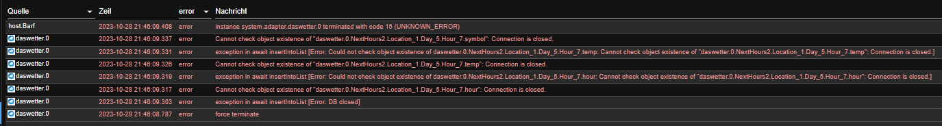

      Hallo
      keine Ahnung wieso und warum, aber die beiden Adapter spinnen seit einigen Tage leider.
      In dem Protokoll steht Folgendes, ständig über 100 Fehlermeldung von den.
      Zeit
      error
      Nachricht
      dwd.0
      2023-08-29 14:49:04.761	error	DB closed
      dwd.0
      2023-08-29 14:49:04.761	error	Error: DB closed at close (/opt/iobroker/node_modules/ioredis/built/redis/event_handler.js:184:25) at Socket.<anonymous> (/opt/iobroker/node_modules/ioredis/built/redis/event_handler.js:151:20) at Object.onceWrapper (node:events:629:26) at Socket.emit (node:events:514:28) at Socket.emit (node:domain:489:12) at TCP.<anonymous> (node:net:323:12)
      dwd.0
      2023-08-29 14:49:04.758	error	unhandled promise rejection: DB closed
      dwd.0
      2023-08-29 14:49:04.758	error	Unhandled promise rejection. This error originated either by throwing inside of an async function without a catch block, or by rejecting a promise which was not handled with .catch().
      eusec.0
      2023-08-29 14:48:47.412	error	Station T8124P2022222014 - All address lookup tentatives failed.
      host.Iobroker-test
      2023-08-29 14:46:28.560	error	instance system.adapter.daswetter.0 terminated with code 15 (UNKNOWN_ERROR)
      daswetter.0
      2023-08-29 14:46:24.676	error	Cannot check object existence of "daswetter.0.NextHours.Location_1.Day_1.Hour_24.wind_symbol": Connection is closed.
      daswetter.0
      2023-08-29 14:46:24.676	error	Cannot check object existence of "daswetter.0.NextHours.Location_1.Day_1.Hour_24.wind_symbolB": Connection is closed.
      daswetter.0
      2023-08-29 14:46:24.675	error	exception in await insertIntoList [Error: Could not check object existence of daswetter.0.NextHours.Location_1.Day_1.Hour_24.iconURL: Cannot check object existence of "daswetter.0.NextHours.Location_1.Day_1.Hour_24.iconURL": Connection is closed.]

          2023-08-29 15:23:06.849  - warn: fb-checkpresence.0 (33265) getWlBlInfo TypeError: Cannot read properties of null (reading 'length')
          2023-08-29 15:24:03.588  - info: javascript.0 (32749) script.js.SolarEgde-Script: Die aktuelle Lesitung der Anlage "2712611" wird verarbeitet.
          2023-08-29 15:24:03.814  - info: dwd.0 (51237) force terminating after 4 minutes
          2023-08-29 15:24:03.815  - info: dwd.0 (51237) Terminated (ADAPTER_REQUESTED_TERMINATION): Without reason
          2023-08-29 15:24:04.504  - error: dwd.0 (51237) Unhandled promise rejection. This error originated either by throwing inside of an async function without a catch block, or by rejecting a promise which was not handled with .catch().
          2023-08-29 15:24:04.504  - error: dwd.0 (51237) unhandled promise rejection: DB closed
          2023-08-29 15:24:04.507  - error: dwd.0 (51237) Error: DB closed
          2023-08-29 15:24:04.507  - error: dwd.0 (51237) DB closed
          2023-08-29 15:24:06.016  - info: dwd.0 (51237) terminating with timeout
          2023-08-29 15:24:08.306  - info: host.Iobroker-test instance system.adapter.dwd.0 terminated with code 11 (ADAPTER_REQUESTED_TERMINATION)
          2023-08-29 15:24:14.456  - info: smartgarden.0 (33801) 3/ on_pong: ++ pong'ed ++
          2023-08-29 15:25:01.008  - warn: fb-checkpresence.0 (33265) getWlBlInfo TypeError: Cannot read properties of null (reading 'length')
          2023-08-29 15:25:03.022  - info: host.Iobroker-test instance system.adapter.dwd.0 started with pid 51552
          2023-08-29 15:25:03.574  - info: javascript.0 (32749) script.js.SolarEgde-Script: Die aktuelle Lesitung der Anlage "2712611" wird verarbeitet.
          2023-08-29 15:25:07.441  - info: javascript.0 (32749) script.js.SolarEgde-Script: Der Energieertrag der Anlage "2712611" wird verarbeitet.
          2023-08-29 15:26:03.493  - info: javascript.0 (32749) script.js.SolarEgde-Script: Die aktuelle Lesitung der Anlage "2712611" wird verarbeitet.
          2023-08-29 15:26:37.247  - info: dwd.0 (51552) starting. Version 2.8.5 in /opt/iobroker/node_modules/iobroker.dwd, node: v18.17.1, js-controller: 4.0.24
          2023-08-29 15:26:44.457  - info: smartgarden.0 (33801) 3/ on_pong: ++ pong'ed ++
          2023-08-29 15:27:03.504  - info: javascript.0 (32749) script.js.SolarEgde-Script: Die aktuelle Lesitung der Anlage "2712611" wird verarbeitet.
          iob diag has finished.

          Das sollte es sein oder
          DJMarc75 2 Replies Last reply Reply Quote 0
          • DJMarc75
            DJMarc75 @Longbow last edited by
            @longbow sagte in DWD und Das Wetter Adapter:
            Ja, aber da scheint ja vieles krumm zu sein... vll kann da mal @Thomas-Braun einen Blick drauf werfen ?!
            Longbow 2 Replies Last reply Reply Quote 0
            • Longbow
              Longbow @DJMarc75 last edited by
              @djmarc75 Also bis jetzt läuft das gut das system... @Thomas-Braun Bi gespannt...
              • Thomas Braun
                Thomas Braun Most Active @Longbow last edited by
                @longbow
                So auf den ersten Blick sehe ich nix wirklich krummes.
                Nur der bemerkenswert hohe Arbeitsspeicherverbrauch fällt auf.
                Relativiert sich aber wieder, wenn man die
