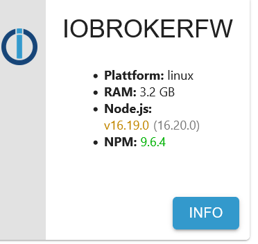

                        Hallo zusammen, letztes Wochenende das System Platt gemacht und Debian11 neu drauf gemacht. Iobroker neu installiert alles ohne Probleme.
                        Leider lässt sich der S7 Adapter immernoch nicht installieren. Vlt könnt ihr nochmal drüber gucken. Danke
                        $ iobroker add s7 auto --host IobrokerFW --debug
                        NPM version: 9.5.1
                        Installing iobroker.s7@1.3.14... (System call)
                        npm ERR! code 1
                        npm ERR! path /opt/iobroker/node_modules/node-snap7
                        npm ERR! command failednpm ERR! command sh -c prebuild-install || node-gyp rebuildnpm ERR! sh: 1: prebuild-install: Permission denied
                        npm ERR! gyp info it worked if it ends with ok
                        npm ERR! gyp info using node-gyp@9.3.1npm ERR! gyp info using node@18.16.0 | linux | x64npm ERR! gyp info find Python using Python version 3.9.2 found at "/usr/bin/python3"npm ERR! gyp info spawn /usr/bin/python3npm ERR! gyp info spawn args [npm ERR! gyp info spawn args '/usr/lib/node_modules/npm/node_modules/node-gyp/gyp/gyp_main.py',npm ERR! gyp info spawn args 'binding.gyp',npm ERR! gyp info spawn args '-f',npm ERR! gyp info spawn args 'make',npm ERR! gyp info spawn args '-I',npm ERR! gyp info spawn args '/opt/iobroker/node_modules/node-snap7/build/config.gypi',npm ERR! gyp info spawn args '-I',
                        npm ERR! gyp info spawn args '/usr/lib/node_modules/npm/node_modules/node-gyp/addon.gypi',npm ERR! gyp info spawn args '-I',npm ERR! gyp info spawn args '/home/iobroker/.cache/node-gyp/18.16.0/include/node/common.gypi',npm ERR! gyp info spawn args '-Dlibrary=shared_library',npm ERR! gyp info spawn args '-Dvisibility=default',npm ERR! gyp info spawn args '-Dnode_root_dir=/home/iobroker/.cache/node-gyp/18.16.0',npm ERR! gyp info spawn args '-Dnode_gyp_dir=/usr/lib/node_modules/npm/node_modules/node-gyp',npm ERR! gyp info spawn args '-Dnode_lib_file=/home/iobroker/.cache/node-gyp/18.16.0/<(target_arch)/node.lib',npm ERR! gyp info spawn args '-Dmodule_root_dir=/opt/iobroker/node_modules/node-snap7',npm ERR! gyp info spawn args '-Dnode_engine=v8',npm ERR! gyp info spawn args '--depth=.',npm ERR! gyp info spawn args '--no-parallel',npm ERR! gyp info spawn args '--generator-output',npm ERR! gyp info spawn args 'build',npm ERR! gyp info spawn args '-Goutput_dir=.'npm ERR! gyp info spawn args ]npm ERR! gyp ERR! build error npm ERR! gyp ERR! stack Error: not found: makenpm ERR! gyp ERR! stack at getNotFoundError (/usr/lib/node_modules/npm/node_modules/node-gyp/node_modules/which/which.js:10:17)npm ERR! gyp ERR! stack at /usr/lib/node_modules/npm/node_modules/node-gyp/node_modules/which/which.js:57:18
                        npm ERR! gyp ERR! stack at new Promise (<anonymous>)npm ERR! gyp ERR! stack at step (/usr/lib/node_modules/npm/node_modules/node-gyp/node_modules/which/which.js:54:21)npm ERR! gyp ERR! stack at /usr/lib/node_modules/npm/node_modules/node-gyp/node_modules/which/which.js:71:22npm ERR! gyp ERR! stack at new Promise (<anonymous>)npm ERR! gyp ERR! stack at subStep (/usr/lib/node_modules/npm/node_modules/node-gyp/node_modules/which/which.js:69:33)npm ERR! gyp ERR! stack at /usr/lib/node_modules/npm/node_modules/node-gyp/node_modules/which/which.js:80:22npm ERR! gyp ERR! stack at /usr/lib/node_modules/npm/node_modules/isexe/index.js:42:5npm ERR! gyp ERR! stack at /usr/lib/node_modules/npm/node_modules/isexe/mode.js:8:5npm ERR! gyp ERR! System Linux 5.10.0-21-amd64npm ERR! gyp ERR! command "/usr/bin/node" "/usr/lib/node_modules/npm/node_modules/node-gyp/bin/node-gyp.js" "rebuild"npm ERR! gyp ERR! cwd /opt/iobroker/node_modules/node-snap7npm ERR! gyp ERR! node -v v18.16.0npm ERR! gyp ERR! node-gyp -v v9.3.1npm ERR! gyp ERR! not oknpm ERR! A complete log of this run can be found in:npm ERR! /home/iobroker/.npm/_logs/2023-04-24T19_19_37_002Z-debug-0.log
                        host.IobrokerFW Cannot install iobroker.s7@1.3.14: 1
                        ERROR: Process exited with code 25
                        Thomas Braun 2 Replies Last reply Reply Quote 0

                                          Was mich aber wundert: Das wird eigentlich soweit ich weiß vom iobroker-Installer mitinstalliert. Hast du den nicht verwendet?
                                          Ich hab die Installation einfach über
                                          curl -sLf https://iobroker.net/install.sh | bash -
                                          angeworfen
                                          • Thomas Braun
                                            Thomas Braun Most Active @Chris20v last edited by
                                            @chris20v sagte in Step7 Adapter Problem bei der Installation:
                                            E: Der dpkg-Prozess wurde unterbrochen; Sie müssen manuell »sudo dpkg --configure -a« ausführen, um das Problem zu beheben.
                                            Das ist ein untrügliches Zeichen für eine unterbrochene Installation.
                                            Lass das immer durchlaufen, nicht wegknallen oder das System hart ausschalten.
