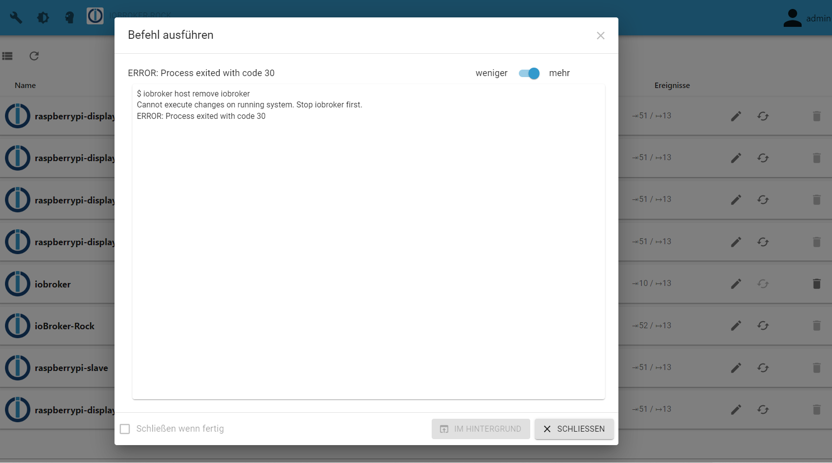

          pi@iobroker:~$ sudo systemctl stop iobroker
          pi@iobroker:~$ sudo systemctl disable iobroker
          Removed /etc/systemd/system/multi-user.target.wants/iobroker.service.
          pi@iobroker:~$ iobroker host remove iobroker
          Cannot execute changes on running system. Stop iobroker first.

              pi@ioBroker-Rock:~$ sudo systemctl stop iobroker
              pi@ioBroker-Rock:~$ htop
              pi@ioBroker-Rock:~$ iobroker host remove iobroker
