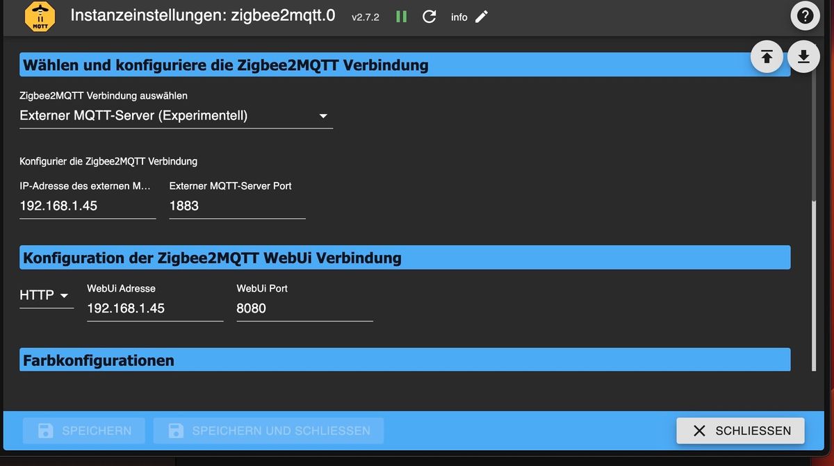

                  Solear
                  @mickym
                  Aber wie soll das gehen.
                  Im zigbee2mqtt - Adapter habe ich auf "externen MQTT -Server" gestellt und auf die Mosquitto-IP gepointed. Login-Daten kann man nicht angeben, deswegen habe ich mosquitto mal auf "erlaube anonymen Zugriff" gestellt.
                  Trotzdem geht es nicht und der Adapter stürzt ab.
                  at MqttClient._handlePacket (/opt/iobroker/node_modules/iobroker.zigbee2mqtt/node_modules/mqtt/lib/client.js:535:12)
                  at work (/opt/iobroker/node_modules/iobroker.zigbee2mqtt/node_modules/mqtt/lib/client.js:438:12)
                  at processTicksAndRejections (node:internal/process/task_queues:78:11)
                  2023-02-04 07:57:04.222 - error: zigbee2mqtt.0 (13866) Unexpected token o in JSON at position 11
                  2023-02-04 07:57:04.222 - error: zigbee2mqtt.0 (13866) Unhandled promise rejection. This error originated either by throwing inside of an async function without a catch block, or by rejecting a promise which was not handled with .catch().
                  2023-02-04 07:57:04.223 - error: zigbee2mqtt.0 (13866) unhandled promise rejection: Unexpected token o in JSON at position 11
                  2023-02-04 07:57:04.223 - error: zigbee2mqtt.0 (13866) SyntaxError: Unexpected token o in JSON at position 11
                  at JSON.parse ()
                  at Zigbee2mqtt.messageParse (/opt/iobroker/node_modules/iobroker.zigbee2mqtt/main.js:135:33)
                  at MqttClient. (/opt/iobroker/node_modules/iobroker.zigbee2mqtt/main.js:95:22)
                  at MqttClient.emit (node:events:513:28)
                  at MqttClient._handlePublish (/opt/iobroker/node_modules/iobroker.zigbee2mqtt/node_modules/mqtt/lib/client.js:1547:12)
                  2023-02-04 07:57:04.223 - error: zigbee2mqtt.0 (13866) Unexpected token o in JSON at position 11
                  2023-02-04 07:57:04.230 - error: zigbee2mqtt.0 (13866) TypeError: mqttClient.close is not a function
                  2023-02-04 07:57:04.335 - error: zigbee2mqtt.0 (13866) TypeError: Cannot read properties of undefined (reading 'allTimerClear')
                  2023-02-04 07:57:04.336 - info: zigbee2mqtt.0 (13866) terminating
                  2023-02-04 07:57:04.336 - warn: zigbee2mqtt.0 (13866) Terminated (UNCAUGHT_EXCEPTION): Without reason
                  2023-02-04 07:57:04.844 - error: zigbee2mqtt.0 (13866) Unhandled promise rejection. This error originated either by throwing inside of an async function without a catch block, or by rejecting a promise which was not handled with .catch().
                  2023-02-04 07:57:04.844 - error: zigbee2mqtt.0 (13866) unhandled promise rejection: DB closed
                  2023-02-04 07:57:04.845 - error: zigbee2mqtt.0 (13866) Error: DB closed
                  at close (/opt/iobroker/node_modules/ioredis/built/redis/event_handler.js:184:25)
                  at Socket. (/opt/iobroker/node_modules/ioredis/built/redis/event_handler.js:151:20)
                  at Object.onceWrapper (node:events:628:26)
                  at Socket.emit (node:events:513:28)
                  at TCP. (node:net:301:12)
                  2023-02-04 07:57:04.845 - error: zigbee2mqtt.0 (13866) DB closed
                  2023-02-04 07:57:04.916 - error: host.iobroker instance system.adapter.zigbee2mqtt.0 terminated with code 6 (UNCAUGHT_EXCEPTION)
                  2023-02-04 07:57:04.917 - info: host.iobroker Restart adapter system.adapter.zigbee2mqtt.0 because enabled
                  Wie gesagt, der normale MQTT-Client-Adapter funktioniert.

                    @solear ok, ich dachte es funktioniert. Ich persönlich nutze auch nur den normalen Mqtt Adapter und bin damit glücklich. Ich mache auch alles mit JSON, wenn du eigene Datenpunkte haben willst, dann habe ich eine Node-Red Flow der Dir jeden JSON in einzelne Datenpunkte zerlegt
                    https://forum.iobroker.net/topic/43856/json-oder-javascript-objekt-in-iobroker-datenpunkte-zerlegen
                    Ansonsten halt nochmal in dem zigbee2mqtt Thread beim Ebtwickler nachfragen, warum das Einbinden nicht klappt.
                    Vielleicht ist nur ein JSON kaputt und der Adapter kann das nicht handeln.
                    Hier 8st der Thread zu dem zigbee2mqtt Adapter: https://forum.iobroker.net/topic/59260/test-adapter-zigbee2mqtt
                    Wie gesagt ich persönlich arbeite nur mit mosquitto und reinem mqtt und arbeite auch gerne mit JSON Strings, damit ist man einfach am unabhängigsten, wenn man die vom unverfälschte Kommunikation verwendet und bei Bedarf nutze ich meinen Flow.
                    • T Nicht stören
                      T Nicht stören
                      toralt
                      @solear websocket und die IP von zigbee2mqtt!! Nicht externer mqtt server.
                      also die gleichen Daten wie bei der WebUI. Für alles weitere direkt im Thread zu diesem Adapter fragen, da bekommst Du schneller Hilfe.
