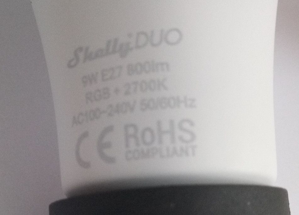

                            Chris 1 @da_Woody last edited by
                            @da_woody
                            Chris 1 1 Reply Last reply Reply Quote 0
