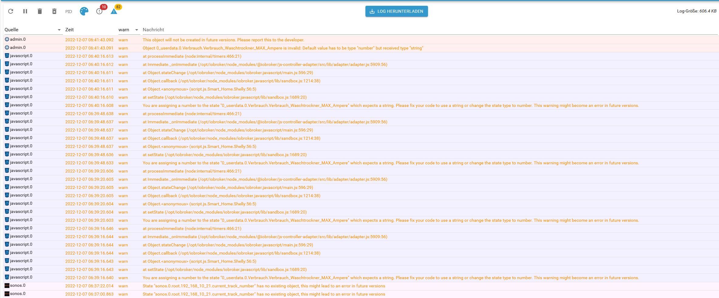

    Guten Tag, aktuell werden mir Warn-Meldungen rausgegeben. Bei dem Benutzerdefinierten-Objekt Wenn ich es als Zeichenkette definiere jammert Javascript und wenn ich es wie Javascript sagt als Zahl definiere, jammert Admin.... Weiß jemand ne lösung? Es wird nur eine Zahl von einem anderen Objekt "kopiert".
    2022-12-07 06:40:16.608 - warn: javascript.0 (2169) You are assigning a number to the state "0_userdata.0.Verbrauch.Verbrauch_Waschtrockner_MAX_Ampere" which expects a string. Please fix your code to use a string or change the state type to number. This warning might become an error in future versions.
    2022-12-07 06:40:16.610 - warn: javascript.0 (2169) at setState (/opt/iobroker/node_modules/iobroker.javascript/lib/sandbox.js:1689:20)
    2022-12-07 06:40:16.611 - warn: javascript.0 (2169) at Object. (script.js.Smart_Home.Shelly:56:5)
    2022-12-07 06:40:16.611 - warn: javascript.0 (2169) at Object.callback (/opt/iobroker/node_modules/iobroker.javascript/lib/sandbox.js:1214:38)
    2022-12-07 06:40:16.611 - warn: javascript.0 (2169) at Object.stateChange (/opt/iobroker/node_modules/iobroker.javascript/main.js:596:29)
    2022-12-07 06:40:16.612 - warn: javascript.0 (2169) at Immediate._onImmediate (/opt/iobroker/node_modules/@iobroker/js-controller-adapter/src/lib/adapter/adapter.js:5909:56)
    2022-12-07 06:40:16.613 - warn: javascript.0 (2169) at processImmediate (node:internal/timers:466:21)
    2022-12-07 06:41:43.091 - warn: admin.0 (2081) Object 0_userdata.0.Verbrauch.Verbrauch_Waschtrockner_MAX_Ampere is invalid: Default value has to be type "number" but received type "string"
    2022-12-07 06:41:43.092 - warn: admin.0 (2081) This object will not be created in future versions. Please report this to the developer.

                        @codierknecht Habe es auf 0 geändert und beim Speichern kom wieder die Meldung:
                        admin.0 - 2022-12-07 09:57:29.161 warn This object will not be created in future versions. Please report this to the developer.
                        admin.0 - 2022-12-07 09:57:29.160 warn Object 0_userdata.0.Verbrauch.Verbrauch_Waschtrockner_MAX_Ampere is invalid: Default value has to be type "number" but received type "string"
                          "common": {
                            "name": "Verbrauch Waschtrockner_MAX_Ampere",
                            "desc": "Manuell erzeugt",
                            "role": "state",
                            "unit": "A",
                            "type": "number",
                            "read": true,
                            "write": true,
                            "def": "0"
                          "type": "state",
                          "native": {},
                          "_id": "0_userdata.0.Verbrauch.Verbrauch_Waschtrockner_MAX_Ampere",
                          "acl": {
                            "object": 1636,
                            "state": 1636,
                            "owner": "system.user.admin",
                          "user": "system.user.admin",
                          "ts": 1670403449159
                        @jndmnk sagte: "def": "0"
                        Ohne Anführungszeichen!
                        "def": 0

                          @paul53 ah ok jetzt kam keine meldung mehr, danke :)

                            @jndmnk
                            Bitte in Zukunft keine Screenshots von Text. und die Textausgaben in code-tags posten!
                            BTW es geht um Typ, nicht um Rolle.
