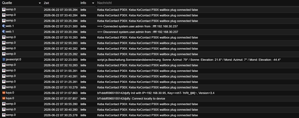

  • Q Qlink
    @rene_hm
    Alles klar. Hab ich entsprechend umgestellt.
    Nein, es kommen keine Fehlermeldungen des Adapters.
    Auch auf debug schaut das log nicht großartig anders aus (für mich):
    semp.0 2026-06-25 17:45:47.817	info	Keba KeContact P30X: Keba KeContact P30X wallbox plug connected true
    semp.0 2026-06-25 17:45:32.818	info	Keba KeContact P30X: Keba KeContact P30X wallbox plug connected true
    semp.0 2026-06-25 17:45:17.814	info	Keba KeContact P30X: Keba KeContact P30X wallbox plug connected true
    semp.0 2026-06-25 17:45:02.816	info	Keba KeContact P30X: Keba KeContact P30X wallbox plug connected true
    semp.0 2026-06-25 17:44:55.655	info	State value to set for "semp.0.Devices.Keba KeContact P30X.TimeFrames.1.RemainingMaxEnergy" has to be type "number" but received type "string"
    semp.0 2026-06-25 17:44:47.813	info	Keba KeContact P30X: Keba KeContact P30X wallbox plug connected true
    semp.0 2026-06-25 17:44:32.810	info	Keba KeContact P30X: Keba KeContact P30X wallbox plug connected true
    javascript.0 2026-06-25 17:44:23.005	info	script.js.Beschattung.Sonnenstandsberechnung: Sonne: Azimut: 272° / Sonne: Elevation: 30.6° / Mond: Azimut: 127° / Mond: Elevation: 3°
    semp.0 2026-06-25 17:44:17.812	info	Keba KeContact P30X: Keba KeContact P30X wallbox plug connected true
    semp.0 2026-06-25 17:44:02.812	info	Keba KeContact P30X: Keba KeContact P30X wallbox plug connected true
    semp.0 2026-06-25 17:43:55.377	info	State value to set for "semp.0.Devices.Keba KeContact P30X.TimeFrames.1.RemainingMaxEnergy" has to be type "number" but received type "string"
    semp.0 2026-06-25 17:43:47.811	info	Keba KeContact P30X: Keba KeContact P30X wallbox plug connected true
    semp.0 2026-06-25 17:43:32.811	info	Keba KeContact P30X: Keba KeContact P30X wallbox plug connected true
    semp.0 2026-06-25 17:43:19.936	info	SempServer: adapter discovered by SHM
    semp.0 2026-06-25 17:43:17.817	info	Keba KeContact P30X: Keba KeContact P30X wallbox plug connected true
    semp.0 2026-06-25 17:43:16.950	info	Keba KeContact P30X: Keba KeContact P30X wallbox plug connected true
    semp.0 2026-06-25 17:43:16.905	info	Keba KeContact P30X: device created F-00000000-000000000001-00 Keba KeContact P30X
    semp.0 2026-06-25 17:43:16.871	info	starting. Version 2.0.12 in /opt/iobroker/node_modules/iobroker.semp, node: v22.21.0, js-controller: 7.2.2
    host.iobroker 2026-06-25 17:43:14.067	info	instance system.adapter.semp.0 in version "2.0.12" started with pid 21269
    host.iobroker 2026-06-25 17:43:10.715	info	instance system.adapter.semp.0 terminated with code 11 (ADAPTER_REQUESTED_TERMINATION)
    semp.0 2026-06-25 17:43:10.558	info	terminating
    admin.0 2026-06-25 17:43:10.281	info	<== Disconnect system.user.admin from ::ffff:192.168.30.222 semp
    semp.0 2026-06-25 17:43:10.063	info	Terminated (ADAPTER_REQUESTED_TERMINATION): Without reason
    semp.0 2026-06-25 17:43:10.062	debug	Plugin sentry destroyed
    semp.0 2026-06-25 17:43:10.061	info	terminating
    semp.0 2026-06-25 17:43:10.060	debug	Gateway: gateway stopped...
    semp.0 2026-06-25 17:43:10.060	debug	Gateway: SSDPServer stopped
    semp.0 2026-06-25 17:43:10.057	debug	SempServer: SEMP server stopped
    semp.0 2026-06-25 17:43:10.057	debug	Gateway: delete all devices
    semp.0 2026-06-25 17:43:10.056	info	Got terminate signal TERMINATE_YOURSELF
    host.iobroker 2026-06-25 17:43:10.056	info	stopInstance system.adapter.semp.0 send kill signal
    host.iobroker 2026-06-25 17:43:10.052	info	stopInstance system.adapter.semp.0 (force=false, process=true)
    semp.0 2026-06-25 17:43:07.392	debug	SempServer: description xml sent <?xml version="1.0" encoding="utf-8" standalone="yes" ?><root xmlns="urn:schemas-upnp-org:device-1-0"><specVersion><major>1</major><minor>0</minor></specVersion><device><deviceType>urn:schemas-simple-energy-management-protocol:device:Gateway:1</deviceType><friendlyName>ioBroker Gateway</friendlyName><manufacturer>ioBroker</manufacturer><manufacturerURL>www.iobroker.net</manufacturerURL><modelDescription>interface to ioBroker</modelDescription><modelName>Semp_Gateway</modelName><modelNumber>0.1</modelNumber > <modelURL>www.iobroker.net</modelURL><UDN>uuid:F-00000000-000000000001-00</UDN><semp:X_SEMPSERVICE xmlns:semp="urn:schemas-simple-energy-management-protocol:service-1-0"><semp:server>http://192.168.30.90:9765</semp:server><semp:basePath>/semp</semp:basePath><semp:transport>HTTP/Pull</semp:transport><semp:exchangeFormat>XML</semp:exchangeFormat><semp:wsVersion>1.1.5</semp:wsVersion></semp:X_SEMPSERVICE></device></root>
    semp.0 2026-06-25 17:43:07.391	debug	SempServer: SHM requested description
    semp.0 2026-06-25 17:43:07.357	debug	SempServer: description xml sent <?xml version="1.0" encoding="utf-8" standalone="yes" ?><root xmlns="urn:schemas-upnp-org:device-1-0"><specVersion><major>1</major><minor>0</minor></specVersion><device><deviceType>urn:schemas-simple-energy-management-protocol:device:Gateway:1</deviceType><friendlyName>ioBroker Gateway</friendlyName><manufacturer>ioBroker</manufacturer><manufacturerURL>www.iobroker.net</manufacturerURL><modelDescription>interface to ioBroker</modelDescription><modelName>Semp_Gateway</modelName><modelNumber>0.1</modelNumber > <modelURL>www.iobroker.net</modelURL><UDN>uuid:F-00000000-000000000001-00</UDN><semp:X_SEMPSERVICE xmlns:semp="urn:schemas-simple-energy-management-protocol:service-1-0"><semp:server>http://192.168.30.90:9765</semp:server><semp:basePath>/semp</semp:basePath><semp:transport>HTTP/Pull</semp:transport><semp:exchangeFormat>XML</semp:exchangeFormat><semp:wsVersion>1.1.5</semp:wsVersion></semp:X_SEMPSERVICE></device></root>
    semp.0 2026-06-25 17:43:07.357	debug	SempServer: SHM requested description
    semp.0 2026-06-25 17:43:07.332	debug	SempServer: description xml sent <?xml version="1.0" encoding="utf-8" standalone="yes" ?><root xmlns="urn:schemas-upnp-org:device-1-0"><specVersion><major>1</major><minor>0</minor></specVersion><device><deviceType>urn:schemas-simple-energy-management-protocol:device:Gateway:1</deviceType><friendlyName>ioBroker Gateway</friendlyName><manufacturer>ioBroker</manufacturer><manufacturerURL>www.iobroker.net</manufacturerURL><modelDescription>interface to ioBroker</modelDescription><modelName>Semp_Gateway</modelName><modelNumber>0.1</modelNumber > <modelURL>www.iobroker.net</modelURL><UDN>uuid:F-00000000-000000000001-00</UDN><semp:X_SEMPSERVICE xmlns:semp="urn:schemas-simple-energy-management-protocol:service-1-0"><semp:server>http://192.168.30.90:9765</semp:server><semp:basePath>/semp</semp:basePath><semp:transport>HTTP/Pull</semp:transport><semp:exchangeFormat>XML</semp:exchangeFormat><semp:wsVersion>1.1.5</semp:wsVersion></semp:X_SEMPSERVICE></device></root>
    semp.0 2026-06-25 17:43:07.331	debug	SempServer: SHM requested description
    admin.0 2026-06-25 17:43:07.074	info	==> Connected system.user.admin from ::ffff:192.168.30.222
    semp.0 2026-06-25 17:43:04.364	info	Loglevel changed from "info" to "debug"

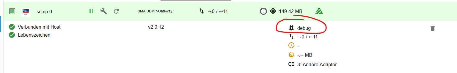

      @rene_hm
      Alles klar.
      Hab nochmal auf debug umgestellt jetzt steht schon mehr im log:

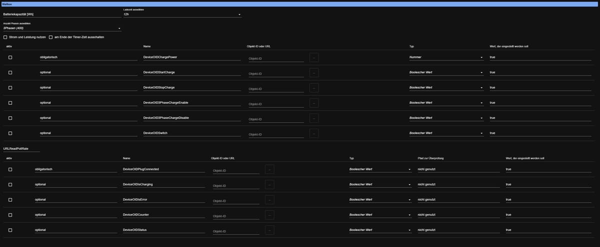

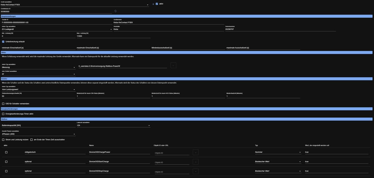

        und hier noch der output von der URL:

          @rene_hm
          ich hab die DeviceID nun angepasst, hat aber leider am Verhalten nichts geändert:
          semp.0
          2026-07-02 15:12:05.273	info	Keba KeContact P30X: Keba KeContact P30X wallbox plug connected true
          semp.0
          2026-07-02 15:11:56.482	info	State value to set for "semp.0.Devices.Keba KeContact P30X.TimeFrames.1.RemainingMaxEnergy" has to be type "number" but received type "string"

            @Qlink sagte:
            ja und gleichzeitig wieder debug abgeschaltet...

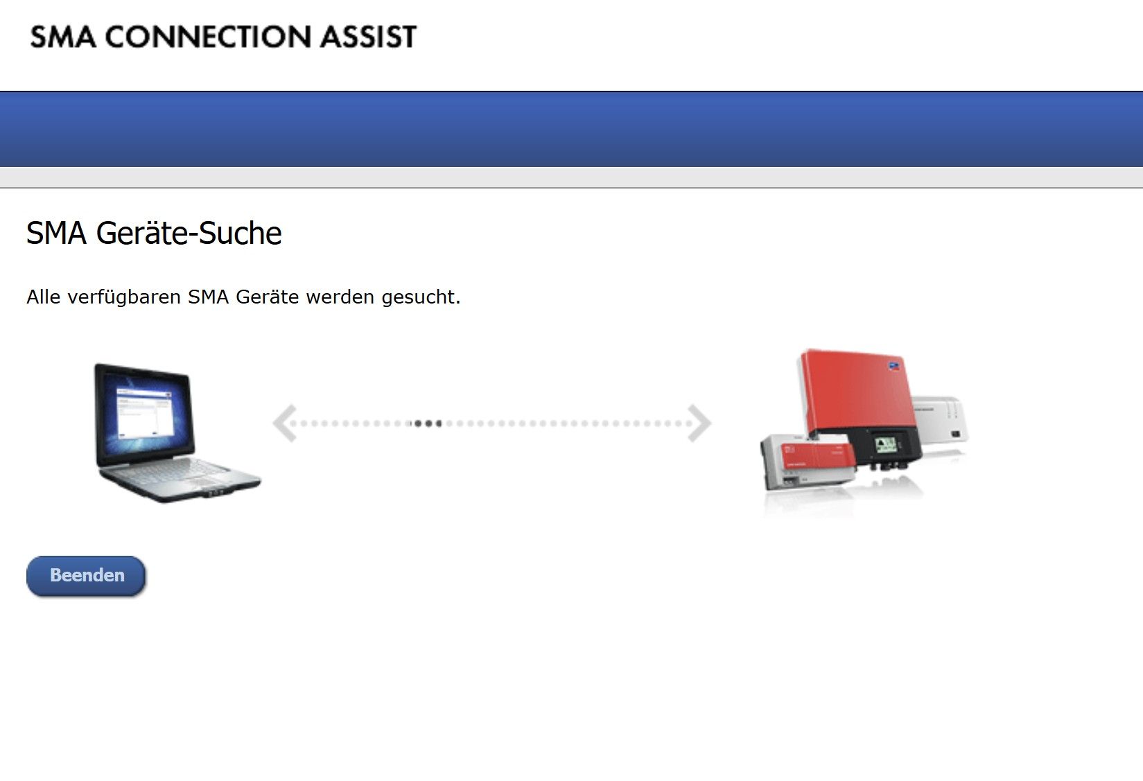

            schon mal die logs auf dem SHM selbst angeschaut?
            https://github.com/rg-engineering/ioBroker.semp/blob/master/docu/connection_assist/connection_assist_de.md

              @rene_hm
              Hier nochmal der Log Output mit debug aktiviert:
              2026-07-05 20:11:29.145 - info: semp.0 (9778) Keba KeContact P30X: Keba KeContact P30X wallbox plug connected false

                    Rene_HMR Offline
                    Rene_HMR Offline
                    Rene_HM
                    #257
                    @Qlink eigentlich sieht jetzt das xml gut aus. Ich sehe keinen offensichtlichen Fehler mehr.
                    Hast du schon mal versucht, das log vom SHM selbst anzuschauen?
                    Ich hatte das unter
                    beschrieben...
                    • Q Offline
                      Q Offline
                      Qlink
                      #258
                      @rene_hm
                      Der findet gar keine Geräte bei mir im Netzwerk, obwohl ich den SHM vom selben Rechner aus pingen kann
                      Rene_HMR 1 Antwort Letzte Antwort
                      • Q Qlink
                        @rene_hm
                        Rene_HMR Offline
                        Rene_HMR Offline
                        Rene_HM
                        schrieb am zuletzt editiert von Rene_HM
                        #259
                        @Qlink du bist per Kabel und nicht per WLAN verbunden? Hast du weitere Router oder switche zwischen deinem PC und dem SHM? Ideal ist, den PC an den switch zu verbinden, an dem auch der SHM angeschlossen ist. Jeder switch oder Router zwischen PC und SHM kann die discover-Messages im Netzwerk verwerfen, so dass sie nicht am Ziel ankommen. Ping hat nichts zu bedeuten, die discover-Messages verwenden ein anderes Protokoll...
                        • Q Offline
                          Q Offline
                          Qlink
                          #260
                          @rene_hm auch per Kabel am selben Switch wo der SHM hängt findet der Connection Assist keine SMA Geräte, obwohl selbes Subnet. IGMP Snooping am Unifi UCG deaktiviert... Keine Ahnung was ich noch probieren kann...
                          • Q Qlink
                            Rene_HMR Offline
                            Rene_HMR Offline
                            Rene_HM
                            #261
                            @Qlink Ich hatte jetzt endlich die chance, das auch hier in einem setup auszuprobieren, wo connection_assist nichts findet. Bist du vertraut mit wireshark? Dann könnten wir es darüber analysieren.
                            Ein Thema bei mir war, dass ich weitere Netzwerk-Adapter verfügbar aber inaktiv hatte. Ich habe alle unter Systemsteuerung\Netzwerk und Internet\Netzwerkverbindungen deaktiviert, nur den Ethernet Adapter aktiv gelassen, wo das Netzwerkkabel angesteckt war. Damit hat connection_assist schon mal die Wechselrichter gefunden. Ich habe dann in der Firewall auf dem Windows-Laptop den Port 9522 für UDP eingehend geöffnet. Damit kam dann auch der SHM durch...
                            • Q Offline
                              Q Offline
                              Qlink
                              #262
                              @rene_hm
                              Deine Hinweise und Tipps hätte ich nun auch alles probiert, aber leider ohne Erfolg. Egal was ich anstelle, WR + SHM lassen sich pingen, aber per Connection Assist werden sie nicht gefunden. Lässt sich ohne dem SHM Log dem Problem nicht auch anders auf die Spur kommen ?

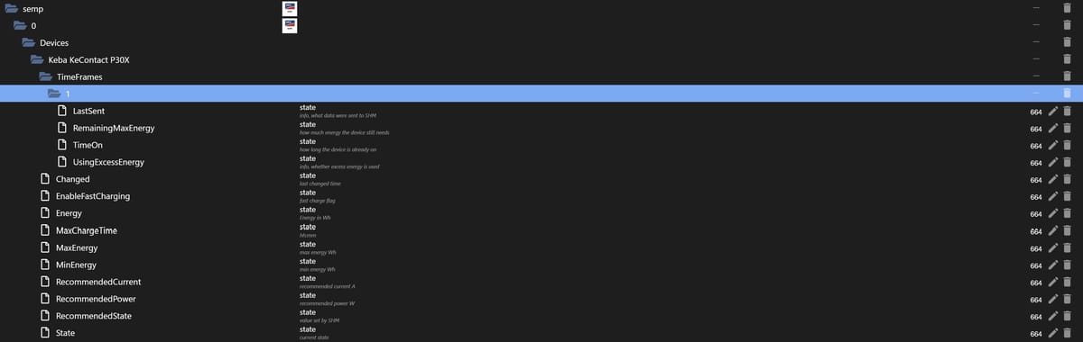

                                #263
                                Hallo Rene_HM, ich habe den aktuellen Adapter in Nutzung, dieser funktioniert für meine Begriffe nicht ganz zuverlässig. Ich kann aber nicht sagen ob das am Adapter, am SHM2.0 oder am enoxOS liegt. Zumindest tauchen immer wieder Karteileichen von früheren Versuchen mit der älteren Version im Portal bei der Gerätesuche auf. Den Adapter habe ich komplett neu installiert und wieder neu konfiguriert, den SHM2.0 habe ich auf Werkseinstellungen zurückgesetzt und neu eingebunden. Ich vermute es liegt am ennoxOS.
                                Aber nun erst einmal einige bugs, welche ich festgestellt habe:
                                • sobald ich ein Gerät neu erstelle, werden bei sämtlichen Objekteinträgen die Datenpunkte falsch konfiguriert. Hier scheint eine Verwechslung zwischen "type" und "name" drin zu sein. Iobroker bringt dabei folgende Warnung:
                                semp.0	2026-08-18 11:21:37.687	warn	Object semp.0.Devices.Geschirrspueler.State is invalid: obj.type has an invalid value (current State) but has to be one of state, channel, device, enum, host, adapter, instance, meta, config, script, user, group, chart, folder, schedule, design This will throw an error up from js-controller version 7.0.0!
                                hier die Objekteigenschaften:
                                  "type": "current State",
                                  "common": {
                                    "name": "state",
                                    "role": "state",
                                    "type": "string",
                                    "unit": "",
                                richtig müsste vermutlich sein:
                                  "type": "state",
                                  "common": {
                                    "name": "current State",
                                    "role": "state",
                                    "type": "string",
                                    "unit": "",
                                • Dann habe ich noch entdeckt, das der Punkt "Unterbrechung erlaubt" erst einmal aktiviert und dann wieder deaktiviert werden muß, damit das Protokoll richtig erstellt wird. Andernfalls ist bei der WEB-Analyse (http://<IP>:9765/semp) der Übergabewert <interruptionsallowed> LEER und nicht FALSE.
                                <deviceinfo>
                                        <capabilities>
                                            <interruptions>
                                                <interruptionsallowed></interruptionsallowed>
                                            </interruptions>
                                        </capabilities>
                                    </deviceinfo>
                                ob das allerdings negative Auswirkungen hat weis ich nicht.
