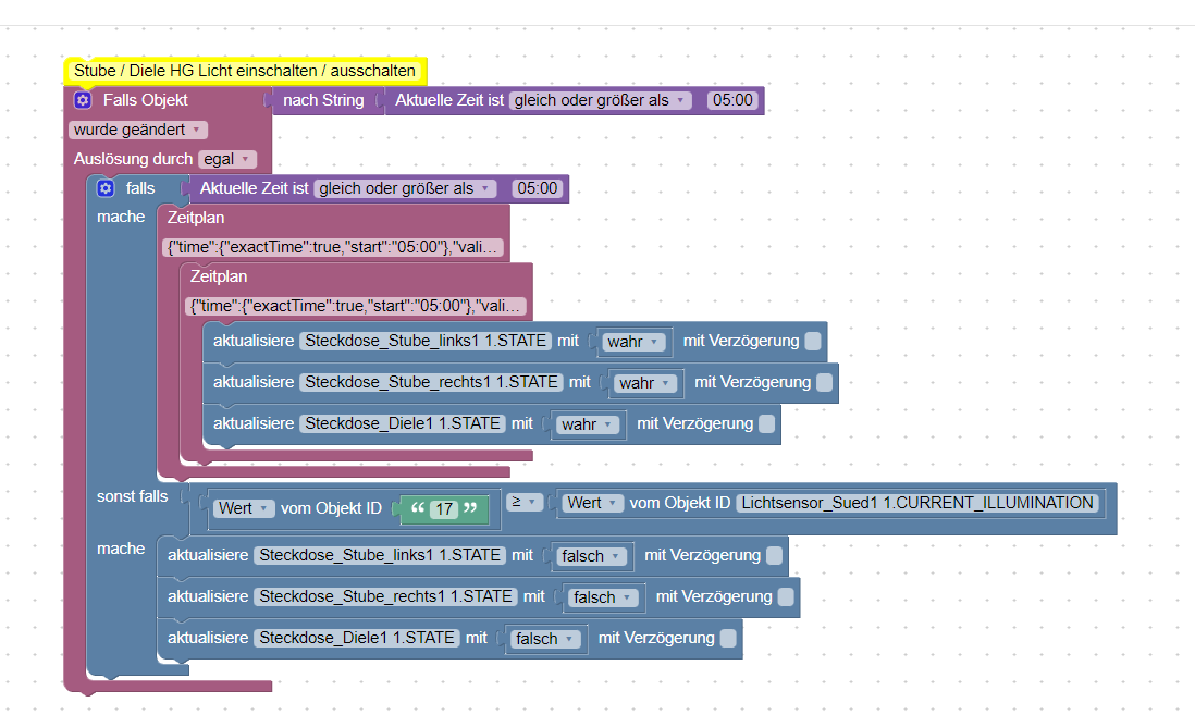

    Moin @all
    Mein erstes Blockly Script, bin absoluter Anfänger.
    // Stube / Diele HG Licht einschalten / ausschalten
    on({id: [].concat(('' + compareTime("05:00", "null", ">="))), change: "ne"}, async function (obj) {
      var value = obj.state.val;
      if (compareTime("05:00", "null", ">=")) {
        schedule('{"time":{"exactTime":true,"start":"05:00"},"valid":{"to":"20.04.3000"},"period":{"days":1,"dows":"[1,2,3,4,5]"}}', async function () {
          schedule('{"time":{"exactTime":true,"start":"05:00"},"valid":{"to":"20.04.3000","from":"24.09.2022"},"period":{"months":"[1,2,3,4,9,10,11,12]"}}', async function () {
            setState("hm-rpc.0.0001D3C99C2CF1.2.STATE"/*Steckdose_Stube_links1 1.STATE*/, true, true);
            setState("hm-rpc.0.0001D3C99C2D31.2.STATE"/*Steckdose_Stube_rechts1 1.STATE*/, true, true);
            setState("hm-rpc.0.0001D3C99CBF6E.2.STATE"/*Steckdose_Diele1 1.STATE*/, true, true);
      } else if (getState('17').val >= getState("hm-rpc.0.000D5A499AFE23.1.CURRENT_ILLUMINATION").val) {
        setState("hm-rpc.0.0001D3C99C2CF1.2.STATE"/*Steckdose_Stube_links1 1.STATE*/, false, true);
        setState("hm-rpc.0.0001D3C99C2D31.2.STATE"/*Steckdose_Stube_rechts1 1.STATE*/, false, true);
        setState("hm-rpc.0.0001D3C99CBF6E.2.STATE"/*Steckdose_Diele1 1.STATE*/, false, true);
    //JTNDeG1sJTIweG1sbnMlM0QlMjJodHRwcyUzQSUyRiUyRmRldmVsb3BlcnMuZ29vZ2xlLmNvbSUyRmJsb2NrbHklMkZ4bWwlMjIlM0UlM0NibG9jayUyMHR5cGUlM0QlMjJjb21tZW50JTIyJTIwaWQlM0QlMjJ3NiUyQlA5VzM2ZCUzQUF3TUFaMHVucSglMjIlMjB4JTNEJTIyMTg4JTIyJTIweSUzRCUyMi0xMDg3JTIyJTNFJTNDZmllbGQlMjBuYW1lJTNEJTIyQ09NTUVOVCUyMiUzRVN0dWJlJTIwJTJGJTIwRGllbGUlMjBIRyUyMExpY2h0JTIwZWluc2NoYWx0ZW4lMjAlMkYlMjBhdXNzY2hhbHRlbiUzQyUyRmZpZWxkJTNFJTNDbmV4dCUzRSUzQ2Jsb2NrJTIwdHlwZSUzRCUyMm9uX2V4dCUyMiUyMGlkJTNEJTIycVclMjNjaXNaTFVvS185eHRDaylmdyUyMiUzRSUzQ211dGF0aW9uJTIweG1sbnMlM0QlMjJodHRwJTNBJTJGJTJGd3d3LnczLm9yZyUyRjE5OTklMkZ4aHRtbCUyMiUyMGl0ZW1zJTNEJTIyMSUyMiUzRSUzQyUyRm11dGF0aW9uJTNFJTNDZmllbGQlMjBuYW1lJTNEJTIyQ09ORElUSU9OJTIyJTNFbmUlM0MlMkZmaWVsZCUzRSUzQ2ZpZWxkJTIwbmFtZSUzRCUyMkFDS19DT05ESVRJT04lMjIlM0UlM0MlMkZmaWVsZCUzRSUzQ3ZhbHVlJTIwbmFtZSUzRCUyMk9JRDAlMjIlM0UlM0NzaGFkb3clMjB0eXBlJTNEJTIyZmllbGRfb2lkJTIyJTIwaWQlM0QlMjIySE5DQSUzQjlvVGpfJTJCeCU1REZySyU2MFl1JTIyJTNFJTNDZmllbGQlMjBuYW1lJTNEJTIyb2lkJTIyJTNFZGVmYXVsdCUzQyUyRmZpZWxkJTNFJTNDJTJGc2hhZG93JTNFJTNDYmxvY2slMjB0eXBlJTNEJTIyY29udmVydF90b3N0cmluZyUyMiUyMGlkJTNEJTIycWglMjR0UyUyQ3YlM0YlM0YzJTVCeG8yJTJCXyU3RFRSTCUyMiUzRSUzQ3ZhbHVlJTIwbmFtZSUzRCUyMlZBTFVFJTIyJTNFJTNDYmxvY2slMjB0eXBlJTNEJTIydGltZV9jb21wYXJlJTIyJTIwaWQlM0QlMjJ2JTYwQlpsQndYZngpKmlhOUlUJTdCJTNCbyUyMiUzRSUzQ211dGF0aW9uJTIweG1sbnMlM0QlMjJodHRwJTNBJTJGJTJGd3d3LnczLm9yZyUyRjE5OTklMkZ4aHRtbCUyMiUyMGVuZF90aW1lJTNEJTIyZmFsc2UlMjIlM0UlM0MlMkZtdXRhdGlvbiUzRSUzQ2ZpZWxkJTIwbmFtZSUzRCUyMk9QVElPTiUyMiUzRSUyNmd0JTNCJTNEJTNDJTJGZmllbGQlM0UlM0NmaWVsZCUyMG5hbWUlM0QlMjJTVEFSVF9USU1FJTIyJTNFMDUlM0EwMCUzQyUyRmZpZWxkJTNFJTNDJTJGYmxvY2slM0UlM0MlMkZ2YWx1ZSUzRSUzQyUyRmJsb2NrJTNFJTNDJTJGdmFsdWUlM0UlM0NzdGF0ZW1lbnQlMjBuYW1lJTNEJTIyU1RBVEVNRU5UJTIyJTNFJTNDYmxvY2slMjB0eXBlJTNEJTIyY29udHJvbHNfaWYlMjIlMjBpZCUzRCUyMjY2TmdEJTJGSyU2MFh6b3dKaGgqJTdDdG5uJTIyJTNFJTNDbXV0YXRpb24lMjBlbHNlaWYlM0QlMjIxJTIyJTNFJTNDJTJGbXV0YXRpb24lM0UlM0N2YWx1ZSUyMG5hbWUlM0QlMjJJRjAlMjIlM0UlM0NibG9jayUyMHR5cGUlM0QlMjJ0aW1lX2NvbXBhcmUlMjIlMjBpZCUzRCUyMjdZSSU3Q2J6TVJSN3RDJTJCMCU3RGt3T2o0JTIyJTNFJTNDbXV0YXRpb24lMjB4bWxucyUzRCUyMmh0dHAlM0ElMkYlMkZ3d3cudzMub3JnJTJGMTk5OSUyRnhodG1sJTIyJTIwZW5kX3RpbWUlM0QlMjJmYWxzZSUyMiUzRSUzQyUyRm11dGF0aW9uJTNFJTNDZmllbGQlMjBuYW1lJTNEJTIyT1BUSU9OJTIyJTNFJTI2Z3QlM0IlM0QlM0MlMkZmaWVsZCUzRSUzQ2ZpZWxkJTIwbmFtZSUzRCUyMlNUQVJUX1RJTUUlMjIlM0UwNSUzQTAwJTNDJTJGZmllbGQlM0UlM0MlMkZibG9jayUzRSUzQyUyRnZhbHVlJTNFJTNDc3RhdGVtZW50JTIwbmFtZSUzRCUyMkRPMCUyMiUzRSUzQ2Jsb2NrJTIwdHlwZSUzRCUyMnNjaGVkdWxlJTIyJTIwaWQlM0QlMjJaJTJGMylSJTI0diU3Q2ZJJTQwZCUyNEtHOENEJTYwUiUyMiUzRSUzQ2ZpZWxkJTIwbmFtZSUzRCUyMlNDSEVEVUxFJTIyJTNFJTdCJTIydGltZSUyMiUzQSU3QiUyMmV4YWN0VGltZSUyMiUzQXRydWUlMkMlMjJzdGFydCUyMiUzQSUyMjA1JTNBMDAlMjIlN0QlMkMlMjJ2YWxpZCUyMiUzQSU3QiUyMnRvJTIyJTNBJTIyMjAuMDQuMzAwMCUyMiU3RCUyQyUyMnBlcmlvZCUyMiUzQSU3QiUyMmRheXMlMjIlM0ExJTJDJTIyZG93cyUyMiUzQSUyMiU1QjElMkMyJTJDMyUyQzQlMkM1JTVEJTIyJTdEJTdEJTNDJTJGZmllbGQlM0UlM0NzdGF0ZW1lbnQlMjBuYW1lJTNEJTIyU1RBVEVNRU5UJTIyJTNFJTNDYmxvY2slMjB0eXBlJTNEJTIyc2NoZWR1bGUlMjIlMjBpZCUzRCUyMmxIJTdDamJvJTNEJTNEOCElN0RfN3JWaENlJTQwTyUyMiUzRSUzQ2ZpZWxkJTIwbmFtZSUzRCUyMlNDSEVEVUxFJTIyJTNFJTdCJTIydGltZSUyMiUzQSU3QiUyMmV4YWN0VGltZSUyMiUzQXRydWUlMkMlMjJzdGFydCUyMiUzQSUyMjA1JTNBMDAlMjIlN0QlMkMlMjJ2YWxpZCUyMiUzQSU3QiUyMnRvJTIyJTNBJTIyMjAuMDQuMzAwMCUyMiUyQyUyMmZyb20lMjIlM0ElMjIyNC4wOS4yMDIyJTIyJTdEJTJDJTIycGVyaW9kJTIyJTNBJTdCJTIybW9udGhzJTIyJTNBJTIyJTVCMSUyQzIlMkMzJTJDNCUyQzklMkMxMCUyQzExJTJDMTIlNUQlMjIlN0QlN0QlM0MlMkZmaWVsZCUzRSUzQ3N0YXRlbWVudCUyMG5hbWUlM0QlMjJTVEFURU1FTlQlMjIlM0UlM0NibG9jayUyMHR5cGUlM0QlMjJ1cGRhdGUlMjIlMjBpZCUzRCUyMn4lN0JKN3lyJTI1JTQwKGYlMjRKenolNjBoblclM0FPJTIyJTNFJTNDbXV0YXRpb24lMjB4bWxucyUzRCUyMmh0dHAlM0ElMkYlMkZ3d3cudzMub3JnJTJGMTk5OSUyRnhodG1sJTIyJTIwZGVsYXlfaW5wdXQlM0QlMjJmYWxzZSUyMiUzRSUzQyUyRm11dGF0aW9uJTNFJTNDZmllbGQlMjBuYW1lJTNEJTIyT0lEJTIyJTNFaG0tcnBjLjAuMDAwMUQzQzk5QzJDRjEuMi5TVEFURSUzQyUyRmZpZWxkJTNFJTNDZmllbGQlMjBuYW1lJTNEJTIyV0lUSF9ERUxBWSUyMiUzRUZBTFNFJTNDJTJGZmllbGQlM0UlM0N2YWx1ZSUyMG5hbWUlM0QlMjJWQUxVRSUyMiUzRSUzQ2Jsb2NrJTIwdHlwZSUzRCUyMmxvZ2ljX2Jvb2xlYW4lMjIlMjBpZCUzRCUyMjY5S2tILiUyNUtsNkYzLSUzQnklN0MtKl9aJTIyJTNFJTNDZmllbGQlMjBuYW1lJTNEJTIyQk9PTCUyMiUzRVRSVUUlM0MlMkZmaWVsZCUzRSUzQyUyRmJsb2NrJTNFJTNDJTJGdmFsdWUlM0UlM0NuZXh0JTNFJTNDYmxvY2slMjB0eXBlJTNEJTIydXBkYXRlJTIyJTIwaWQlM0QlMjIlN0NhKnhWZ0hsRSolMjRDM2olMjMlN0IlMjVDJTNGdiUyMiUzRSUzQ211dGF0aW9uJTIweG1sbnMlM0QlMjJodHRwJTNBJTJGJTJGd3d3LnczLm9yZyUyRjE5OTklMkZ4aHRtbCUyMiUyMGRlbGF5X2lucHV0JTNEJTIyZmFsc2UlMjIlM0UlM0MlMkZtdXRhdGlvbiUzRSUzQ2ZpZWxkJTIwbmFtZSUzRCUyMk9JRCUyMiUzRWhtLXJwYy4wLjAwMDFEM0M5OUMyRDMxLjIuU1RBVEUlM0MlMkZmaWVsZCUzRSUzQ2ZpZWxkJTIwbmFtZSUzRCUyMldJVEhfREVMQVklMjIlM0VGQUxTRSUzQyUyRmZpZWxkJTNFJTNDdmFsdWUlMjBuYW1lJTNEJTIyVkFMVUUlMjIlM0UlM0NibG9jayUyMHR5cGUlM0QlMjJsb2dpY19ib29sZWFuJTIyJTIwaWQlM0QlMjIxQzBaJTNERiFUVDlVMCUzQk1pRipDbCglMjIlM0UlM0NmaWVsZCUyMG5hbWUlM0QlMjJCT09MJTIyJTNFVFJVRSUzQyUyRmZpZWxkJTNFJTNDJTJGYmxvY2slM0UlM0MlMkZ2YWx1ZSUzRSUzQ25leHQlM0UlM0NibG9jayUyMHR5cGUlM0QlMjJ1cGRhdGUlMjIlMjBpZCUzRCUyMjklMkYlNDBZVmtrKmpQJTVCJTNCdSF1VVNjJTVFbyUyMiUzRSUzQ211dGF0aW9uJTIweG1sbnMlM0QlMjJodHRwJTNBJTJGJTJGd3d3LnczLm9yZyUyRjE5OTklMkZ4aHRtbCUyMiUyMGRlbGF5X2lucHV0JTNEJTIyZmFsc2UlMjIlM0UlM0MlMkZtdXRhdGlvbiUzRSUzQ2ZpZWxkJTIwbmFtZSUzRCUyMk9JRCUyMiUzRWhtLXJwYy4wLjAwMDFEM0M5OUNCRjZFLjIuU1RBVEUlM0MlMkZmaWVsZCUzRSUzQ2ZpZWxkJTIwbmFtZSUzRCUyMldJVEhfREVMQVklMjIlM0VGQUxTRSUzQyUyRmZpZWxkJTNFJTNDdmFsdWUlMjBuYW1lJTNEJTIyVkFMVUUlMjIlM0UlM0NibG9jayUyMHR5cGUlM0QlMjJsb2dpY19ib29sZWFuJTIyJTIwaWQlM0QlMjJTcmlILX5VLTIhJTNEJTJGZTlhZnUlNUJ2ZSUyMiUzRSUzQ2ZpZWxkJTIwbmFtZSUzRCUyMkJPT0wlMjIlM0VUUlVFJTNDJTJGZmllbGQlM0UlM0MlMkZibG9jayUzRSUzQyUyRnZhbHVlJTNFJTNDJTJGYmxvY2slM0UlM0MlMkZuZXh0JTNFJTNDJTJGYmxvY2slM0UlM0MlMkZuZXh0JTNFJTNDJTJGYmxvY2slM0UlM0MlMkZzdGF0ZW1lbnQlM0UlM0MlMkZibG9jayUzRSUzQyUyRnN0YXRlbWVudCUzRSUzQyUyRmJsb2NrJTNFJTNDJTJGc3RhdGVtZW50JTNFJTNDdmFsdWUlMjBuYW1lJTNEJTIySUYxJTIyJTNFJTNDYmxvY2slMjB0eXBlJTNEJTIybG9naWNfY29tcGFyZSUyMiUyMGlkJTNEJTIyKXg3LWolMkMtUC5JJTJDclB3JTdDUVUycUYlMjIlM0UlM0NmaWVsZCUyMG5hbWUlM0QlMjJPUCUyMiUzRUdURSUzQyUyRmZpZWxkJTNFJTNDdmFsdWUlMjBuYW1lJTNEJTIyQSUyMiUzRSUzQ2Jsb2NrJTIwdHlwZSUzRCUyMmdldF92YWx1ZV92YXIlMjIlMjBpZCUzRCUyMnclM0IlMjU4JTNBJTVFJTVFRi5EXzhDTHQoJTQwLjVVJTIyJTNFJTNDZmllbGQlMjBuYW1lJTNEJTIyQVRUUiUyMiUzRXZhbCUzQyUyRmZpZWxkJTNFJTNDdmFsdWUlMjBuYW1lJTNEJTIyT0lEJTIyJTNFJTNDc2hhZG93JTIwdHlwZSUzRCUyMnRleHQlMjIlMjBpZCUzRCUyMlZiSyktYV9tJTNBIXAtZF9sbjBybTUlMjIlM0UlM0NmaWVsZCUyMG5hbWUlM0QlMjJURVhUJTIyJTNFJTNDJTJGZmllbGQlM0UlM0MlMkZzaGFkb3clM0UlM0NibG9jayUyMHR5cGUlM0QlMjJ0ZXh0JTIyJTIwaWQlM0QlMjJFVmp4JTNCJTVFMGhhSyUzQjIlNUJiQ3QlMkJTOGIlMjIlM0UlM0NmaWVsZCUyMG5hbWUlM0QlMjJURVhUJTIyJTNFMTclM0MlMkZmaWVsZCUzRSUzQyUyRmJsb2NrJTNFJTNDJTJGdmFsdWUlM0UlM0MlMkZibG9jayUzRSUzQyUyRnZhbHVlJTNFJTNDdmFsdWUlMjBuYW1lJTNEJTIyQiUyMiUzRSUzQ2Jsb2NrJTIwdHlwZSUzRCUyMmdldF92YWx1ZSUyMiUyMGlkJTNEJTIyZCUyQyU3RC5ZaHN4JTYwfmtnJTdEOCU3QiU1Qmp2fkglMjIlM0UlM0NmaWVsZCUyMG5hbWUlM0QlMjJBVFRSJTIyJTNFdmFsJTNDJTJGZmllbGQlM0UlM0NmaWVsZCUyMG5hbWUlM0QlMjJPSUQlMjIlM0VobS1ycGMuMC4wMDBENUE0OTlBRkUyMy4xLkNVUlJFTlRfSUxMVU1JTkFUSU9OJTNDJTJGZmllbGQlM0UlM0MlMkZibG9jayUzRSUzQyUyRnZhbHVlJTNFJTNDJTJGYmxvY2slM0UlM0MlMkZ2YWx1ZSUzRSUzQ3N0YXRlbWVudCUyMG5hbWUlM0QlMjJETzElMjIlM0UlM0NibG9jayUyMHR5cGUlM0QlMjJ1cGRhdGUlMjIlMjBpZCUzRCUyMiUyNS1zazZqJTQwb3AlMjNpRWtoeUJVLmpBJTIyJTNFJTNDbXV0YXRpb24lMjB4bWxucyUzRCUyMmh0dHAlM0ElMkYlMkZ3d3cudzMub3JnJTJGMTk5OSUyRnhodG1sJTIyJTIwZGVsYXlfaW5wdXQlM0QlMjJmYWxzZSUyMiUzRSUzQyUyRm11dGF0aW9uJTNFJTNDZmllbGQlMjBuYW1lJTNEJTIyT0lEJTIyJTNFaG0tcnBjLjAuMDAwMUQzQzk5QzJDRjEuMi5TVEFURSUzQyUyRmZpZWxkJTNFJTNDZmllbGQlMjBuYW1lJTNEJTIyV0lUSF9ERUxBWSUyMiUzRUZBTFNFJTNDJTJGZmllbGQlM0UlM0N2YWx1ZSUyMG5hbWUlM0QlMjJWQUxVRSUyMiUzRSUzQ2Jsb2NrJTIwdHlwZSUzRCUyMmxvZ2ljX2Jvb2xlYW4lMjIlMjBpZCUzRCUyMmNBKGslN0QlM0QwRiUyQlkqMkxtN08lMkN+eHUlMjIlM0UlM0NmaWVsZCUyMG5hbWUlM0QlMjJCT09MJTIyJTNFRkFMU0UlM0MlMkZmaWVsZCUzRSUzQyUyRmJsb2NrJTNFJTNDJTJGdmFsdWUlM0UlM0NuZXh0JTNFJTNDYmxvY2slMjB0eXBlJTNEJTIydXBkYXRlJTIyJTIwaWQlM0QlMjJHaHpLNkxWdSUyM1I1VlhuRDhPWTlNJTIyJTNFJTNDbXV0YXRpb24lMjB4bWxucyUzRCUyMmh0dHAlM0ElMkYlMkZ3d3cudzMub3JnJTJGMTk5OSUyRnhodG1sJTIyJTIwZGVsYXlfaW5wdXQlM0QlMjJmYWxzZSUyMiUzRSUzQyUyRm11dGF0aW9uJTNFJTNDZmllbGQlMjBuYW1lJTNEJTIyT0lEJTIyJTNFaG0tcnBjLjAuMDAwMUQzQzk5QzJEMzEuMi5TVEFURSUzQyUyRmZpZWxkJTNFJTNDZmllbGQlMjBuYW1lJTNEJTIyV0lUSF9ERUxBWSUyMiUzRUZBTFNFJTNDJTJGZmllbGQlM0UlM0N2YWx1ZSUyMG5hbWUlM0QlMjJWQUxVRSUyMiUzRSUzQ2Jsb2NrJTIwdHlwZSUzRCUyMmxvZ2ljX2Jvb2xlYW4lMjIlMjBpZCUzRCUyMlglMkYyJTVCJTQwc3lMdkkhcF9GJTNCZm9uMSUzRiUyMiUzRSUzQ2ZpZWxkJTIwbmFtZSUzRCUyMkJPT0wlMjIlM0VGQUxTRSUzQyUyRmZpZWxkJTNFJTNDJTJGYmxvY2slM0UlM0MlMkZ2YWx1ZSUzRSUzQ25leHQlM0UlM0NibG9jayUyMHR5cGUlM0QlMjJ1cGRhdGUlMjIlMjBpZCUzRCUyMnhTMlZuNUgqMFE0IWkqWiUzQUYlNUJRcyUyMiUzRSUzQ211dGF0aW9uJTIweG1sbnMlM0QlMjJodHRwJTNBJTJGJTJGd3d3LnczLm9yZyUyRjE5OTklMkZ4aHRtbCUyMiUyMGRlbGF5X2lucHV0JTNEJTIyZmFsc2UlMjIlM0UlM0MlMkZtdXRhdGlvbiUzRSUzQ2ZpZWxkJTIwbmFtZSUzRCUyMk9JRCUyMiUzRWhtLXJwYy4wLjAwMDFEM0M5OUNCRjZFLjIuU1RBVEUlM0MlMkZmaWVsZCUzRSUzQ2ZpZWxkJTIwbmFtZSUzRCUyMldJVEhfREVMQVklMjIlM0VGQUxTRSUzQyUyRmZpZWxkJTNFJTNDdmFsdWUlMjBuYW1lJTNEJTIyVkFMVUUlMjIlM0UlM0NibG9jayUyMHR5cGUlM0QlMjJsb2dpY19ib29sZWFuJTIyJTIwaWQlM0QlMjJpdWh6V08lMjUlMkYpYWUuSjElMjRpcWRJJTNGJTIyJTNFJTNDZmllbGQlMjBuYW1lJTNEJTIyQk9PTCUyMiUzRUZBTFNFJTNDJTJGZmllbGQlM0UlM0MlMkZibG9jayUzRSUzQyUyRnZhbHVlJTNFJTNDJTJGYmxvY2slM0UlM0MlMkZuZXh0JTNFJTNDJTJGYmxvY2slM0UlM0MlMkZuZXh0JTNFJTNDJTJGYmxvY2slM0UlM0MlMkZzdGF0ZW1lbnQlM0UlM0MlMkZibG9jayUzRSUzQyUyRnN0YXRlbWVudCUzRSUzQyUyRmJsb2NrJTNFJTNDJTJGbmV4dCUzRSUzQyUyRmJsb2NrJTNFJTNDJTJGeG1sJTNF
    Vor hatte ich das :
    in den Monaten Sep,Okt,Nov,Dez,Jan,Feb,Mär,Apr
    an den Tagen Mo - Fr
    in der Zeit ab 05:00 Uhr das Licht geht
    und mit erreichen einer Außenhelligkeit von > 17 lx das Licht wieder aus geht.
    Könnt Ihr mal drüber Sehen ob ich es so richtig Zusammengestellt habe.
    Mfg
    IOBrokerMike

    • I ioBrokerMike
      Moin @all
      Vor hatte ich das :

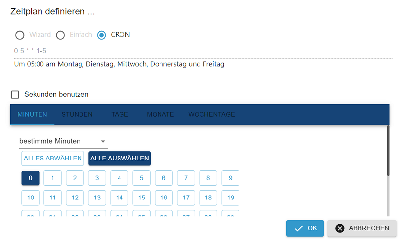

        ioBrokerMike
        Ein Frage habe ich noch.
        Denn ich bekomme den Zeitplan so nicht hin.
        Entweder bekomme ich zur Auswahl : Wizard , Einfach . CRON
        Wenn ich CRON Auswähle bekomme ich :
        Wie komme ich auf deine Einstellung?
        Mfg
        IOBrokerMike

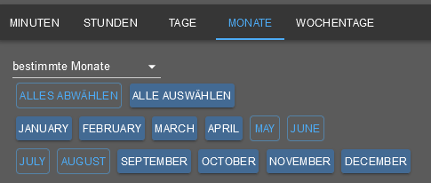

          @iobrokermike sagte: Wie komme ich auf deine Einstellung?
          Uhrzeit und Wochentage sind schon ausgewählt. Nun noch den Tab "Monate" (links neben "Wochentage") selektieren und die Monate September bis April auswählen.

              DJMarc75D Offline
              DJMarc75D Offline
              DJMarc75
              @iobrokermike sagte in Zeituhr Script | Korrektur lesen wenn möglich:
              Finde einfach links daneben nicht.

                I Offline
                I Offline
                ioBrokerMike
                @djmarc75
                Habe ich einen falschen Zeitplan?
                <block xmlns="https://developers.google.com/blockly/xml" type="schedule" id="/|{#(jKv5vZ.Zn/f-:vU" x="-31" y="-858">
                  <field name="SCHEDULE">0 5 * * 1-5</field>

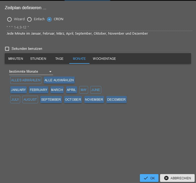

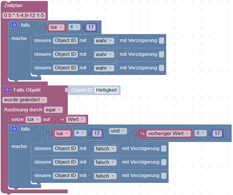

                  @iobrokermike
                  CRON
                   <variables>
                     <variable id="X:Ka{9hE@kokx5Iuy;gA">lux</variable>
                   </variables>
                   <block type="schedule" id="/|{#(jKv5vZ.Zn/f-:vU" x="-31" y="-858">
                     <field name="SCHEDULE">0 5 * 1-4,9-12 1-5</field>
                     <statement name="STATEMENT">
                       <block type="controls_if" id="/OUv.o??P/3DmBk3Y?2g">
                         <value name="IF0">
                           <block type="logic_compare" id="s!/$+N[thVQ@,_*S-r,@">
                             <field name="OP">LTE</field>
                             <value name="A">
                               <block type="variables_get" id="yc6hm|ilmN(C(]8-){iw">
                                 <field name="VAR" id="X:Ka{9hE@kokx5Iuy;gA">lux</field>
                               </block>
                             </value>
                             <value name="B">
                               <block type="math_number" id="WRq*Gp:lAtVtddS5J})i">
                                 <field name="NUM">17</field>
                               </block>
                             </value>
                           </block>
                         </value>
                         <statement name="DO0">
                           <block type="control" id="K;#6[`!r2bkj9@`rZ)DS">
                             <field name="OID">hm-rpc.0.0001D3C99C2D31.2.STATE</field>
                             <value name="VALUE">
                               <block type="logic_boolean" id="6GV~WA1U~{kkbK%8P9C0">
                               </block>
                             </value>
                             <next>
                               <block type="control" id="V^2K?,u^-fdJlBV,K?:!">
                                 <field name="OID">hm-rpc.0.0001D3C99C2CF1.3.STATE</field>
                                   <block type="logic_boolean" id="i^iAlt}JsDg@/fjnuY6a">
                                   </block>
                                 </value>
                                 <next>
                                   <block type="control" id="FitaMn/+U?-T(+:T3ZEs">
                                     <field name="OID">hm-rpc.0.0001D3C99CBF6E.2.STATE</field>
                                       <block type="logic_boolean" id="iIEpim!8/yr8ow8@3DOQ">
                                       </block>
                                     </value>
                                   </block>
                                 </next>
                               </block>
                             </next>
                           </block>
                         </statement>
                       </block>
                     </statement>
                   </block>
                  </xml>

                    @djmarc75
                          <value name="IF0">
                              <value name="A">
                                </block>
                              </value>
                              <value name="B">
                                </block>
                              </value>
                            </block>
                          </value>
                                </block>
                              </value>
                              <next>
                                    </block>
                                  </value>
                                  <next>
                                        </block>
                                      </value>
                                    </block>
                                  </next>
                                </block>
                              </next>
                            </block>
                          </statement>
                        </block>
                      </statement>
                    </block>
                    Dein Bild habe ich nicht, Sondern wie oben
                    In Deinem Skript schon.
                    Natürlich hast Du das wenn Du "wie oben" auch auf CRON umstellst:
