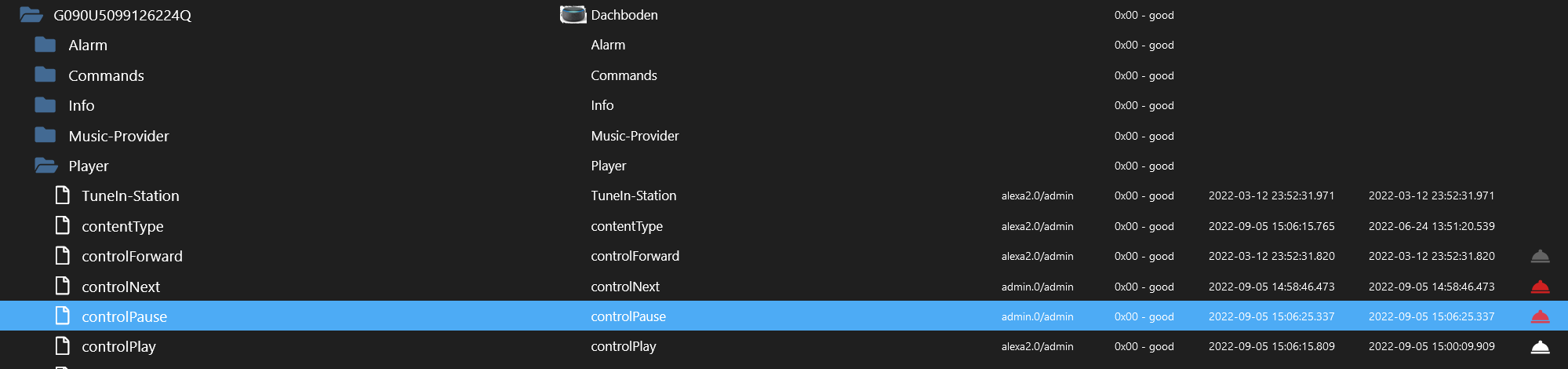

                              • Wannseesprinter
                                Wannseesprinter @apollon77 last edited by Wannseesprinter
                                @apollon77
                                Mein Auszug vom Log, nachdem ich "ControlPause" getriggert habe - Sorry, bin nicht so der "Debugging-Crack"!:
                                alexa2.0
                                	2022-09-06 16:02:26.758	debug	Alexa-Remote: Sending Request with {"host":"alexa.amazon.de","path":"/api/np/command?deviceSerialNumber=G090U509912XXXX&deviceType=A32DOYMUN6DTXA","method":"POST","timeout":10000,"headers":{}} and data={"contentFocusClientId":null,"type":"PauseCommand"}
                                alexa2.0
                                	2022-09-06 16:02:26.757	debug	Alexa-Remote: No authentication check needed (time elapsed 119395)
                                alexa2.0
                                	2022-09-06 16:02:26.755	debug	State changed alexa2.0.Echo-Devices.G090U509912XXXX.Player.controlPause: {"val":true,"ack":false,"ts":1662472946750,"q":0,"from":"system.adapter.admin.0","user":"system.user.admin","lc":1662472788674}
                                alexa2.0
                                	2022-09-06 16:02:23.561	info	Subscribing to states...
                                Wenn es ausnahmsweise funktioniert, schaut es so aus:
                                alexa2.0
                                	2022-09-06 16:05:53.049	debug	Alexa-Remote: Response: Status: 500
                                alexa2.0
                                	2022-09-06 16:05:52.984	debug	Alexa-Remote: Sending Request with {"host":"alexa.amazon.de","path":"/api/np/player?deviceSerialNumber=G090U509912XXXX&deviceType=A32DOYMUN6DTXA&screenWidth=1392&_=1662473152984","method":"GET","timeout":10000,"headers":{}}
                                alexa2.0
                                	2022-09-06 16:05:52.982	debug	Alexa-Remote: No authentication check needed (time elapsed 325620)
                                alexa2.0
                                	2022-09-06 16:05:51.979	debug	Schedule new Player Update in 1000ms
                                alexa2.0
                                	2022-09-06 16:05:51.979	debug	Alexa-Push-Connection Audio Player State change for G090U509912XXXX -> INTERRUPTED
                                alexa2.0
                                	2022-09-06 16:05:51.978	debug	Alexa-Remote WS-MQTT: Command PUSH_AUDIO_PLAYER_STATE: { "destinationUserId": "A9GTLF7X7ITG5", "dopplerId": { "deviceType": "A32DOYMUN6DTXA", "deviceSerialNumber": "G090U509912XXXX" }, "audioPlayerState": "INTERRUPTED", "quality": { "name": "High Definition", "badge": { "altText": null, "url": "https://music-provider-logos.s3.amazonaws.com/badges/AmazonMusic/HD.png", "contentType": "image/*" }, "stats": { "codec": "flac", "dataRateInBitsPerSecond": 1085608, "samplingRateInHertz": 44100 } }, "error": false, "errorMessage": null, "mediaReferenceId": "25c7a84e-1ca4-4629-a0c0-5aa6f599cf88:2" }
                                alexa2.0
                                	2022-09-06 16:05:51.978	debug	Alexa-Remote WS-MQTT: Incoming message: {"service":"FABE","messageType":"MSG","channel":866,"messageId":292078356,"moreFlag":1711276032,"seq":1,"checksum":1500281222,"content":{"messageType":"GWM","subMessageType":"MSG","channel":46201,"destinationIdentityUrn":"urn:tcomm-endpoint:service:serviceName:DeeWebsiteMessagingService:domain:prod:realm:USAmazon","deviceIdentityUrn":"urn:tcomm-endpoint:device:customerId:A9GTLF7X7ITG5:deviceType:A2IVLV5VM2W81:deviceSerialNumber:458929cb044a140a961ea65b3d70XXXX","payload":{"command":"PUSH_AUDIO_PLAYER_STATE","payload":{"destinationUserId":"A9GTLF7X7ITG5","dopplerId":{"deviceType":"A32DOYMUN6DTXA","deviceSerialNumber":"G090U509912XXXX"},"audioPlayerState":"INTERRUPTED","quality":{"name":"High Definition","badge":{"altText":null,"url":"https://music-provider-logos.s3.amazonaws.com/badges/AmazonMusic/HD.png","contentType":"image/*"},"stats":{"codec":"flac","dataRateInBitsPerSecond":1085608,"samplingRateInHertz":44100}},"error":false,"errorMessage":null,"mediaReferenceId":"25c7a84e-1ca4-4629-a0c0-5aa6f599cf88:2"},"timeStamp":1662473151910}}}
                                alexa2.0
                                	2022-09-06 16:05:51.977	debug	Alexa-Remote WS-MQTT: Incoming RAW message: 4d5347000003621168c3146600000001596c79860000039947574d204d5347203078303030306234373920307830303030303035632075726e3a74636f6d6d2d656e64706f696e743a736572766963653a736572766963654e616d653a446565576562736974654d6573736167696e67536572766963653a646f6d61696e3a70726f643a7265616c6d3a5553416d617a6f6e20307830303030303037662075726e3a74636f6d6d2d656e64706f696e743a6465766963653a637573746f6d657249643a413947544c46375837495447353a646576696365547970653a413249564c5635564d325738313a64657669636553657269616c4e756d6265723a3435383932396362303434613134306139363165613635623364373036663031207b22636f6d6d616e64223a22505553485f415544494f5f504c415945525f5354415445222c227061796c6f6164223a227b5c2264657374696e6174696f6e5573657249645c223a5c22413947544c46375837495447355c222c5c22646f70706c657249645c223a7b5c22646576696365547970655c223a5c22413332444f594d554e36445458415c222c5c2264657669636553657269616c4e756d6265725c223a5c22473039305535303939313236323234515c227d2c5c22617564696f506c6179657253746174655c223a5c22494e5445525255505445445c222c5c227175616c6974795c223a7b5c226e616d655c223a5c224869676820446566696e6974696f6e5c222c5c2262616467655c223a7b5c22616c74546578745c223a6e756c6c2c5c2275726c5c223a5c2268747470733a2f2f6d757369632d70726f76696465722d6c6f676f732e73332e616d617a6f6e6177732e636f6d2f6261646765732f416d617a6f6e4d757369632f48442e706e675c222c5c22636f6e74656e74547970655c223a5c22696d6167652f2a5c227d2c5c2273746174735c223a7b5c22636f6465635c223a5c22666c61635c222c5c226461746152617465496e426974735065725365636f6e645c223a313038353630382c5c2273616d706c696e6752617465496e486572747a5c223a34343130307d7d2c5c226572726f725c223a66616c73652c5c226572726f724d6573736167655c223a6e756c6c2c5c226d656469615265666572656e636549645c223a5c2232356337613834652d316361342d343632392d613063302d3561613666353939636638383a325c227d222c2274696d655374616d70223a313636323437333135313931307d46414245
                                alexa2.0
                                	2022-09-06 16:05:51.183	debug	Alexa-Remote: Sending Request with {"host":"alexa.amazon.de","path":"/api/np/command?deviceSerialNumber=G090U509912XXXX&deviceType=A32DOYMUN6DTXA","method":"POST","timeout":10000,"headers":{}} and data={"contentFocusClientId":null,"type":"PauseCommand"}
                                alexa2.0
                                	2022-09-06 16:05:51.182	debug	State changed alexa2.0.Echo-Devices.G090U509912XXXX.Player.controlPause: {"val":true,"ack":false,"ts":1662473151178,"q":0,"from":"system.adapter.admin.0","user":"system.user.admin","lc":1662472788674}

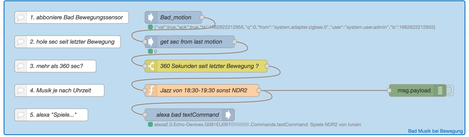

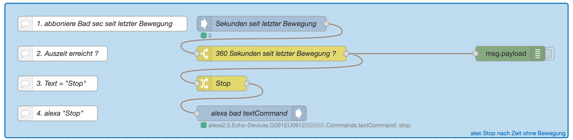

                                          • R
                                            rewenode @Guest last edited by
                                            @noah3112 sagte in alexa2 echo currentState:
                                            Bei mir das gleiche Problem. Current State bleibt auf true und damit klappt meine Musiksteuerung auf dem GästeWC nicht mehr. Gerät schon spannungslos gemacht Objektbaum vom betreffenden Gerät gelöscht hat alles keinen Erfolg gebracht.
                                            Ich weiß jetzt nicht, wie du die Musik_im_WC Steuerung gemacht hast..
                                            Bei mir geht's ja im das gleiche Problem, wenn auch im Bad.
                                            Falls es ein Amazon-Problem ist, geh ich mal nicht davon aus, dass das zeitnah gefixt wird.
                                            Deshalb habe ich mal bei mir nach einem Workaround gesucht.
                                            Bei mir läuft die Steuerung über 2 Node-Red Skripte.Das Prinzip sollte sich aber auch mit JS/Blockly umsetzten lassen:
                                            1. Musik einschalten bei Bewegung.
                                            2. Musik ausschalten
                                            Die Musik wird somit nur erneut eigeschaltet, wenn die letzte Bewegung
                                            größer als die Ausschaltzeit ist.
                                            Nicht ideal, tut's aber erst einmal.
                                            Reiner
