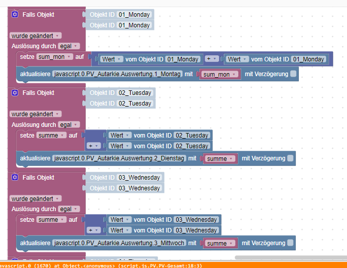

    Hallo, habe hier ein einfaches Blocky doch leider macht es nicht das was ich erwartet hätte. Zwei Werte zusammen rechnen und in ein Feld (Objekt) schreiben. Wo liegt meine Gedankenfehler ? Schaut mal bitte rüber.
    Hier das Log:
    javascript.0
    2022-07-06 13:40:01.926 info State value to set for "javascript.0.PV_Autarkie.Auswertung.3_Mittwoch" has to be type "Number" but received type "number"
    javascript.0
    2022-07-06 13:40:01.920 warn at processImmediate (internal/timers.js:464:21)
    javascript.0
    2022-07-06 13:40:01.920 warn at Immediate._onImmediate (/opt/iobroker/node_modules/@iobroker/js-controller-adapter/src/lib/adapter/adapter.js:5909:56)
    javascript.0
    2022-07-06 13:40:01.920 warn at Object.stateChange (/opt/iobroker/node_modules/iobroker.javascript/main.js:530:29)
    javascript.0
    2022-07-06 13:40:01.920 warn at Object.callback (/opt/iobroker/node_modules/iobroker.javascript/lib/sandbox.js:1082:38)
    javascript.0
    2022-07-06 13:40:01.920 warn at Object.<anonymous> (script.js.PV.PV-Gesamt:18:3)
    javascript.0
    2022-07-06 13:40:01.919 warn at setState (/opt/iobroker/node_modules/iobroker.javascript/lib/sandbox.js:1437:20)
    javascript.0
    2022-07-06 13:40:01.918 warn You are assigning a number to the state "javascript.0.PV_Autarkie.Auswertung.3_Mittwoch" which expects a Number. Please fix your code to use a Number or change the state type to number. This warning might become an error in future versions.

      @mymeyer sagte: has to be type "Number" but received type "number"
      "type": "number",
      in den Objekteigenschaften muss "number" klein geschrieben werden.
      Logs bitte in Code tags posten!
