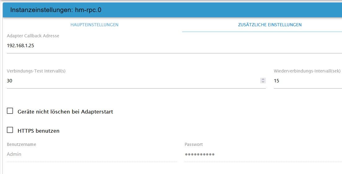

      ich habe das Problem, wenn ich meinen IO-Broker Server komplett neu starte, dass der HM-RPC Adapter keine Werte von der CCU bekommt.
      Erst wenn ich den Adapter dann noch einmal manuell neu starte (im LOG um 15:44:27), bekommt er wieder Daten.
      Adapterversion: 1.15.12
      hm-rpc.0
      	2022-06-29 15:44:32.345	info	Connected
      hm-rpc.0
      	2022-06-29 15:44:32.320	info	xmlrpc -> 93 devices
      hm-rpc.0
      	2022-06-29 15:44:32.301	info	xmlrpc <- listDevices ["IOBroker-Server:hm-rpc.0:025be6186ff90b9a5f1be3027ff93e0e"]
      hm-rpc.0
      	2022-06-29 15:44:32.287	info	xmlrpc <- system.listMethods ["IOBroker-Server:hm-rpc.0:025be6186ff90b9a5f1be3027ff93e0e"]
      hm-rpc.0
      	2022-06-29 15:44:32.274	info	xmlrpc client is trying to connect to 192.168.1.100:2001/ with ["http://192.168.1.25:2001","IOBroker-Server:hm-rpc.0:025be6186ff90b9a5f1be3027ff93e0e"]
      hm-rpc.0
      	2022-06-29 15:44:32.273	info	xmlrpc server is trying to listen on 0.0.0.0:2001
      hm-rpc.0
      	2022-06-29 15:44:32.183	info	starting. Version 1.15.12 in I:/ioBroker/node_modules/iobroker.hm-rpc, node: v16.15.1, js-controller: 4.0.23
      hm-rpc.0
      	2022-06-29 15:44:27.949	info	Terminated (ADAPTER_REQUESTED_TERMINATION): Without reason
      hm-rpc.0
      	2022-06-29 15:44:27.948	info	terminating
      hm-rpc.0
      	2022-06-29 15:44:27.948	info	Disconnected
      hm-rpc.0
      	2022-06-29 15:44:27.943	info	xmlrpc -> 192.168.1.100:2001/ init ["http://192.168.1.25:2001",""]
      hm-rpc.0
      	2022-06-29 15:44:27.942	info	Got terminate signal TERMINATE_YOURSELF
      hm-rpc.0
      	2022-06-29 15:35:35.578	info	Connected
      hm-rpc.0
      	2022-06-29 15:35:35.536	info	xmlrpc -> 93 devices
      hm-rpc.0
      	2022-06-29 15:35:35.515	info	xmlrpc <- listDevices ["IOBroker-Server:hm-rpc.0:a34cc66205223607b79ae1f8af6e7f85"]
      hm-rpc.0
      	2022-06-29 15:35:35.512	info	xmlrpc <- system.listMethods ["IOBroker-Server:hm-rpc.0:a34cc66205223607b79ae1f8af6e7f85"]
      hm-rpc.0
      	2022-06-29 15:35:35.500	info	xmlrpc client is trying to connect to 192.168.1.100:2001/ with ["http://192.168.1.25:2001","IOBroker-Server:hm-rpc.0:a34cc66205223607b79ae1f8af6e7f85"]
      hm-rpc.0
      	2022-06-29 15:35:35.500	info	xmlrpc server is trying to listen on 0.0.0.0:2001
      hm-rpc.0
      	2022-06-29 15:35:35.183	info	starting. Version 1.15.12 in I:/ioBroker/node_modules/iobroker.hm-rpc, node: v16.15.1, js-controller: 4.0.23
      hm-rpc.0
      	2022-06-29 15:35:32.505	warn	Terminated (ADAPTER_ALREADY_RUNNING): Without reason
      hm-rpc.0
      	2022-06-29 15:35:32.504	error	hm-rpc.0 already running

      @surfer09 sagte in HM-RPC Adapter keine Werte nach Serverneustart:
      eine virtuelle Maschine auf einem ESXi.
      Und warum startest du den kompletten Server neu , oder meinst du die VM wird neu gestartet !?
      surfer09S 1 Reply Last reply

        @glasfaser Wenn ich vom IO Broker Server spreche, meine ich die VM, nicht den ESXi.
            OK ... und dann mit :
            Windows 10 64bit
            warum kein Linux !?
            Ich vermute es liegt dann an Windows , wie schon @Homoran schreibt
            @homoran sagte in HM-RPC Adapter keine Werte nach Serverneustart:
            @glasfaser Netzwerk noch nicht bereit??
            surfer09S 2 Replies Last reply

                @glasfaser Ich bin kein Linux-Kenner, Windows habe ich da besser unter Kontrolle.
                Der Adapter funktionierte ja aber mal ohne Probleme unter Windows 10 64Bit.
                Scheinbar ist das Problem ja auch kein Einzelfall.
                Ich könnte den iobroker-Dienst ja mal verzögert starten lassen, um das Problem mit der noch nicht bestehenden Netzwerkverbindung auszuschließen.

                  @glasfaser Also Netzwerk ist es auch nicht. Ich habe gerade den IO-Broker Dienst mal später starten lassen nach hochfahren. Es besteht das gleiche Problem.

                    Bei mir ist ioBroker in einem Docker Container der auf einem Unraid Server läuft. CCU ist Raspberrymatic auf nem Raspi (soll auch auf Unraid umziehen, bekomm aber das Problem mit der ETH Platine nicht gelöst)
                    Wenn die Raspberrymatic neu gestartet wird, passt alles. Wird der ioBroker Container neugestartet hab ich danach keine Verbindung. Leuchtet aber alles grün. Ist mir erst aufgefallen, als irgendwelche Lampen nicht mehr gingen. Seitdem starte ich wie gesagt immer nochmal durch.

                      Wenn der Shutdown nicht ordentlich war, kann es sein, dass die CCU den Client noch unter der alten IP kennt, siehe https://github.com/ioBroker/ioBroker.hm-rpc/issues/595
                      Für das offizielle Docker Image wird aktuell der Shutdown optimiert, so dass das nicht mehr vorkommen sollte https://github.com/buanet/ioBroker.docker/commit/b8c67b7149afb55ca0b57d29f62d46626d962263

                        @foxriver76 Vielleicht ist das ja auch das gleiche Problem, warum es bei mir nicht funktioniert. Die Meldung im LOG scheint ja die gleiche zu sein wie beim Docker. „no matching device“
