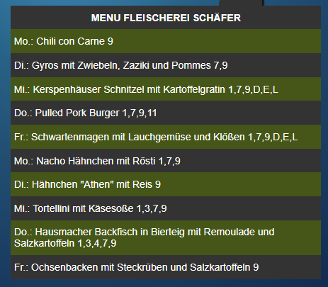

      als widget nimmst das inventwo json widget - dazu die inventwo widgets als adapter installieren
      [{"tpl":"i-vis-jsontable","data":{"g_fixed":false,"g_visibility":false,"g_css_font_text":false,"g_css_background":false,"g_css_shadow_padding":false,"g_css_border":false,"g_gestures":false,"g_signals":false,"g_last_change":false,"visibility-cond":"==","visibility-val":1,"visibility-groups-action":"hide","iTblRowLimit":"10","iTableRefreshRate":"0","iColCount":"1","iColShow1":"true","iTblTextAlign1":"left","iTblCellFormat1":"normal","iTblCellImageSize1":"200","iTblCellBooleanCheckbox1":"false","iTblCellBooleanColorFalse1":"#ff0000","iTblCellBooleanColorTrue1":"#00ff00","iTblCellNumberDecimals1":"2","iTblCellNumberDecimalSeperator1":".","iTblCellNumberThousandSeperator1":",","iTblCellThresholdsDp1":"","iTblCellThresholdsText1":"","iOpacityAll":"1","iTblRowEvenColor":"#333333","iTblRowUnevenColor":"#455618","iTblHeaderColor":"#333333","iRowSpacing":"10","iTblRowEvenTextColor":"#ffffff","iTblRowUnevenTextColor":"#ffffff","iTblHeaderTextColor":"#ffffff","iBorderSize":"0","iBorderStyleLeft":"none","iBorderStyleRight":"none","iBorderStyleUp":"none","iBorderStyleDown":"none","iBorderColor":"#ffffff","signals-cond-0":"==","signals-val-0":true,"signals-icon-0":"/vis/signals/lowbattery.png","signals-icon-size-0":0,"signals-blink-0":false,"signals-horz-0":0,"signals-vert-0":0,"signals-hide-edit-0":false,"signals-cond-1":"==","signals-val-1":true,"signals-icon-1":"/vis/signals/lowbattery.png","signals-icon-size-1":0,"signals-blink-1":false,"signals-horz-1":0,"signals-vert-1":0,"signals-hide-edit-1":false,"signals-cond-2":"==","signals-val-2":true,"signals-icon-2":"/vis/signals/lowbattery.png","signals-icon-size-2":0,"signals-blink-2":false,"signals-horz-2":0,"signals-vert-2":0,"signals-hide-edit-2":false,"lc-type":"last-change","lc-is-interval":true,"lc-is-moment":false,"lc-format":"","lc-position-vert":"top","lc-position-horz":"right","lc-offset-vert":0,"lc-offset-horz":0,"lc-font-size":"12px","lc-font-family":"","lc-font-style":"","lc-bkg-color":"","lc-color":"","lc-border-width":"0","lc-border-style":"","lc-border-color":"","lc-border-radius":10,"lc-zindex":0,"iColName1":"MENU","oid":"0_userdata.0.CONTROL-OWN.TABELLEN.GezeitenInSpanien"},"style":{"left":"1001px","top":"523px","width":"496px","height":"362px"},"widgetSet":"vis-inventwo"}]
      der andere metzger hat einfach ein bild eingefügt - ich denke, das bild wird immer einen aneren namen haben - da brauchen wir ein script, welches den namen des bildes findet und anschliesend kann man das bild als rl-adresse ein der vis anzeigen

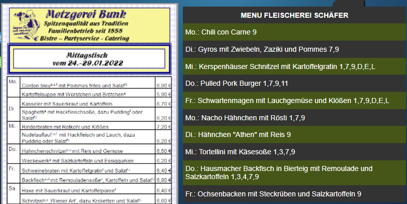

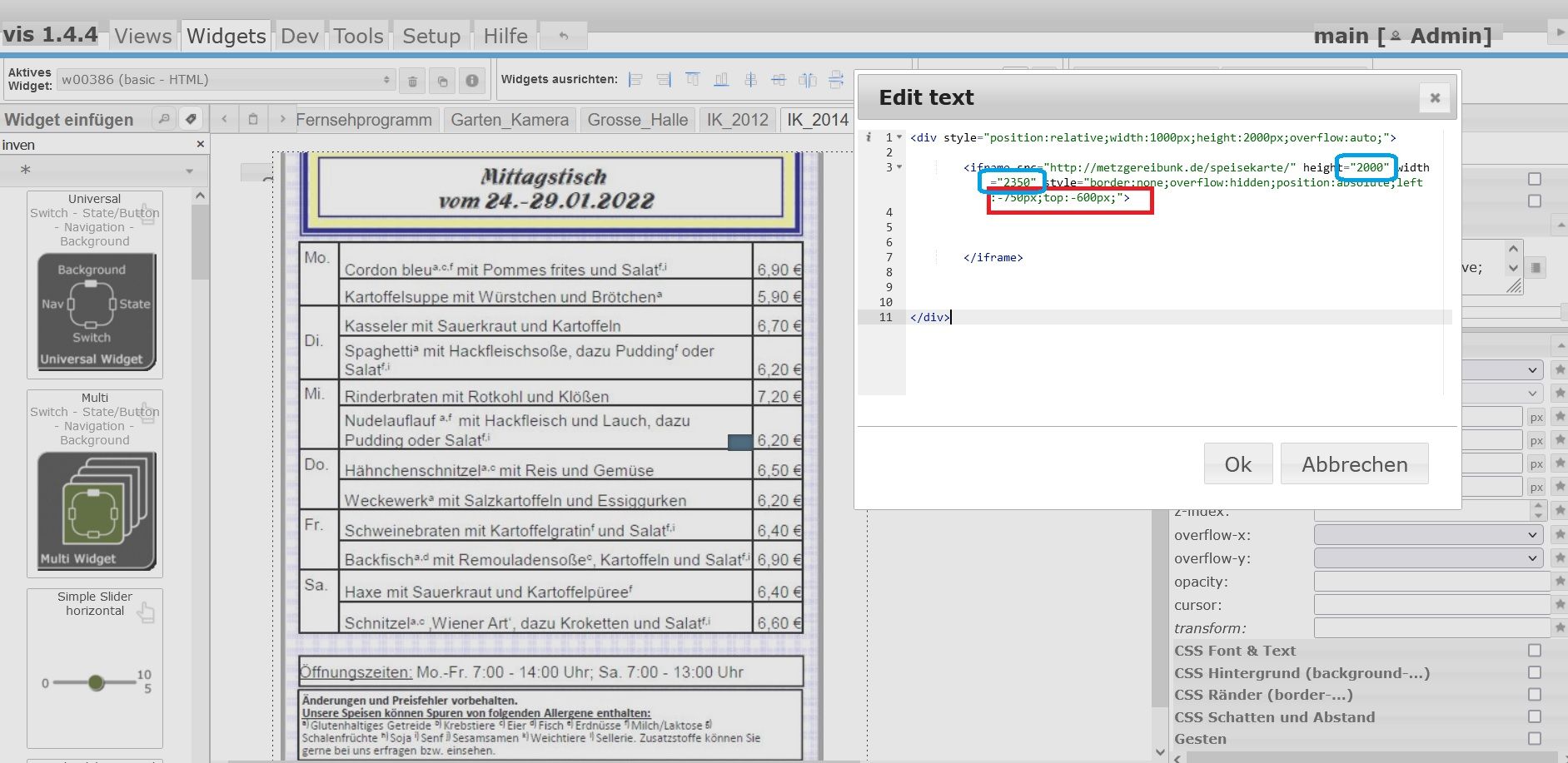

        Ich habe das auch gemacht ich zeige mit der vis auf einen Bereich in einer webseite.
        Hier als Beispiel Mal mit einer Seite wo auf in eine aktien Tabelle geschaut wird.
        Du musst dir den link ändern und teilweise die PX werte ```
        <div style="position:relative;width:500px;height:2000px;overflow:auto;">
        <iframe src="https://kursprognose.com/ethereum-kurs-prognose-eth-in-euro" height="1100" width="1000" style="border:none;overflow:hidden;position:absolute;left:-30px;top:-550px;">
        </iframe>
        </div>

            @liv-in-sky Der Bildname ist bei dem Widget egal das zeigt einfach einen Bereich aus einer internetseite. Quasie ähnlich die dieses Berümte anzeigen der Tagesschau in 100 sekunden.
            Das führt allerdings dazu das man mit den Pixel etwas Spielen muss und solang das Bild immer auf der selben Position ist dann ist der Name egal.
            Hier noch mal als Widget import wie ich das mit meinem Metzger mache:
            [{"tpl":"tplHtml","data":{"g_fixed":false,"g_visibility":false,"g_css_font_text":false,"g_css_background":false,"g_css_shadow_padding":false,"g_css_border":false,"g_gestures":false,"g_signals":false,"g_last_change":false,"visibility-cond":"==","visibility-val":1,"visibility-groups-action":"hide","refreshInterval":"86400000","signals-cond-0":"==","signals-val-0":true,"signals-icon-0":"/vis/signals/lowbattery.png","signals-icon-size-0":0,"signals-blink-0":false,"signals-horz-0":0,"signals-vert-0":0,"signals-hide-edit-0":false,"signals-cond-1":"==","signals-val-1":true,"signals-icon-1":"/vis/signals/lowbattery.png","signals-icon-size-1":0,"signals-blink-1":false,"signals-horz-1":0,"signals-vert-1":0,"signals-hide-edit-1":false,"signals-cond-2":"==","signals-val-2":true,"signals-icon-2":"/vis/signals/lowbattery.png","signals-icon-size-2":0,"signals-blink-2":false,"signals-horz-2":0,"signals-vert-2":0,"signals-hide-edit-2":false,"lc-type":"last-change","lc-is-interval":true,"lc-is-moment":false,"lc-format":"","lc-position-vert":"top","lc-position-horz":"right","lc-offset-vert":0,"lc-offset-horz":0,"lc-font-size":"12px","lc-font-family":"","lc-font-style":"","lc-bkg-color":"","lc-color":"","lc-border-width":"0","lc-border-style":"","lc-border-color":"","lc-border-radius":10,"lc-zindex":0,"html":"<div style=\"position:relative;width:1000px;height:2000px;overflow:auto;\">\n\n        <iframe src=\"http://metzgereibunk.de/speisekarte/\" height=\"2000\" width=\"2350\" style=\"border:none;overflow:hidden;position:absolute;left:-750px;top:-600px;\">\n\n \n\n        </iframe>\n\n \n\n</div>"},"style":{"left":"61px","top":"18px","width":"569px","height":"617px"},"widgetSet":"basic"}]
            Einfach auf Widget import gehen und den code oben einfügen danach im html Teil evtl. die Pixel anpassen dann sollte das Schon drin sein

                @liv-in-sky
                Klar wieso soll das denn nicht gehen ;-)
                Ist halt leider bei Bilder usw. nicht wirklich einfach an die werte zu kommen dann geht das damit am besten.
                Ich habe hier den erneuerungstimer allerdings so hoch wie möglich gestellt nicht das der server mich irgendwann ablehnt wegen zu vielen anfragen. Aber bei so etwas reicht die updatezeit von 180000 auf jedenfall.

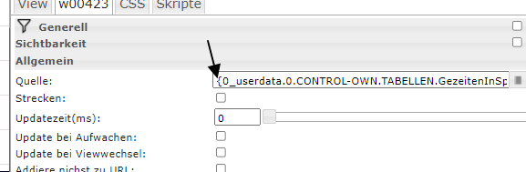

                  so - das ganze für das bild mit scriipt
                  es wird immer der aktuelle bildernamen gefunden und in einen datenpunkt geschrieben
                  damit kann sich auch die webseite verschieben ud du bekommst das bild
                  • den datenpunkt ganz oben anpassen
                  • ein image widget mit binding nutzen - den dp mit {0_userdata.0.CONTROL-OWN.TABELLEN........} angeben

                            für die erste metzgerei ging es auch mit dem parser-adapter den bildnamen aus der seite zu zeihen
                            im parseradapter als typ string und als regex
                            <img loading="lazy".*src="(.*)" alt
                            eintragen.
                            den datenpunkt dann in einem image widget mit binding auf den datenpunkt in quelle eintragen
                            beim 2. metzger wäre die Lösung oben mit dem iframe am besten.

                                  • TheBamT TheBam
                                    @liv-in-sky
