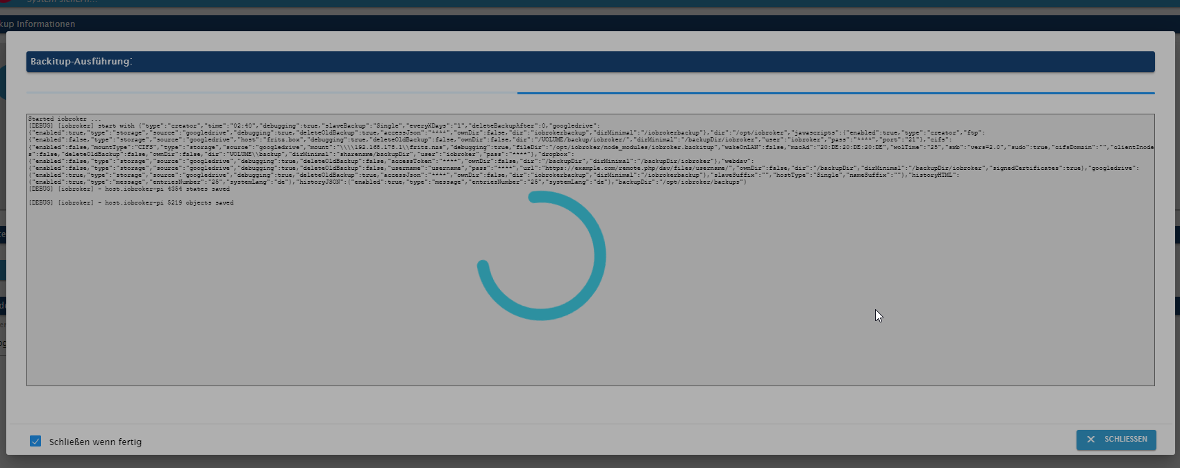

    so langsam geht mir wirklich die Muffe. Mittlerweile habe ich schon zahlreiche Features in iobroker realisiert und könnte mir kaum vorstellen wieder ohne iobroker auszukommen. Umso mehr ärgert mich, dass ich keine Backup Strategie zum laufen bekomme.
    Ich würde gerne meine Files in Google Drive (aktueller token ist vorhanden) oder zumindest lokal auf dem raspberry pi sichern. Als Basis läuft auf dem pi die offizielle iobroker linux distro.

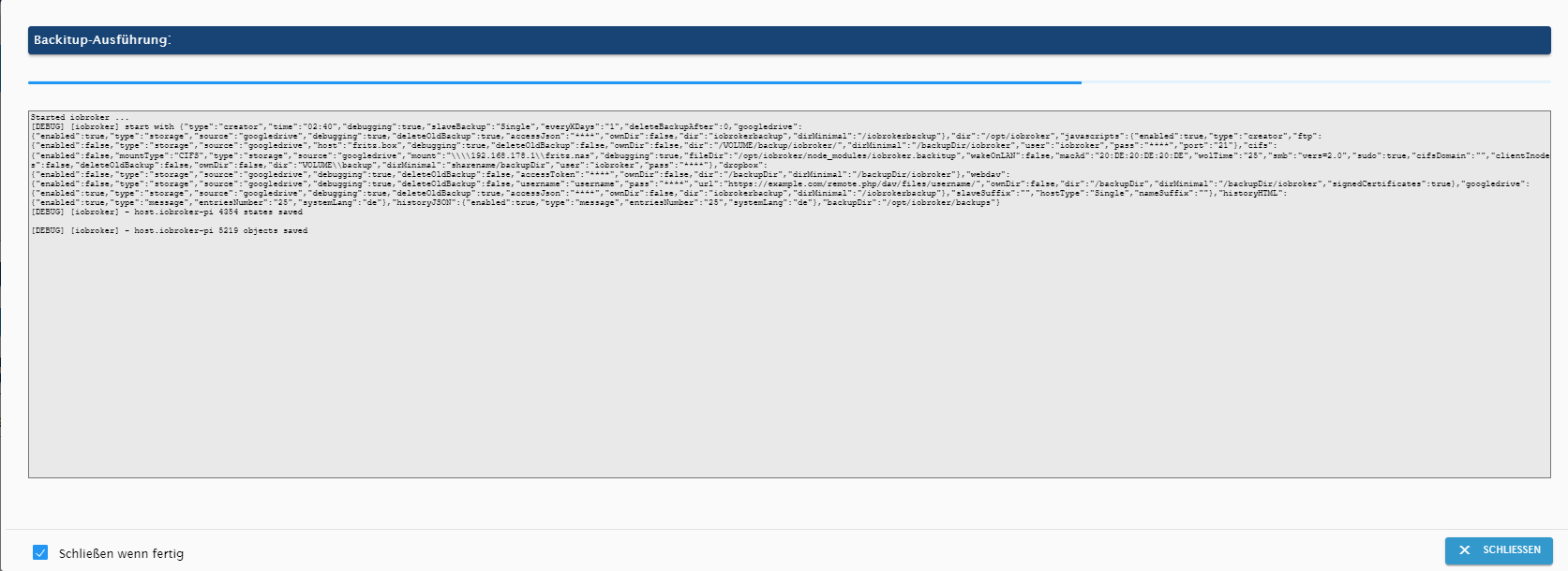

    Wenn ich mit BackitUp eine manuelle iobroker Sicherung durchführe bekomme erscheint der Backitup Protokol Dialog mit folgendem Inhalt:
    *Started iobroker ...
    [DEBUG] [iobroker] start with {"type":"creator","time":"02:40","debugging":true,"slaveBackup":"Single","everyXDays":"1","nameSuffix":"babic","deleteBackupAfter":0,"googledrive":{"enabled":true,"type":"storage","source":"googledrive","debugging":true,"deleteOldBackup":true,"accessJson":"****","ownDir":false,"dir":"iobrokerbackup","dirMinimal":"/iobrokerbackup"},"dir":"/opt/iobroker","javascripts":{"enabled":true,"type":"creator","ftp":{"enabled":false,"type":"storage","source":"googledrive","host":"fritz.box","debugging":true,"deleteOldBackup":false,"ownDir":false,"dir":"/VOLUME/backup/iobroker/","dirMinimal":"/backupDir/iobroker","user":"iobroker","pass":"****","port":"21"},"cifs":{"enabled":false,"mountType":"CIFS","type":"storage","source":"googledrive","mount":"\\\\192.168.178.1\\fritz.nas","debugging":true,"fileDir":"/opt/iobroker/node_modules/iobroker.backitup","wakeOnLAN":false,"macAd":"20:DE:20:DE:20:DE","wolTime":"25","smb":"vers=2.0","sudo":true,"cifsDomain":"","clientInodes":false,"deleteOldBackup":false,"ownDir":false,"dir":"VOLUME\\backup","dirMinimal":"sharename/backupDir","user":"iobroker","pass":"****"},"dropbox":{"enabled":false,"type":"storage","source":"googledrive","debugging":true,"deleteOldBackup":false,"accessToken":"****","ownDir":false,"dir":"/backupDir","dirMinimal":"/backupDir/iobroker"},"webdav":{"enabled":false,"type":"storage","source":"googledrive","debugging":true,"deleteOldBackup":false,"username":"username","pass":"****","url":"https://example.com/remote.php/dav/files/username/","ownDir":false,"dir":"/backupDir","dirMinimal":"/backupDir/iobroker","signedCertificates":true},"googledrive":{"enabled":true,"type":"storage","source":"googledrive","debugging":true,"deleteOldBackup":true,"accessJson":"****","ownDir":false,"dir":"iobrokerbackup","dirMinimal":"/iobrokerbackup"},"slaveSuffix":"","hostType":"Single","nameSuffix":"babic"},"historyHTML":{"enabled":true,"type":"message","entriesNumber":"25","systemLang":"de"},"historyJSON":{"enabled":true,"type":"message","entriesNumber":"25","systemLang":"de"},"backupDir":"/opt/iobroker/backups"}
    [DEBUG] [iobroker] - host.iobroker-pi 4345 states saved
    [DEBUG] [iobroker] - host.iobroker-pi 5203 objects saved*
    danach lädt nach ca. 1-2- min im Hintergrund die Web UI neu und dann passiert einfach nichts. Den Dialog kann man durch klick auf "schliessen" beenden.
    Wenn ich die Backitup Page wieder öffne steht unter "Letzte iobroker Sicherung:" "no backups yet". Genauso zeigt mir der Backup Verlauf keinerlei Sicherungen an.
    Ich finde weder in "/opt/iobroker/backups" noch auf googledrive ein backup der iobroker Konfiguration.
    Irgendetwas läuft hier gründlich schief.
    Mir ist jedoch aufgefallen, dass im Ordner "/opt/iobroker/iobroker-data/backup-objects" aktuelle states und objects backup json.gz Dateien vorhanden sind. Ob diese durch backitup angelegt werden ist mir schleiherhaft.
    Weiß jemand was heir vorgeht und kann mich in irgendeiner Weise unterstützen?

      @lunatikk
      ls -la /opt/iobroker/backups/
      Komplette EIN und AUSgaben in der Kommandozeile posten.
      Und dann die einzelnen Einstellungen aus dem Backitupadapter.

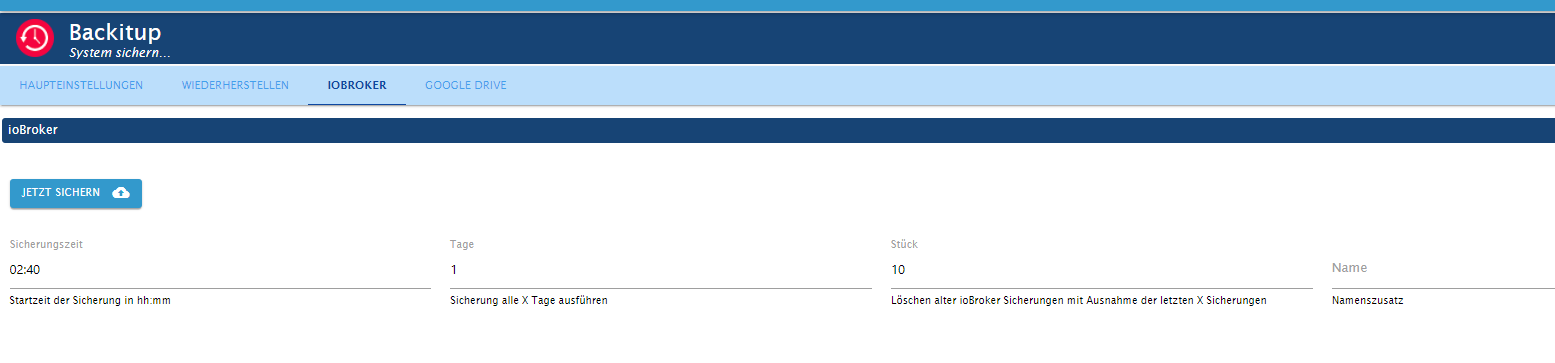

                  [edit:] außerdem die backitup settings:

                      @lunatikk Dann nehm doch mal dein google drive auch heraus und teste ob es local funktioniert

                          Das weiß ich nicht. Wie sieht denn jetzt das Protokoll aus?
                          Ein durchlaufendes Backup sollte ungefähr so aussehen:

                            lunatikk
                            @thomas-braun
                            also bei mir passiert nach der 3. Zeile nichts mehr
                            nach ner minute gibts wohl nen neustart:
                            danach sehe ich weiterhin das gleiche Bild (aus dem 1. screenshot).
                            Oder bin ich zu ungeduldig und das ganze dauert eigentlich Stunden... :/ ?!
                            Liebe Grüße
                            Lunatikk

                              @lunatikk
                              Bitte keine Screenshots posten. Mach den 'Schließen wenn fertig' Haken weg und poste den Text in CodeTags.

                                  lunatikk
                                  @thomas-braun
                                  Alles klar,
                                  Den "Schließen wenn fertig" Haken habe ich entfernt. Wie gesagt, immer noch der gleiche Stand:
                                  [DEBUG] [iobroker] start with {"type":"creator","time":"02:40","debugging":true,"slaveBackup":"Single","everyXDays":"1","deleteBackupAfter":0,"googledrive":{"enabled":true,"type":"storage","source":"googledrive","debugging":true,"deleteOldBackup":true,"accessJson":"****","ownDir":false,"dir":"iobrokerbackup","dirMinimal":"/iobrokerbackup"},"dir":"/opt/iobroker","javascripts":{"enabled":true,"type":"creator","ftp":{"enabled":false,"type":"storage","source":"googledrive","host":"fritz.box","debugging":true,"deleteOldBackup":false,"ownDir":false,"dir":"/VOLUME/backup/iobroker/","dirMinimal":"/backupDir/iobroker","user":"iobroker","pass":"****","port":"21"},"cifs":{"enabled":false,"mountType":"CIFS","type":"storage","source":"googledrive","mount":"\\\\192.168.178.1\\fritz.nas","debugging":true,"fileDir":"/opt/iobroker/node_modules/iobroker.backitup","wakeOnLAN":false,"macAd":"20:DE:20:DE:20:DE","wolTime":"25","smb":"vers=2.0","sudo":true,"cifsDomain":"","clientInodes":false,"deleteOldBackup":false,"ownDir":false,"dir":"VOLUME\\backup","dirMinimal":"sharename/backupDir","user":"iobroker","pass":"****"},"dropbox":{"enabled":false,"type":"storage","source":"googledrive","debugging":true,"deleteOldBackup":false,"accessToken":"****","ownDir":false,"dir":"/backupDir","dirMinimal":"/backupDir/iobroker"},"webdav":{"enabled":false,"type":"storage","source":"googledrive","debugging":true,"deleteOldBackup":false,"username":"username","pass":"****","url":"https://example.com/remote.php/dav/files/username/","ownDir":false,"dir":"/backupDir","dirMinimal":"/backupDir/iobroker","signedCertificates":true},"googledrive":{"enabled":true,"type":"storage","source":"googledrive","debugging":true,"deleteOldBackup":true,"accessJson":"****","ownDir":false,"dir":"iobrokerbackup","dirMinimal":"/iobrokerbackup"},"slaveSuffix":"","hostType":"Single","nameSuffix":""},"historyHTML":{"enabled":true,"type":"message","entriesNumber":"25","systemLang":"de"},"historyJSON":{"enabled":true,"type":"message","entriesNumber":"25","systemLang":"de"},"backupDir":"/opt/iobroker/backups"}
                                  [DEBUG] [iobroker] - host.iobroker-pi 4360 states saved
                                  [DEBUG] [iobroker] - host.iobroker-pi 5219 objects saved
