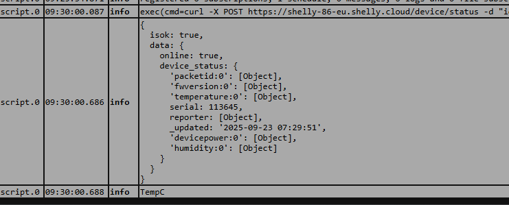

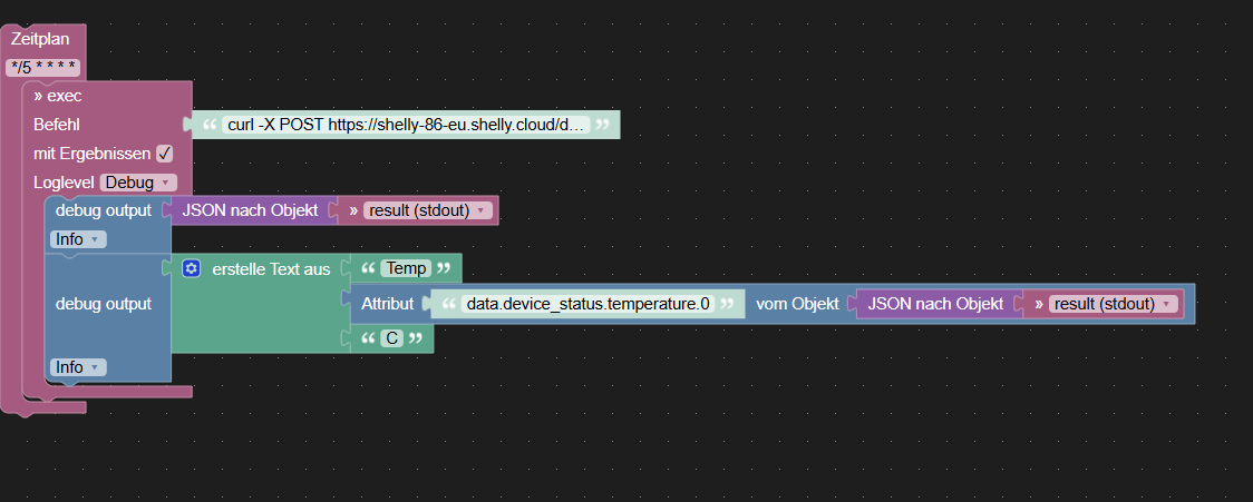

                      Nabend bräuchte mal eure Hilfe
                      würde gerne den Temperaturwert aus der Shellycloud auslesen und in einem Datenpunkt speichern. Hier mein Blockly
                      hier der output
                      javascript.0	23:06:18.523	info	script.js.common.test.shellycloud: {"isok":true,"data":{"online":true,"device_status":{"ts":1735941967.78,"_updated":"2025-01-03 22:06:08","input:1":{"id":1,"state":false},"serial":3550,"id":"XXXXXXXXXXXX","v_eve:1":{"ev":"","ttl":-1,"id":1},"input:0":{"id":0,"state":false},"wifi":{"sta_ip":"192.168.1.135","status":"got ip","ssid":"RUT241_77A7","rssi":-24},"addons":["temperature:100","voltmeter:100"],"temperature:100":{"id":100,"errors":[],"tC":6.81,"tF":44.26},"input:2":{"id":2,"counts":{"by_minute":[0,0,0],"minute_ts":1735941900,"total":0},"freq":0},"ws":{"connected":false},"sys":{"webhook_rev":109,"mac":"CC7B5C880810","restart_required":false,"time":"04:01","unixtime":1735873286,"uptime":330882,"ram_size":267904,"ram_free":109720,"fs_size":393216,"fs_free":102400,"cfg_rev":48,"kvs_rev":0,"schedule_rev":6,"available_updates":{},"reset_reason":1},"mqtt":{"connected":false},"v_eve:0":{"ev":"","ttl":-1,"id":0},"v_eve:2":{"ev":"","ttl":-1,"id":2},"voltmeter:100":{"id":100,"voltage":12.49,"errors":[]},"switch:0":{"id":0,"output":false,"source":"timer"},"code":"SNSN-0043X","cloud":{"connected":true},"switch:1":{"id":1,"output":false,"source":"timer"},"ble":{}}}}
                      javascript.0	23:06:18.523	info	script.js.common.test.shellycloud: TempC
                      leider bekomme ich kein wert raus, und weiß jetzt auch nicht mehr weiter
