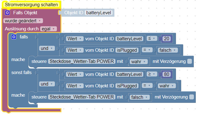

          @dr-pie Ich mache das so:
          <block xmlns="https://developers.google.com/blockly/xml" type="on_ext" id=")BCBw,)KxeP)WiIzN67[" x="112" y="89">
           <value name="OID0">
             <shadow type="field_oid" id="pwV@8NNT!OSL?76id,wm">
               <field name="oid">fullybrowser.0.192_168_3_20.Info.batteryLevel</field>
             </shadow>
           </value>
           <statement name="STATEMENT">
             <block type="controls_if" id="TXB!XbknBVuBz1A8V$GF">
               <value name="IF0">
                 <block type="logic_operation" id="!C88w+K9{hf{HuUC2!f-" inline="false">
                   <field name="OP">AND</field>
                   <value name="A">
                     <block type="logic_compare" id="Yds8tF6QakgatxTwoTZT">
                       <field name="OP">LTE</field>
                       <value name="A">
                         <block type="get_value" id="q^442Z*EjIK.yQE5+5k~">
                           <field name="OID">fullybrowser.0.192_168_3_20.Info.batteryLevel</field>
                         </block>
                       </value>
                       <value name="B">
                         <block type="math_number" id="#4JiC:Z(7R+u)X;4A+D.">
                           <field name="NUM">20</field>
                         </block>
                       </value>
                     </block>
                   </value>
                   <value name="B">
                     <block type="logic_compare" id="rh|Wv.tRP!Z{^R%m!aod">
                       <field name="OP">EQ</field>
                       <value name="A">
                         <block type="get_value" id="2Q?OwXzZ^[TayYlGbd66">
                           <field name="OID">fullybrowser.0.192_168_3_20.Info.isPlugged</field>
                         </block>
                       </value>
                       <value name="B">
                         <block type="logic_boolean" id="7Qp9#7~O:yB^j)3@ET;+">
                         </block>
                       </value>
                     </block>
                   </value>
                 </block>
               </value>
               <statement name="DO0">
                 <block type="control" id="h/o0uZS%l0,3Q,l)y)9R">
                   <field name="OID">sonoff.0.Steckdose_Wetter-Tab.POWER</field>
                   <value name="VALUE">
                     <block type="logic_boolean" id="v~OHjszwO?:4Jq9ESi]r">
                     </block>
                   </value>
                 </block>
               </statement>
               <value name="IF1">
                 <block type="logic_operation" id="z1v0]@YCoW#an5:h4#wc" inline="false">
                   <value name="A">
                     <block type="logic_compare" id="Nc%5;[#XwPLNd+f2)[uD">
                       <field name="OP">GTE</field>
                       <value name="A">
                         <block type="get_value" id="LrmpDZUJ9m@Mf9f]3`.,">
                         </block>
                       </value>
                       <value name="B">
                         <block type="math_number" id="ZSRDU[%S^wY$?VY^tS[0">
                           <field name="NUM">80</field>
                         </block>
                       </value>
                     </block>
                   </value>
                   <value name="B">
                     <block type="logic_compare" id="4Rgv`*51C2+q[z%{di/;">
                       <value name="A">
                         <block type="get_value" id="KJXV/u7QV%Tu*mpGAycJ">
                         </block>
                       </value>
                       <value name="B">
                         <block type="logic_boolean" id="5a/XBb50B*)cnd))S9=S">
                         </block>
                       </value>
                     </block>
                   </value>
                 </block>
               </value>
               <statement name="DO1">
                 <block type="control" id="_U@lv,8o]%8n]?V]QcAa">
                     <block type="logic_boolean" id="s3ND.Z8N~M6~v1})+r:*">
                     </block>
                   </value>
                 </block>
               </statement>
             </block>
           </statement>
          </block>
          Dr.PieD 1 Antwort Letzte Antwort

            @dr-bakterius
            Cool ... das Script funktioniert super.
            Ich hab das angepasst und es lief gleich beim ersten mal...
            1000 Dank dafür
