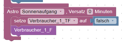

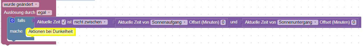

      • paul53
        paul53 @helpme last edited by paul53
        @helpme sagte: nach Sonnenuntergang ausgeführt werden und dann bis zum nächsten Tag Sonnenaufgang

                                         <block type="on_ext" id="W*oi[r42Fur~gO:zbm4g">
                                           <mutation xmlns="http://www.w3.org/1999/xhtml" items="2"></mutation>
                                           <value name="OID0">
                                             <shadow type="field_oid" id="85SpWm|JTqSGg:^e/*rU">
                                             </shadow>
                                             <block type="field_oid" id="#a`3[p,W%r/bDBKGnYO)">
                                               <field name="oid">sma-em.0.3004906910.psurplus</field>
                                             </block>
                                           </value>
                                           <value name="OID1">
                                             <shadow type="field_oid" id="p,ke`l}Dw-?*+.^!V%/G">
                                             </shadow>
                                             <block type="field_oid" id="QJ=%Ay8%ZQ4%B9.thx%A">
                                               <field name="oid">sma-em.0.3004906910.pregard</field>
                                             </block>
                                           </value>
                                           <statement name="STATEMENT">
                                             <block type="controls_if" id="^7l^4UD1B#B1Ze$~9,5R">
                                               <value name="IF0">
                                                 <block type="logic_operation" id="i#KXT;e3`L7~c|d3%|kI" inline="false">
                                                   <field name="OP">AND</field>
                                                   <value name="A">
                                                     <block type="logic_compare" id="R[55*32U9|fV73jr|d5w">
                                                       <field name="OP">EQ</field>
                                                       <value name="A">
                                                         <block type="variables_get" id="wD#_u4grFGiK*IuaQTh|">
                                                           <field name="VAR" id="u$n!XZBM)j[J?f~JT%z5">WolkenVerzoegerung</field>
                                                         </block>
                                                       </value>
                                                       <value name="B">
                                                         <block type="logic_boolean" id="Rmo~p[C`sY{T:v`@.hR_">
                                                         </block>
                                                       </value>
                                                     </block>
                                                   </value>
                                                   <value name="B">
                                                     <block type="time_compare_ex" id="M^x%;xn*Jx$4CRY;_Z:l">
                                                       <mutation xmlns="http://www.w3.org/1999/xhtml" end_time="true" actual_time="true"></mutation>
                                                       <field name="USE_ACTUAL_TIME">TRUE</field>
                                                       <field name="OPTION">not between</field>
                                                       <value name="START_TIME">
                                                         <shadow type="text" id="=Q{Q4m6f=Ys1]-Tun%9M">
                                                           <field name="TEXT">12:00</field>
                                                         </shadow>
                                                         <block type="time_astro" id="gXd#WnoM/RU2-~?QjN,q">
                                                           <field name="TYPE">sunrise</field>
                                                           <field name="OFFSET">0</field>
                                                         </block>
                                                       </value>
                                                       <value name="END_TIME">
                                                         <shadow type="text" id="oxf#zk~P5m~|+y.)Ui7n">
                                                           <field name="TEXT">18:00</field>
                                                         </shadow>
                                                         <block type="time_astro" id="W*SW@7u@5*=o]qE8[N02">
                                                           <field name="TYPE">sunset</field>
                                                         </block>
                                                       </value>
                                                     </block>

            • H
              helpme @paul53 last edited by helpme
              @paul53 said in Skript durch Astrofunktion erweitern:
              @helpme sagte: Verbraucher 1 u. 2 sollen dann allerdings nach Sonnenaufgang abgeschaltet sein
              Zusätzlich Astro-Trigger zu Sonnenaufgang und im Astro-Trigger abschalten.
              Hab das mit dem Astro-Trigger zu Sonnenaufgang versucht, mit dem abschalten aber irgendwas mach ich falsch, kannst du dass noch mal anschauen. Der Verbraucher wird ab Sonnenaufgang dann abgeschalten aber das Script läuft immer weiter?
              Danke dir für die Hilfe

              Thomas Braun paul53 2 Replies Last reply Reply Quote 0
              • Thomas Braun
                Thomas Braun Most Active @helpme last edited by
                @helpme sagte in Skript durch Astrofunktion erweitern:
                Skripte laufen immer weiter. Wie sonst sollen die auch auf Trigger reagieren?
                • paul53
                  Der Trigger zu Sonnenaufgang darf nicht im anderen Trigger plaziert werden, sondern muss nach außerhalb.
                  H 1 Reply Last reply Reply Quote 0
