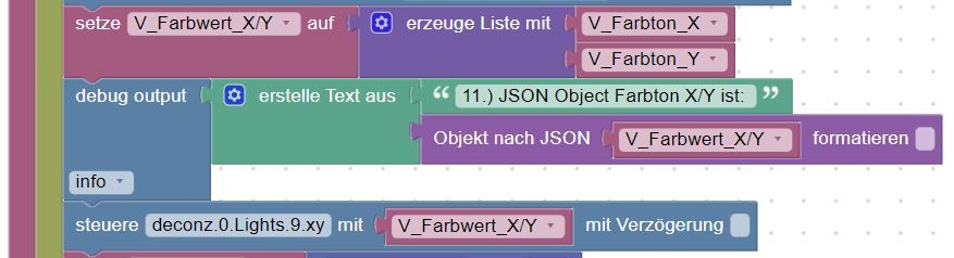

        Mercyful 0
        Vielen Dank für die Info!
        Ich habe mein Script geändert
          <variables>
            <variable id="8j[oYyFK?1|(#@hg@t3N">Timesteps</variable>
            <variable id="0*D.N}_t/EzdZ,YlnaN%">V_Helligkeit_in_%</variable>
            <variable id="Bpo?M3yT9_Q!Alkd~Z0L">V_Farbton_X</variable>
            <variable id="A1;vRg.y1WRpZG7`FU})">V_Farbton_Y</variable>
            <variable type="interval" id="Intervall">Intervall</variable>
            <variable id="cQXpIFX1XTNiV$VQut6W">V_Farbwert_X/Y</variable>
          </variables>

        dennoch wird das Objekt nicht als Array erkannt . Hier die Fehlermeldungen die beim Ausführen des Scriptes:
        deconz.0	2021-12-20 09:38:35.866	warn	(1897) {"address":"/lights/9/state","description":"parameter, xy, is not modifiable. Device is set to off.","type":201}
        deconz.0	2021-12-20 09:38:35.863	warn	(1897) {"address":"/lights/9/state","description":"parameter, bri, is not modifiable. Device is set to off.","type":201}
        javascript.0	2021-12-20 09:38:35.805	error	(959) at processTimers (internal/timers.js:497:7)
        javascript.0	2021-12-20 09:38:35.804	error	(959) at listOnTimeout (internal/timers.js:554:17)
        javascript.0	2021-12-20 09:38:35.804	error	(959) at Timeout._onTimeout (/opt/iobroker/node_modules/iobroker.javascript/lib/sandbox.js:2085:34)
        javascript.0	2021-12-20 09:38:35.804	error	(959) at Object.<anonymous> (script.js.Light-Control.Schlafzimmer.Sonnenaufgang_TEST:28:72)
        javascript.0	2021-12-20 09:38:35.803	error	(959) script.js.Light-Control.Schlafzimmer.Sonnenaufgang_TEST: TypeError: V_Farbwert_X_Y.split is not a function
        javascript.0	2021-12-20 09:38:35.801	info	(959) script.js.Light-Control.Schlafzimmer.Sonnenaufgang_TEST: 12.) Farbton X/Y: 0.7346,0.265
        javascript.0	2021-12-20 09:38:35.801	warn	(959) at processTimers (internal/timers.js:497:7)
        javascript.0	2021-12-20 09:38:35.800	warn	(959) at listOnTimeout (internal/timers.js:554:17)
        javascript.0	2021-12-20 09:38:35.800	warn	(959) at Timeout._onTimeout (/opt/iobroker/node_modules/iobroker.javascript/lib/sandbox.js:2085:34)
        javascript.0	2021-12-20 09:38:35.799	warn	(959) at Object.<anonymous> (script.js.Light-Control.Schlafzimmer.Sonnenaufgang_TEST:26:5)
        javascript.0	2021-12-20 09:38:35.799	warn	(959) at setState (/opt/iobroker/node_modules/iobroker.javascript/lib/sandbox.js:1439:20)
        javascript.0	2021-12-20 09:38:35.797	warn	(959) You are assigning a string to the state "deconz.0.Lights.9.xy" which expects a array. Please fix your code to use a array or change the state type to string. This warning might become an error i
        Ich bin und bleibe ratlos :-(
        Gruß Mercy
        • M Mercyful 0

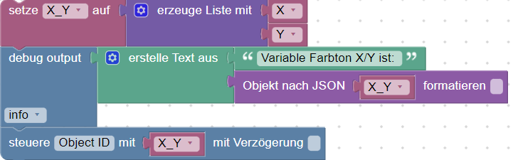

            <variables>
            </variables>
            <block type="on" id="wafVglRXOAVv!O@OpR#M" x="-502" y="-19">
              <field name="OID">javascript.0.variables.b_Sonnenaufgang</field>
              <statement name="STATEMENT">

                                                                                    <block type="variables_set" id="pZrX(^|l}i}zZ9y[;pn;">
                                                                                      <field name="VAR" id="cQXpIFX1XTNiV$VQut6W">V_Farbwert_X/Y</field>
                                                                                      <value name="VALUE">
                                                                                        <block type="lists_create_with" id="F]3#H[o{YXtHE+;IS-8j">
                                                                                          <value name="ADD0">
                                                                                            <block type="variables_get" id="Eq9V?UfJG%)DkZfN~N-3">
                                                                                              <field name="VAR" id="Bpo?M3yT9_Q!Alkd~Z0L">V_Farbton_X</field>
                                                                                            </block>
                                                                                          </value>
                                                                                          <value name="ADD1">
                                                                                            <block type="variables_get" id="/cW6-zgv$4_Te#1QSR.w">
                                                                                              <field name="VAR" id="A1;vRg.y1WRpZG7`FU})">V_Farbton_Y</field>
                                                                                            </block>
                                                                                          </value>
                                                                                        </block>
                                                                                      </value>
                                                                                      <next>
                                                                                        <block type="debug" id="c$R%e?kL7:VXstwCy{Zg">
                                                                                          <value name="TEXT">
                                                                                            <shadow type="text" id="k3L#mNwZ(g/,mxf`U:w:">
                                                                                            </shadow>
                                                                                            <block type="text_join" id="e9R/i1M+[2]XVXt.k]O`">
                                                                                              <value name="ADD0">
                                                                                                <block type="text" id="f0NCQJu!h;xQ93K,*2cP">
                                                                                                  <field name="TEXT">11.) JSON Object Farbton X/Y ist: </field>
                                                                                                </block>
                                                                                              </value>
                                                                                              <value name="ADD1">
                                                                                                <block type="convert_object2json" id="ffGqjKb[3X,Q(`a?0vxD">
                                                                                                  <field name="PRETTIFY">FALSE</field>
                                                                                                    <block type="variables_get" id="wvE!#kLLp$=z*mn17Il2">
                                                                                                    </block>
                                                                                                  </value>
                                                                                                </block>
                                                                                              </value>
                                                                                            </block>
                                                                                          </value>
                                                                                          <next>
                                                                                            <block type="control" id="GdBaux25iO`5_Q{7FOz.">
                                                                                              <field name="OID">deconz.0.Lights.9.xy</field>
                                                                                                <block type="convert_object2json" id="ik3osXCP.-)WysMBSg+,">
                                                                                                    <block type="variables_get" id="g_b*?w1~bS~l|*B:i}GA">
                                                                                                    </block>
                                                                                                  </value>
                                                                                                </block>
                                                                                              </value>
                                                                                              <next>
          Gruß Mercy
          @mercyful-0 sagte: dennoch wird das Objekt nicht als Array erkannt .
          Du wandelst es ja auch in ein JSON. Richtig:
                                                             <value name="ADD0">
                                                               </block>
                                                             </value>
                                                             <value name="ADD1">
                                                               </block>
                                                             </value>
                                                           </block>
                                                         </value>
                                                         <next>
                                                             <value name="TEXT">
                                                               </shadow>
                                                                 <value name="ADD0">
                                                                   </block>
                                                                 </value>
                                                                 <value name="ADD1">
                                                                       </block>
                                                                     </value>
                                                                   </block>
                                                                 </value>
                                                               </block>
                                                             </value>
                                                             <next>
                                                                   </block>
                                                               <value name="ADD0">
                                                                 </block>
                                                               </value>
                                                               <value name="ADD1">
                                                                 </block>
                                                               </value>
                                                             </block>
                                                           </value>
                                                           <next>
                                                               <value name="TEXT">
                                                                 </shadow>
                                                                   <value name="ADD0">
                                                                     </block>
                                                                   </value>
                                                                   <value name="ADD1">
                                                                         </block>
                                                                       </value>
                                                                     </block>
                                                                   </value>
                                                                 </block>
                                                               </value>
                                                               <next>
                                                                     </block>
                                                                   </value>

            Mercyful 0
            Vielen Dank! Jetzt läuft es!
            Schöne Grüße
            Mercy
