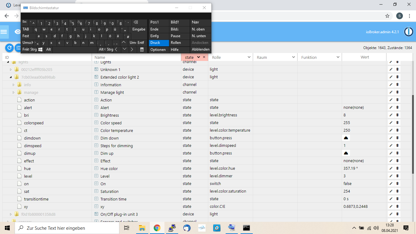

      @steff123 Zeig bitte die Objektstruktur (OSRAM) und die RAW-Experten Einstellungen von hue und saturation.
      S 1 Antwort Letzte Antwort

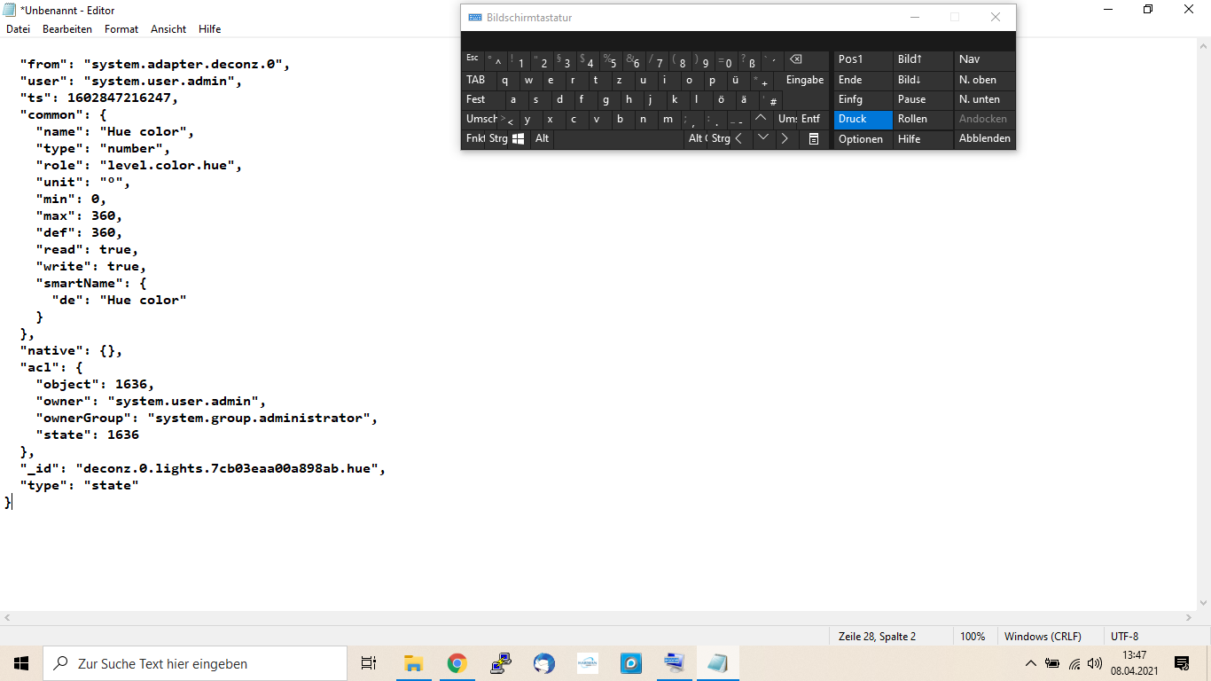

        Steff123
        • S Steff123
          MCU
          @steff123 RAW-Experten-Daten: z.B.:
          Stift anklicken
            "common": {
              "name": "Lampe Tisch - Hue of the light between 0° and 360°",
              "role": "level.color.hue",
              "type": "number",
              "write": true,
              "min": 0,
              "max": 360,
              "unit": "°"
            "type": "state",
            "native": {},
            "from": "system.adapter.hue-extended.0",
            "user": "system.user.admin",
            "ts": 1592775218856,
            "_id": "hue-extended.0.lights.001-lampe_tisch.action.hue",
            "acl": {
              "object": 1636,
              "state": 1636,
              "owner": "system.user.admin",
