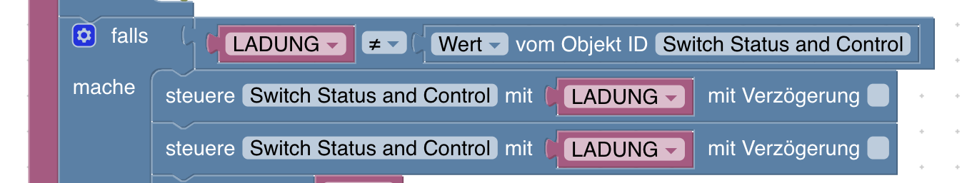

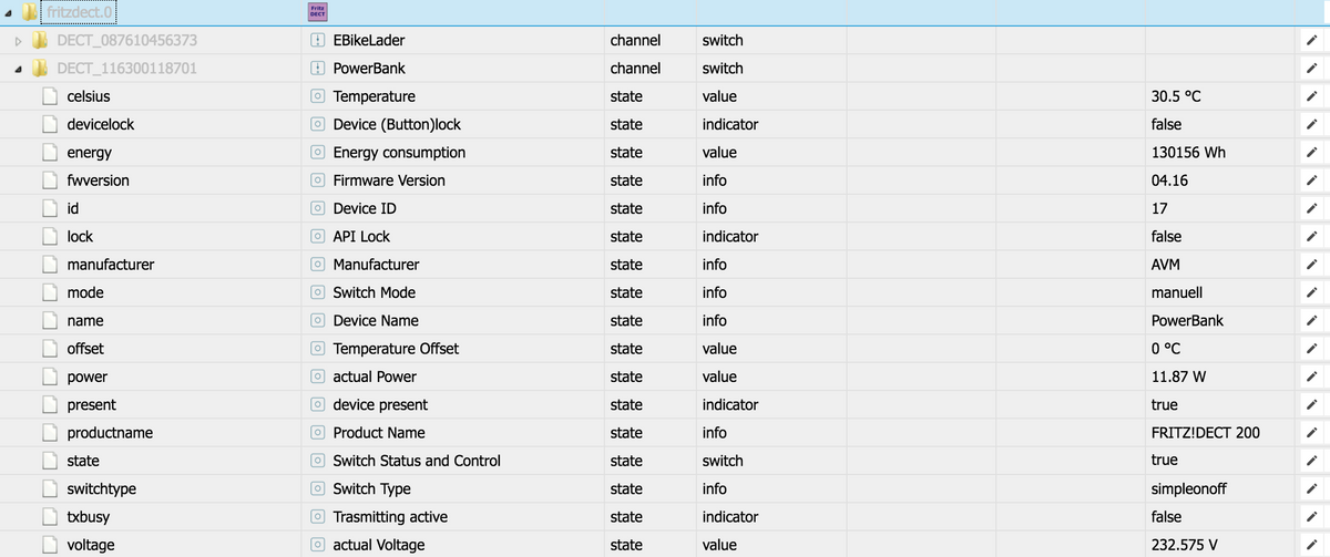

    Hallo 👍
    hab ein Script und verwende den Schaltkontakt von einem Dect Gerät.
    beim Start von ioBroker bekomme ich diese Meldung
    2021-03-31 08:07:49.357 - warn: javascript.0 (24546) You are assigning a undefined to the state "fritzdect.0.DECT_116300118701.state" which expects a boolean. Please fix your code to use a boolean or change the state type to undefined. This warning might become an error in future versions.
    2021-03-31 08:07:49.374 - warn: javascript.0 (24546) at setState (/opt/iobroker/node_modules/iobroker.javascript/lib/sandbox.js:1422:20)
    2021-03-31 08:07:49.375 - warn: javascript.0 (24546) at Object. (script.js.common.Powerbank:23:5)
    2021-03-31 08:07:49.375 - warn: javascript.0 (24546) at Object.callback (/opt/iobroker/node_modules/iobroker.javascript/lib/sandbox.js:1070:38)
    2021-03-31 08:07:49.376 - warn: javascript.0 (24546) at Object.stateChange (/opt/iobroker/node_modules/iobroker.javascript/main.js:487:29)
    2021-03-31 08:07:49.376 - warn: javascript.0 (24546) at Immediate._onImmediate (/opt/iobroker/node_modules/iobroker.js-controller/lib/adapter.js:5555:41)
    2021-03-31 08:07:49.377 - warn: javascript.0 (24546) at processImmediate (internal/timers.js:461:21)
    2021-03-31 08:07:49.377 - warn: javascript.0 (24546) You are assigning a undefined to the state "fritzdect.0.DECT_087610456373.state" which expects a boolean. Please fix your code to use a boolean or change the state type to undefined. This warning might become an error in future versions.
    2021-03-31 08:07:49.379 - warn: javascript.0 (24546) at setState (/opt/iobroker/node_modules/iobroker.javascript/lib/sandbox.js:1422:20)
    2021-03-31 08:07:49.379 - warn: javascript.0 (24546) at Object. (script.js.common.Powerbank:24:5)
    2021-03-31 08:07:49.380 - warn: javascript.0 (24546) at Object.callback (/opt/iobroker/node_modules/iobroker.javascript/lib/sandbox.js:1070:38)
    2021-03-31 08:07:49.380 - warn: javascript.0 (24546) at Object.stateChange (/opt/iobroker/node_modules/iobroker.javascript/main.js:487:29)
    2021-03-31 08:07:49.380 - warn: javascript.0 (24546) at Immediate._onImmediate (/opt/iobroker/node_modules/iobroker.js-controller/lib/adapter.js:5555:41)
    2021-03-31 08:07:49.381 - warn: javascript.0 (24546) at processImmediate (internal/timers.js:461:21)
    das ist ein bool - state
    muss ich noch eine Konvertierung einfügen??

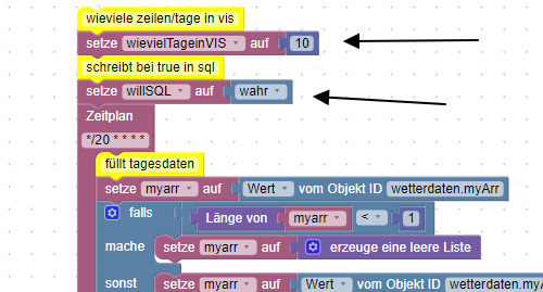

      @humidor
      der wert ladung scheint nicht definiert zu sein - beim scriptstart ?
      es geht nicht um konvertierung, sondern um undefined - du musst LADUNG "setzen" beim scriptstart - außerhalb eines triggers
      hier ein beispiel - außerhalb des schedule triggers werden die beiden variablen gesetzt

        @humidor

            @humidor
            evtl kannst du das hier (außerhalb eines triggers) einfügen - damit ist beim scriptstart der selbe wert definiert, wie ihn der adapter momentan hat - kommt auf den rest des scripte an

              @humidor

              Humidor
              @liv-in-sky ach so, verstanden, falsch gedacht
              gemacht, mal sehen, denke damit ist es gelöst, danke!
              BG
